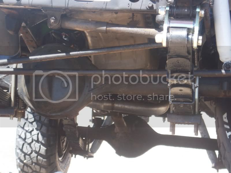

Yea I have enough clearance, i have 2+ inches after the axel is resting on the pass. side bumpstop. The engine is mount very high hence the custom turbo plumbing. All the excitement was shortly lived. Drove it all day yesterday and did a fluid level check when I got home.....radiator is full of engine oil. :mad: Going to pull the oil cooler this week and test, I really hope its nothing major.
