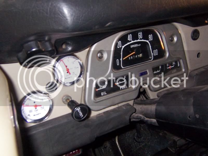

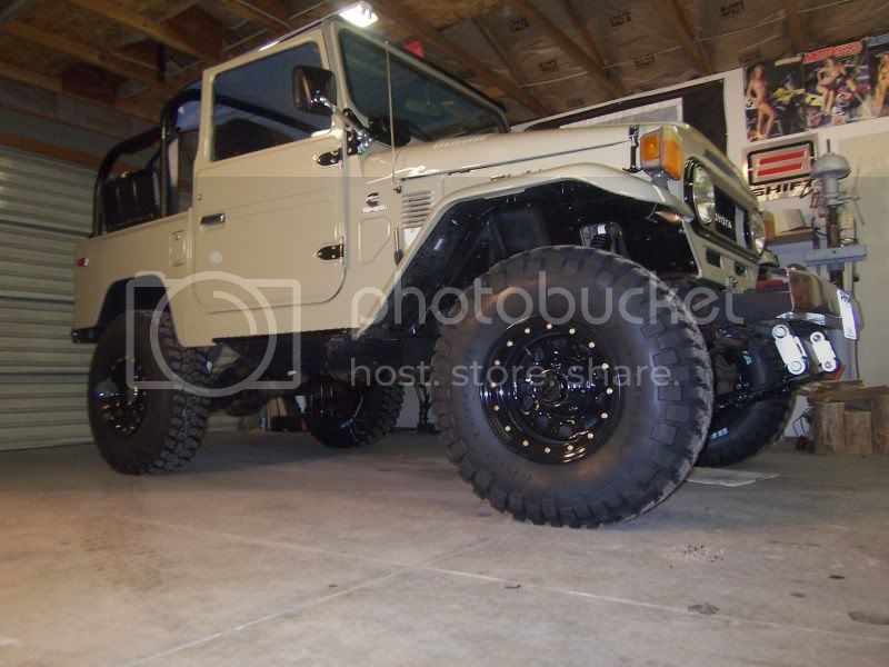

Good call on the bezel spacers, I wondered what would keep that from rubbing. It didn't have any spacers on it when I took it off but who knows what someone else did. Apparently its upside down so I need to take it off and redo some things. yes that is a chopped 6bt manifold and the oil filter has no clearance issues. Its really easy to access but I did have to get a different battery box that allowed me to move it to the driver side. The box is a Man-a-free dual battery kit minus the passenger side box. Spendy but a decent product after some plasma/welding work to the mount.

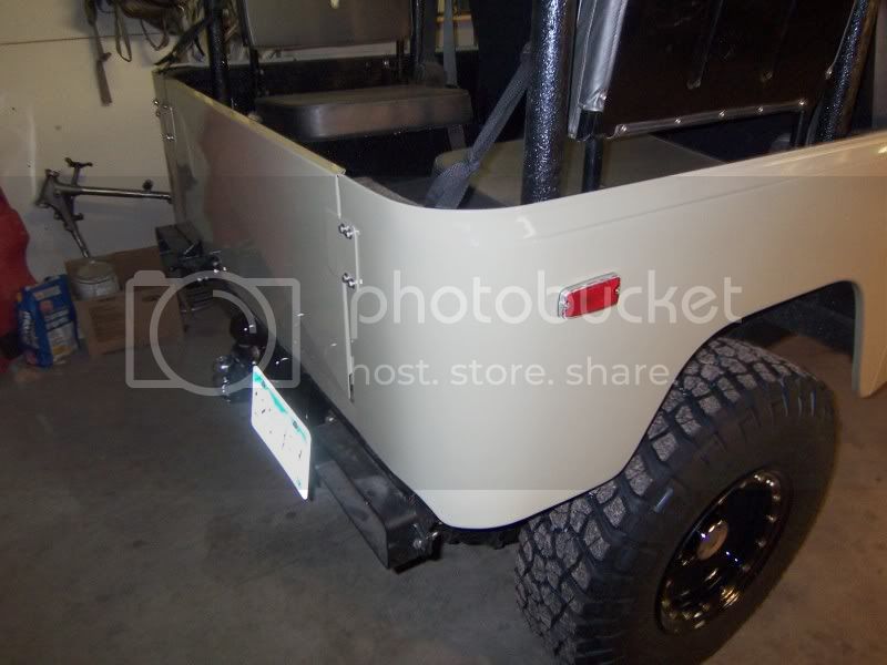

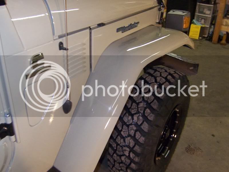

Where did you get your 1/4 and front fenders and how was the fit on them?

I thought long and hard about cutting into the dash because I was going to build and sell. No way will I ever sell it after driving it the first time. Dash... meet Mr. Holesaw! The ashtray was considered but I need 3 gauges and only 2 would fit in the tray. Bezel is flipped and spaced by the way. Top speed was 67 mph but I have some more pump tweaking to do. Fast enough for a short wheel based rig. I'm going to replace all the tie rod ends and have it aligned, the steering is a little loose but drivable. Guess I'm just a stickler!
