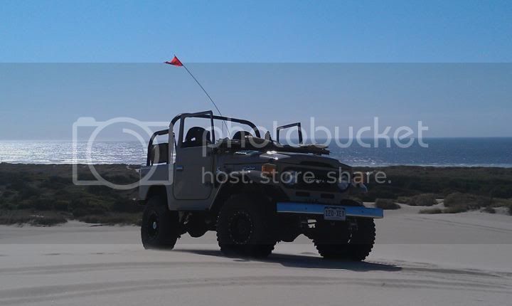

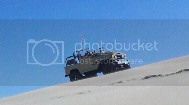

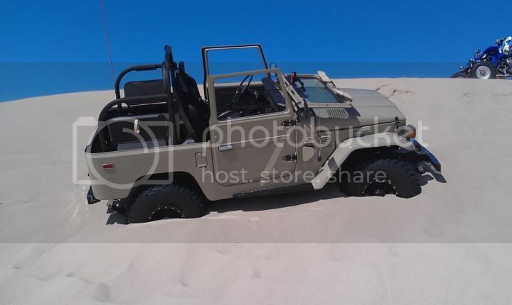

Dunes trip
Here are some new pics taken at the Oregon Dunes. The FJ did amazing, pulled stuck rigs out all weekend! I only got it stuck once but it wasn't that bad. She ran about 10 degrees warmer at around 200. Can't wait to do it again!
