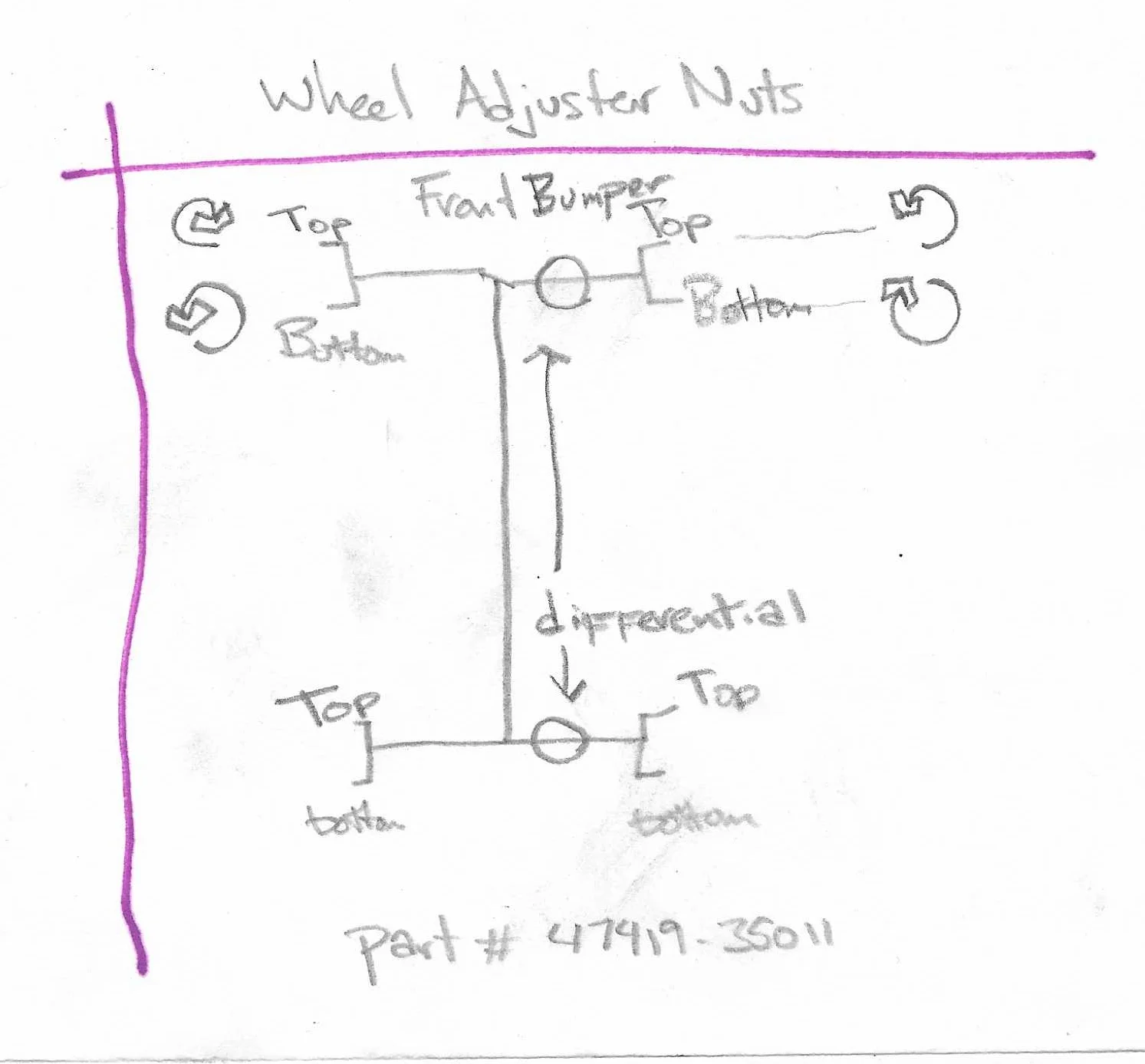

It is a big project adjusting the amount of drag on the eight shoes. But, it helps having a lift, or the wheel removed, and the drum retaining screw is on and tight. It is a bit confusing too, as looking from the top, (for tightening) the wheel cylinder either adjusts clockwise, or counterclockwise. And then you need to figure out that rotation (cantilever action, or just pushing) for using the brake spoon, or screwdriver, in between trips back into the cab for re-centering the shoes by depressing the brake pedal. Recently, I've made (partly complete) notes, so I can find the cylinder adjuster nuts behind the wheel backing plugs, and the direction necessary for tightening, incomplete info pertaining to the rear axle.
Its been 30 yrs or more since having drum brakes or looked at this adjustment procedure, but I think the manual states the end of the adjuster handle is to move away from the axle to expand the shoes. I also seem to recall proper adjustment has no drag or resistance when spinning the tire. I thought you are to adjust till the tire doesn't spin then back off the adjuster something like 3 or 5 notches, then proceed to the other shoe. It's the only way to know each shoe is adjusted evenly, because there are 2 adjuster at each drum. As bleeding goes, do what works for you. I found disc brakes work and are pretty much maintenance free.
