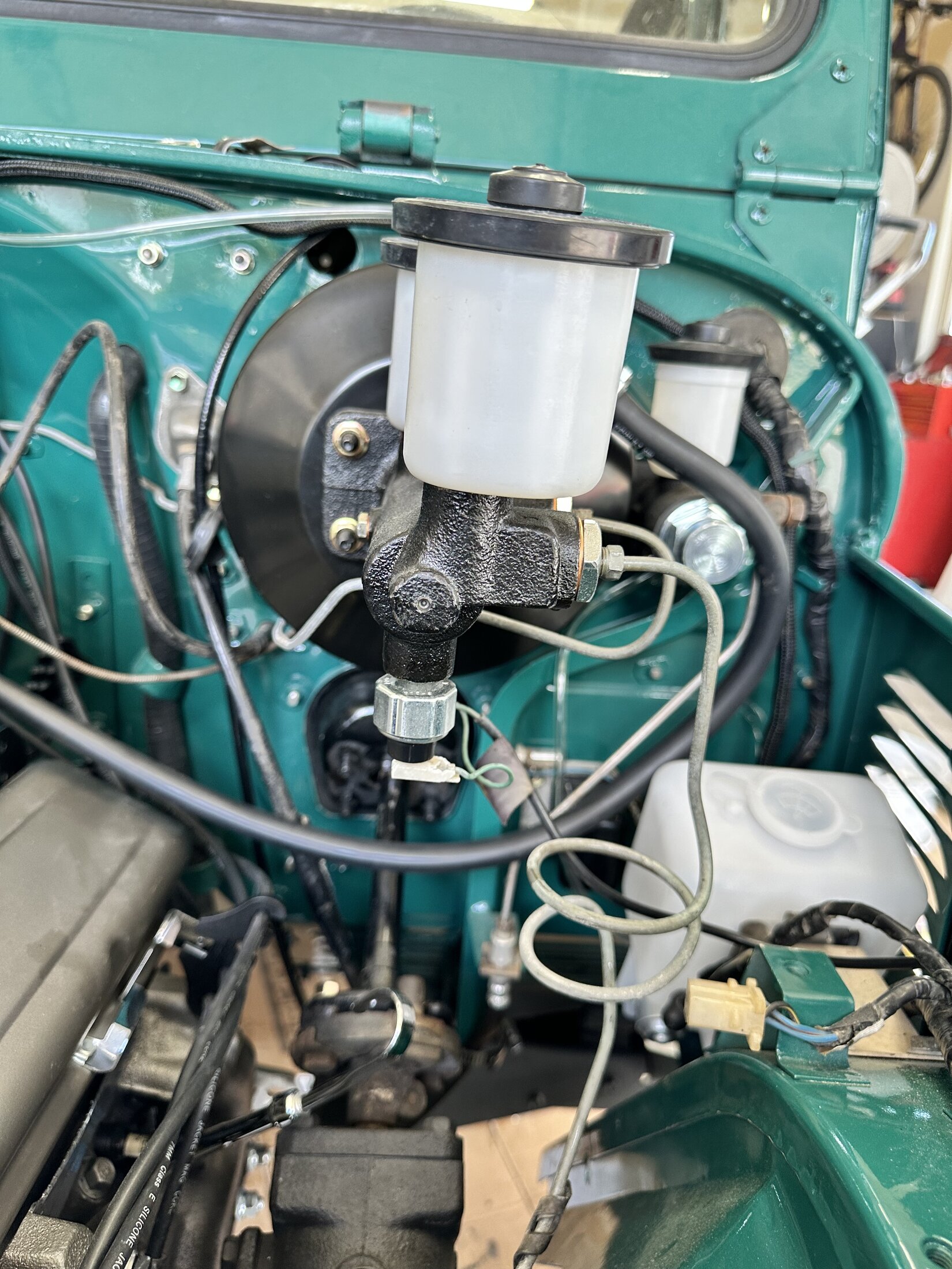

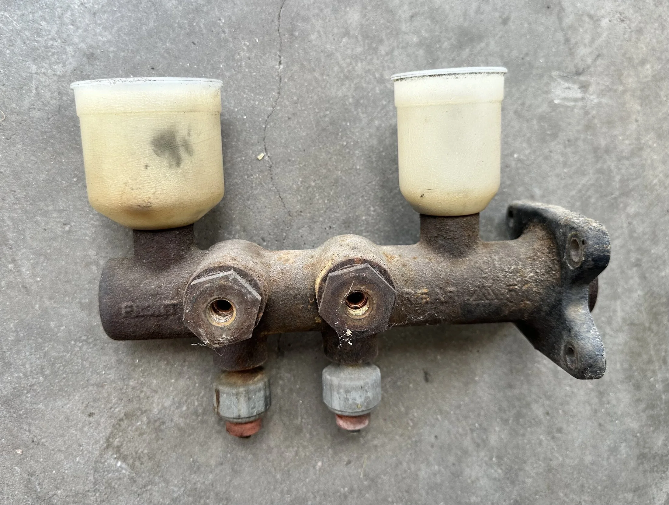

I’’m wondering if it’s the master cylinder. It’s different than what I took off. CCOT says it’s a replacement for my year.Here is what I took off, flowed by the new: Any thoughts??? Or should I say, HELP!
Along time ago they sold me that same crooked reservoir MC. I just put it on a few months back. It was still NIB and in the sealed bag. I had a hell of a time getting my brakes to work correctly, gallons of brake fluid bleed. I replace all the wheel cylinders they sold me too. Yes I will be replacing that MC too. I'll never buy brake stuff from them again. I remember the wheel cylinder issue when I ask about the parts they sent didn't match my order - Yea just put them on upside down and they will work... The fronts they sent were double acting not single like what was there. Oh and to be fair this was like 10-15 years ago.
Thanks for the reply! I was worried about CCOT! Not happy to hear about the wheel cylinders!

With the pedal going straight to the floor, that makes me think master cylinder.
Did you bench bleed the master before installing?

Did you readjust the booster to master cylinder pushrod when you installed the new master cylinder?
Did you bench bleed the master cylinder?
I was just going to ask this question as well.
I would check that first.

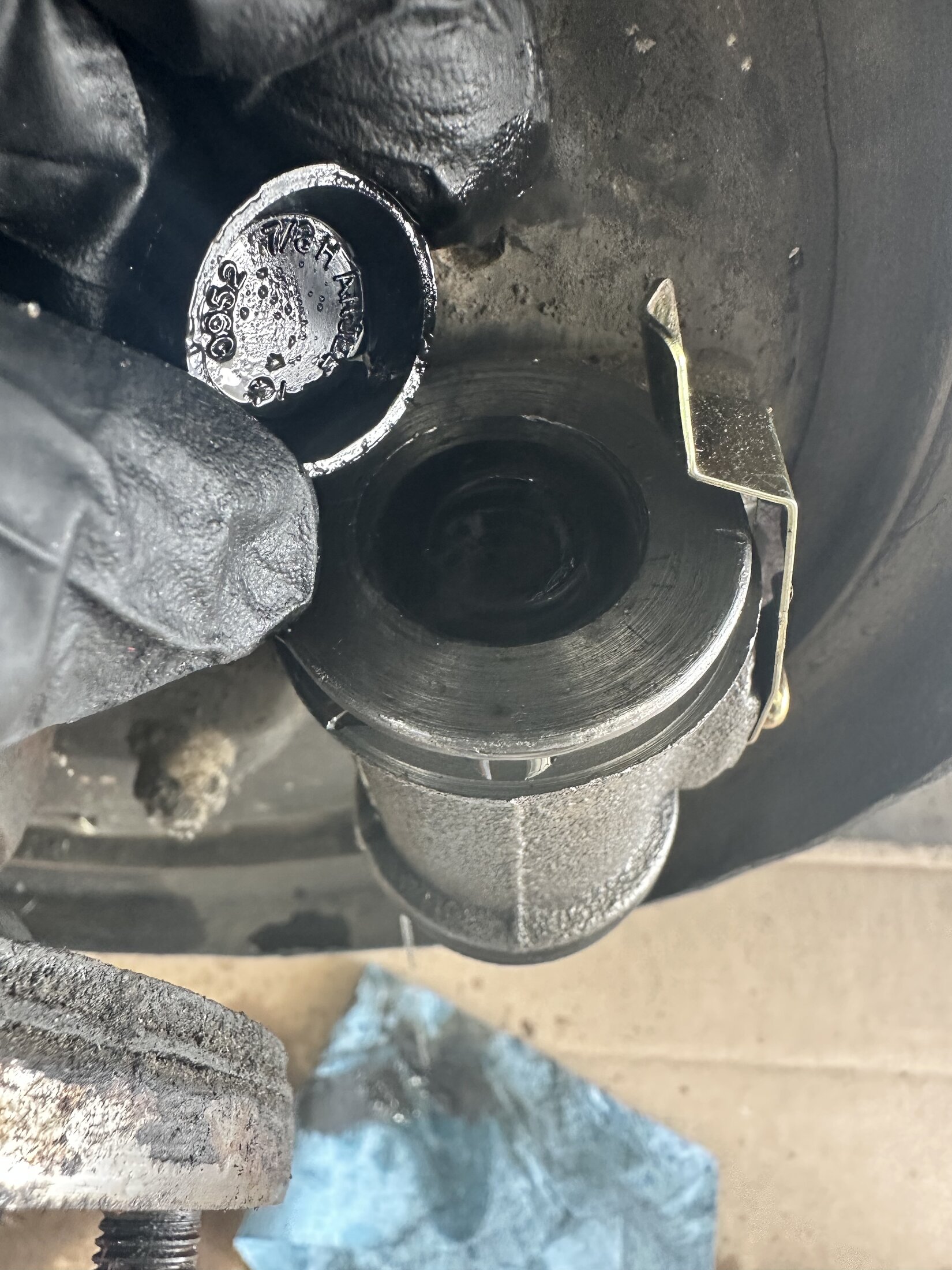

It was recommended to install the plastic cup vertically until submerge to insure no air was trapped there. No one had photos so here’s what I did and what it looks like:
Second photo is hard to see but I’m installing the cap/cup vertically.
I did this to both rear wheels and bled the brakes. What a difference! I had brakes!
