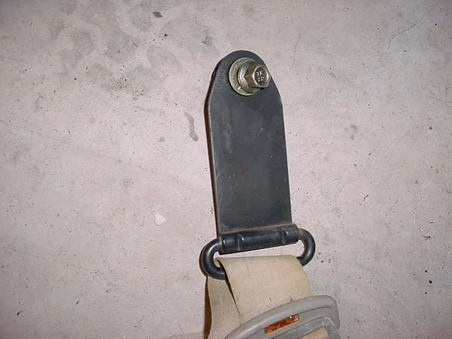

I belive I have a bit of a dilemma with the seat belts out of the 79 FJ40 I planned on using. The belt portion and retract mech I think would work fine, it's the buckle end that is the problem.
The buckle end I think is going to have to have at least 12" if not 16" of a lead on it. The 79 buckle end is about 8" long. From where it bolts to the floor to where it buckles. Because of the height of the seat and proximity to the floor this needs to be longer. Another cruiser seat belt assembly? Aftermarket?

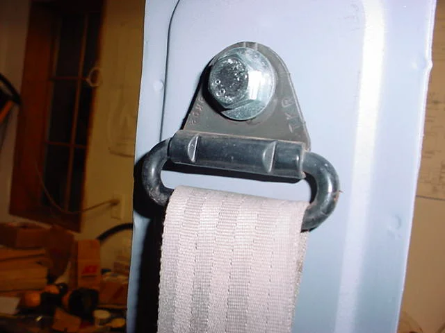

The retractor will probably go through the floor, right next to and at the bottom of the B pillar. I have my upper fastening point in the B pillar that I put in about 20 pages ago.
I guess I am not comfortable fastening the buckle portion of the seat belt to the seat frame I made. The seat frame is only as good as what it is fastened to and that is some tin spot welded to the floor.
I would like to carry it to the floor, go through the floor and have a large plate underneath the floor pan about 6" x 3" spot welded in. Essentially a large 1/4" rectangular washer that would have to pull the entire floor out in the event of an impact. The retractor mech would get the same thing over by the B pillar, but through the floor.

Yes, that is the part. And yes, I need a different height or length of the fixed attachment point, has to be longer.
Thought somone might know off the top of there head if there was a longer one and what model. Some of these guys are pretty familar with other makes and models of Toyota product and aftermarket stuff :)

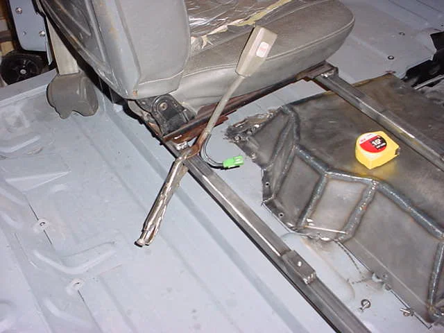

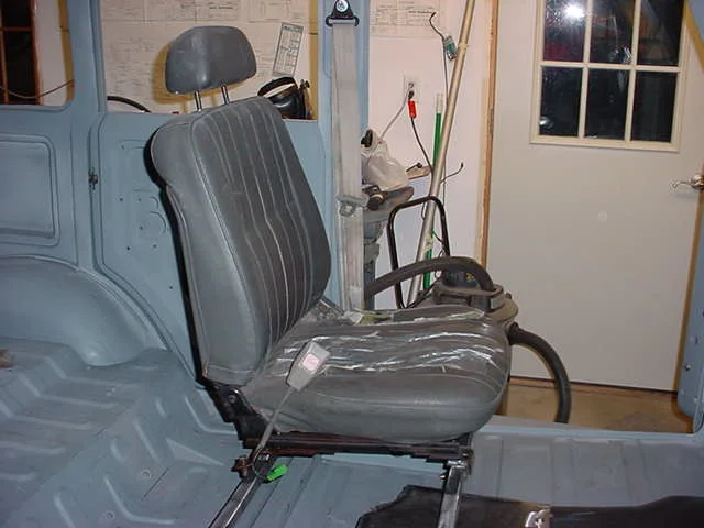

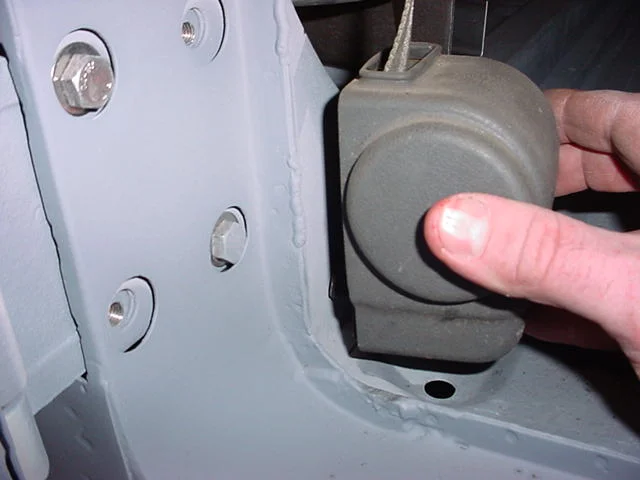

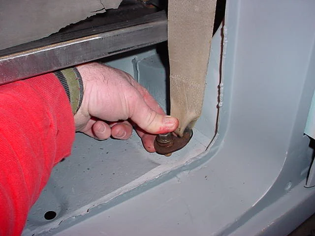

Not a ton done on the lv tonight. I thought I would monkey with those seat belts since we are on the subject.
I'm thinking of using Zeebra's idea and make another bracket from the rear of the frame I made to the floor. Possible 2 brackets, 1 behind each seat or I may just go with one in the center. Not sure yet, but that frame I made is pretty stout. Kinda vice gripped in the buckle portion to the seat frame where that would probably go, kinda a no brainer there. Fasten the belt to the upper B pillar, no brainer there. Then the rewind mech and the the other attatchment point? I kinda played around with it a bit and this is what I'm thinking.
You can see in the pics my thumb holding the attachment point directly on the floor. I'm thinking of doing what I initially thought here. Basicly making a 3/16" or 1/4" plate approx. 4" x 6" (or roughly in there), possibly bend it to form with the floor ribs and spot weld it to the floor underneath. Then drill and tap the plate, even may weld a nut on the back side.
On the rear I'm thinking of making a heavy L type bracket out of 3/16" that would be right against that Triangle piece that is welded to the B pillar. Then it would possibly form to the inside floor rib, or I would weld in sheet metal in that rib area like I did with the tranny hump. And bolt through the floor to a plate underneath also. I would drill a hole in that triangle piece welded to the B pillar behind the L bracket I made so that the bracket could sit directly against that triangle piece and the hole would allow the bolt to travel into that hollow area when threaded into the L bracket I made.
Clear as mud??? I thought so :)

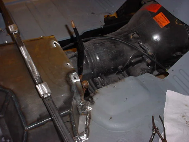

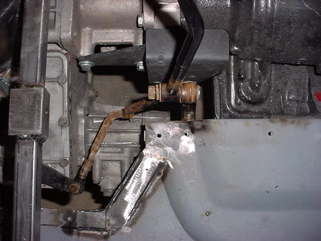

Also played around with the 4 wheel drive T case lever. Couple problems. It kinda ends up being in the area of the tranny hump that makes the hardest 90 degree bend. It would be hard to fit a ring an boot in that area. Although that's not the biggest problem.
2nd problem is that when I put the seat in, when it's all the way forward it would hit the stick.......so.............Does anyone make a kit that can move the stick forward even more??? That would solve both problems.
Matt
