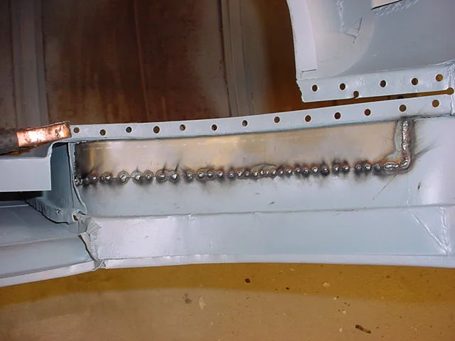

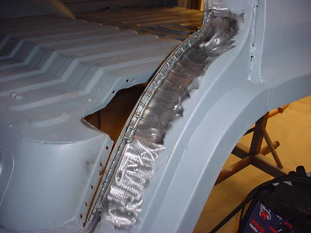

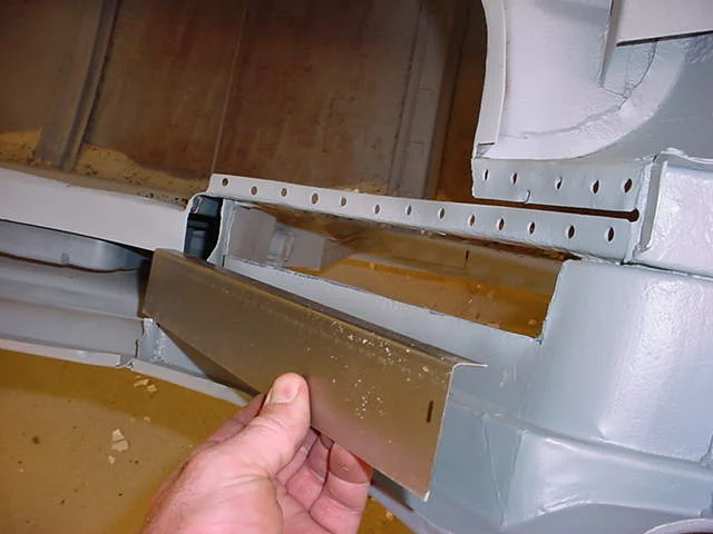

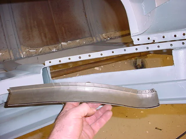

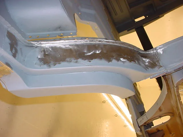

Figured I better do something on the LV this weekend. Finished up that curved door sill piece I had fabed up last weekend. Still had to do quite a bit of fitting, but got in pretty nice. All welded in and ground down. It still might need a film of spot putty on the inner door sill, to get out some of the deeper sand scratches, but I am very happy with the way it turned out.

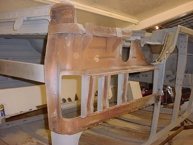

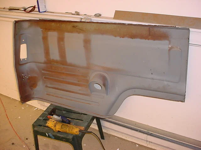

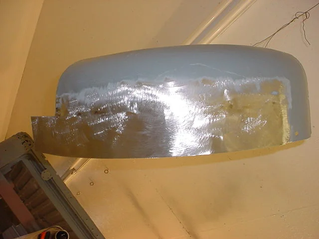

I also removed the quarter panel that had been replaced at one time with a factory panel. Wasn't to hard to take off because whoever replaced it years ago didn't re-spot weld anything to the inner panel. I only had to cut out there crude welds, which wasn't much, and off it went. This way I will be able to straighten out that inner panel on that side, it is really Fawked up!

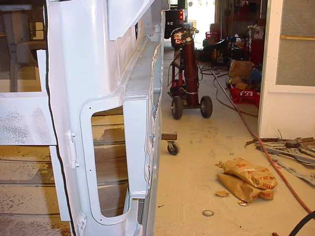

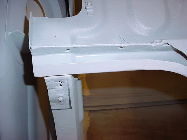

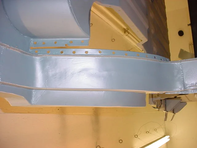

Blasted in the back side of the inner skin and epoxy primed everything. About 6 hours of work on it today. If I can this week I might try to get that entire rear sill off, it's all bent to hell and needs to be replaced.
The other panel will not be coming off, only the lower section will be cut off and replaced.

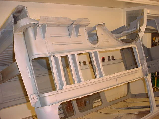

Nice pics of the inner workings of the rear section. Nice to see how it was put together. Buck... are you going to cut off the roof... I think I read that you were??? but cant find that post.
Yes, I am going to take off the roof. There are a few hundred spot welds around the inside of the upper lip. I will have to drill out all those spot welds and the roof should come right off.
I am going to wait until the body is back on the chassis before I pull it though. I think removing the roof on the rotisserri might be a bad idea in terms of structure. The body could flex or bend. When it's back on the chassis I will remove it, blast and repair the damage, which is quite extensive.
