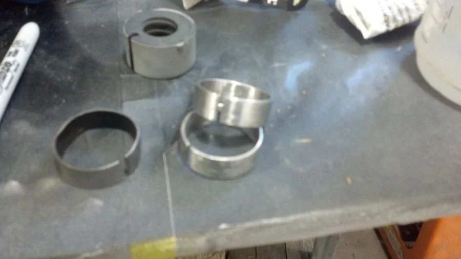

I have had these NOS brass bushing for ever. I knew they were for the engine but never could figure out exactly for what. Well, I figured it out, they are for the starter!

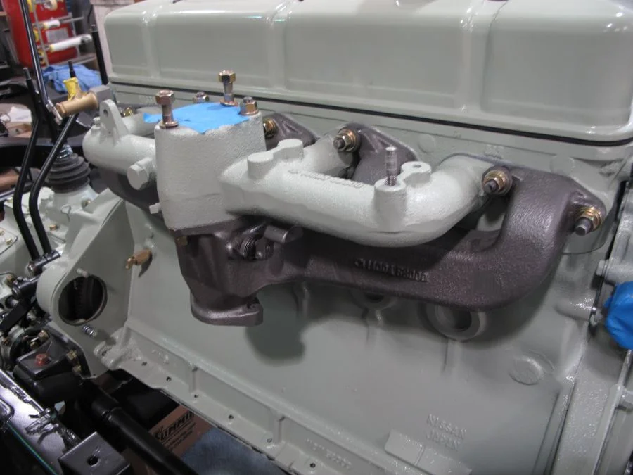

So I wanted to try out the photo uploading thingy. Not that I will use it much as I prefer to host pics else where but it seems like pretty handy and nice feature.

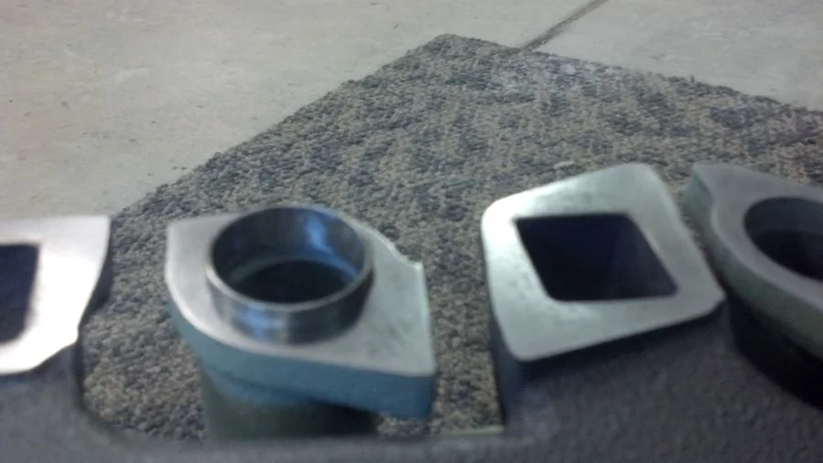

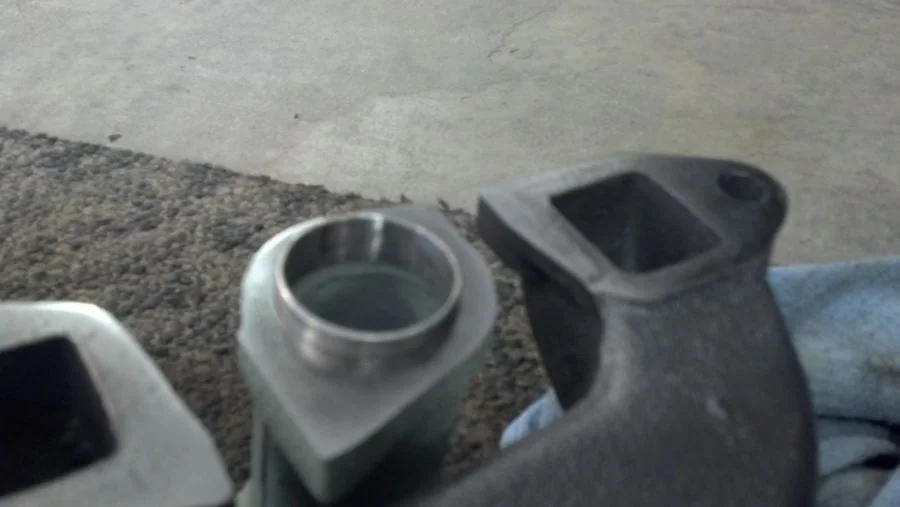

So there is an alignment sleeve for two of the intake ports on the manifold. All I had was a sample that is trashed from the machine shop. So I made two new ones from stainless steel.
I took my time and made these using calipers so they were a perfect fit.
These sleeves had been holding me up on mounting the manifold permanently to the head. With them done I went ahead and mounted the manifolds to the head.
