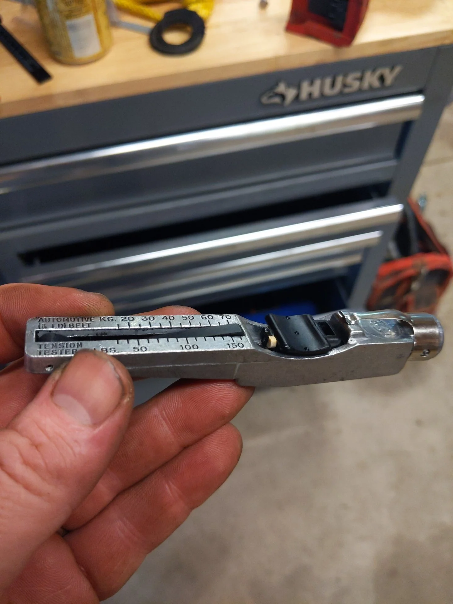

Had to dig to find an actual tension number. Really was just curious how close my thumb got it.
Not very close apparently.
Toyota want 125lbs , I was nowhere near that... barely 50 when I ran out of adjustment. That'd do it.
Probably the reason the old one was chirping a bit when cold was because I couldn't get it tight enough.
That’s a cool tool. I’ve always been concerned that I overtighten fan belts. I’ve been
told it’s very hard to do that but isn’t a measurement of deflection also a means of
correct tension?

Haha, I've never used it before either. Not even sure where it came from. I sure as hell didn't buy it.. :lol:
I always just made them tight enough to stop flapping, but then found this thing and it got me curious. Felt the need to calibrate my thumb.
correct tension?
Yeah that's pretty much how this thing works. Can borrow it sometime if you want to calibrate your thumb :lol:

I was surprised how tight 125lbs was. Maybe because there's 3 sheaves involved. Less belt to sheave interaction when the 360 is divided by 3.

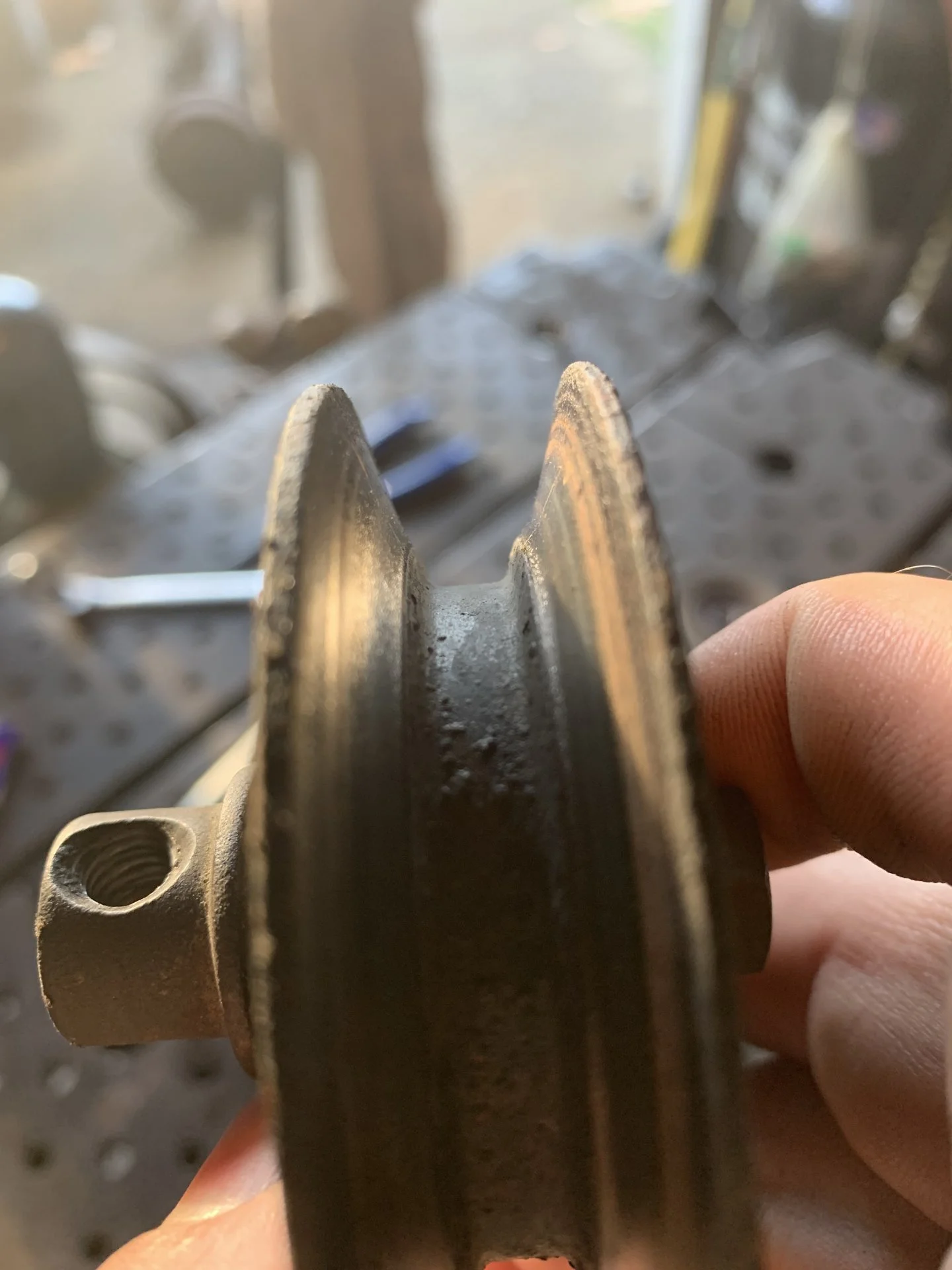

Since we like talking about belts so much. There’s a old automotive trick some of you probably already know to get rid of belt chirping.
After doing millions of laps pulleys get polished like a mirror on the belt contact zone. When the belt wears smooth and compresses in the v grove they chirp together. Belt dressing is for beginners, you also can very carefully use a wire brush to rough up the belt, this will only temporarily stop the chirp. The best way to deal with it is to use a fine sandpaper and dress the polished pulleys contact surface where the v belt rides so it’s no longer smooth like a mirror.

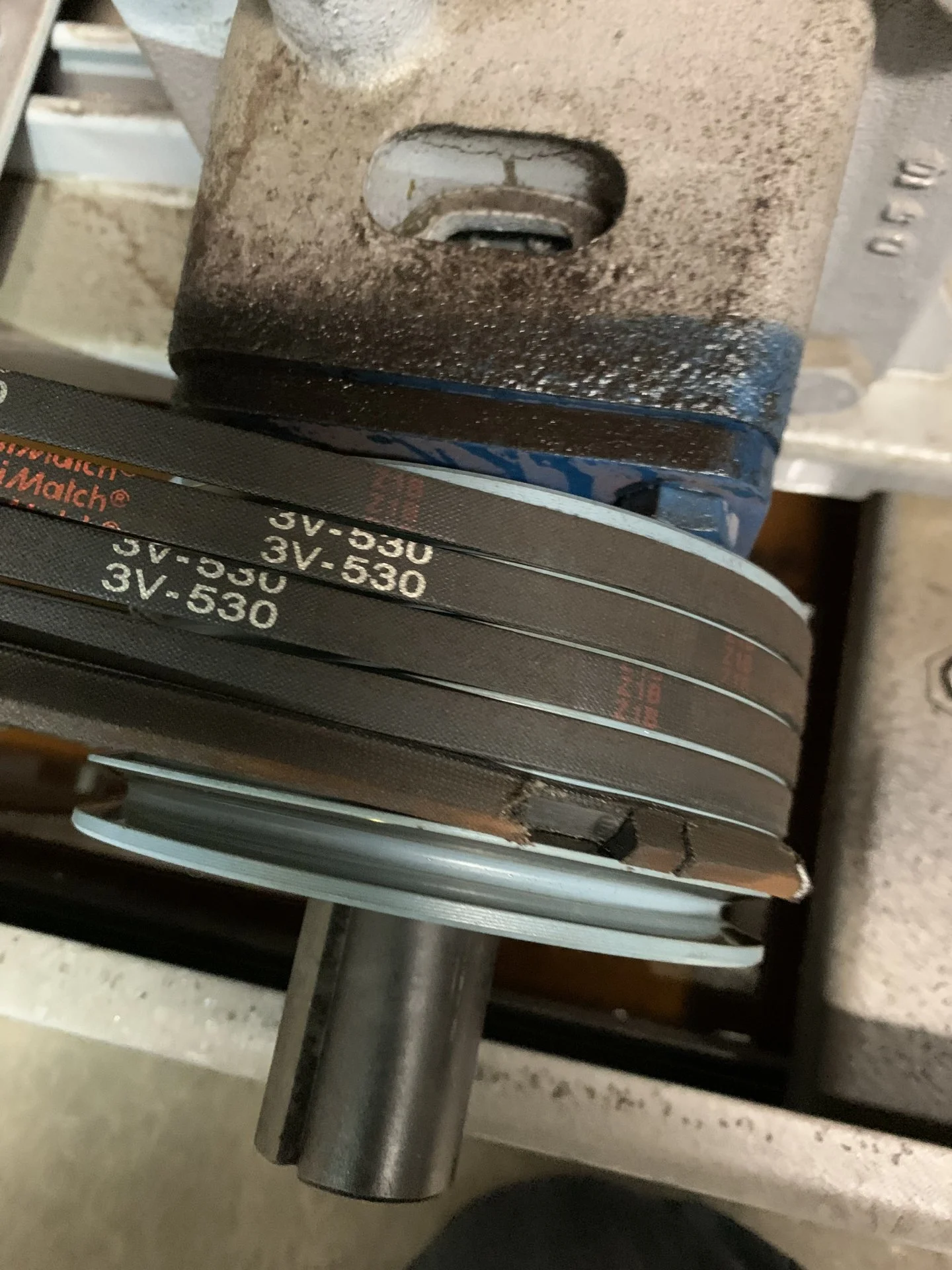

At my work a lot of the sheaves are original 1964 equipment and have been running 24/7 ever since. You can feel the grooves in them with your finger.
The belts stick slightly in the grooves so they get pulled in past where they should loose contact. Makes them flap like crazy, especially when the two sheaves are 4 feet apart like the bigger ex fans.
Looong ass belts. But as I said, 2 pulleys so each sees 180 degrees of contact (or thereabouts) so lots of grip.
