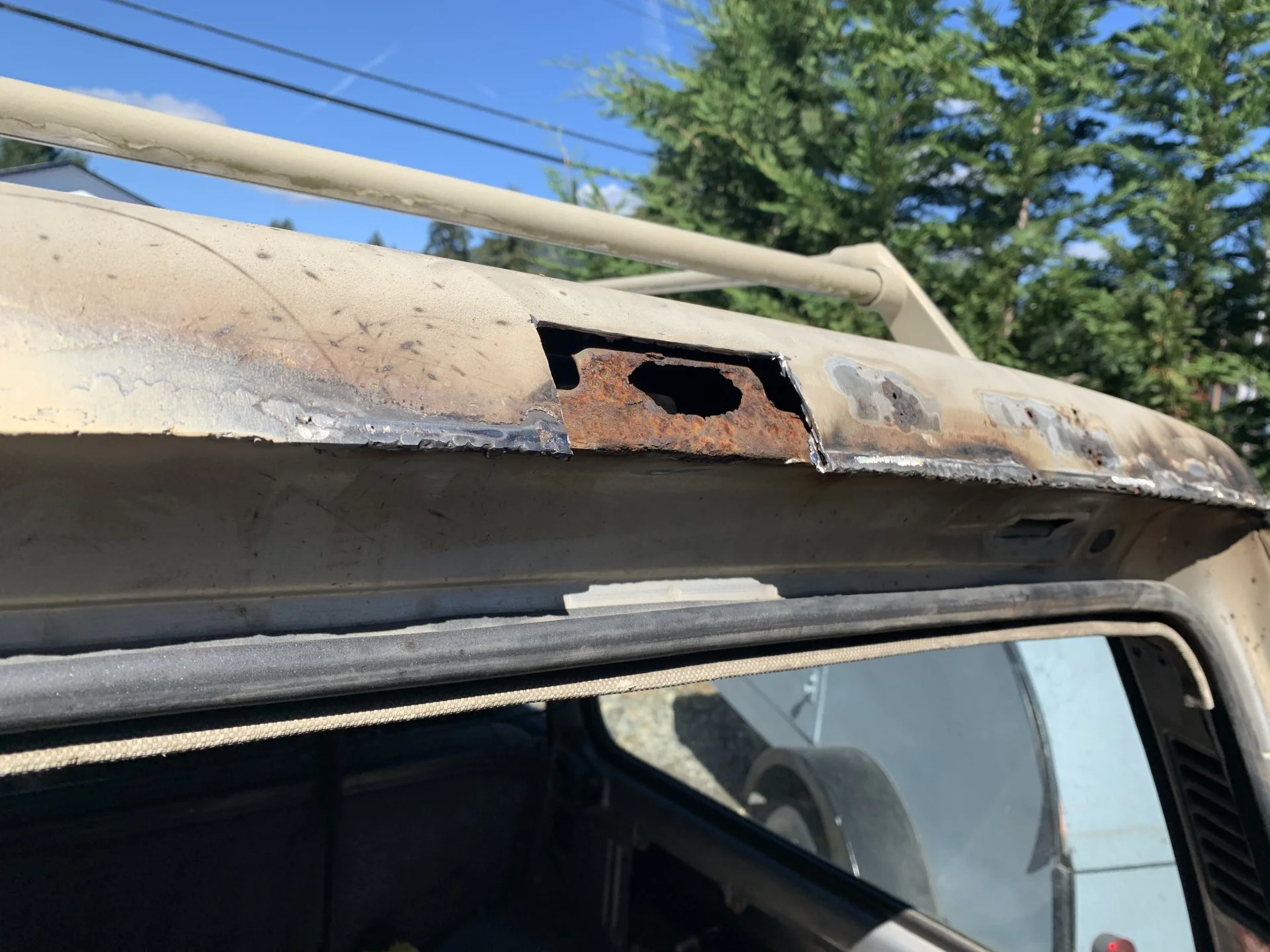

Gonna be sad to see them go, but just too many rust bubbles under them.
I still haven't even decided on color or even paint at this point. Or whether to just do a patch up and put it off another winter.
I hate painting :meh:
You’re not alone… unfortunately it seems to be an inevitable part of owning old Landcruisers… unless you’re Jay Leno or such

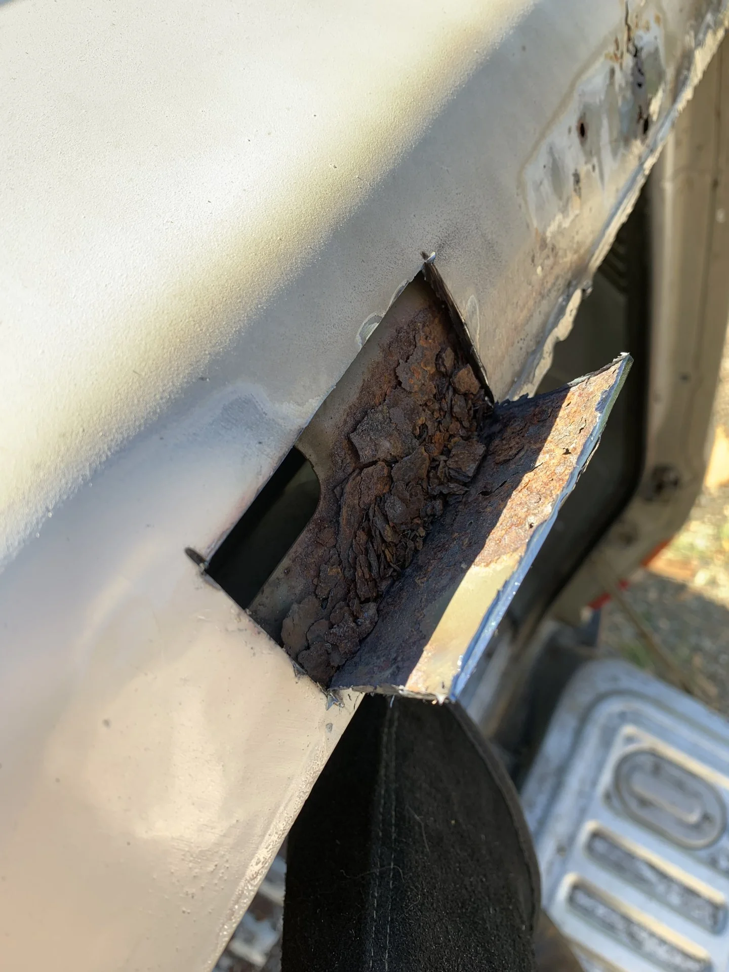

What lurks behind a rust bubble…
