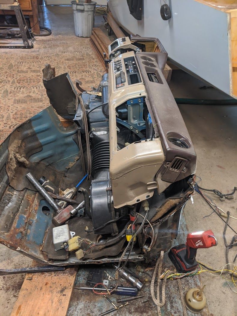

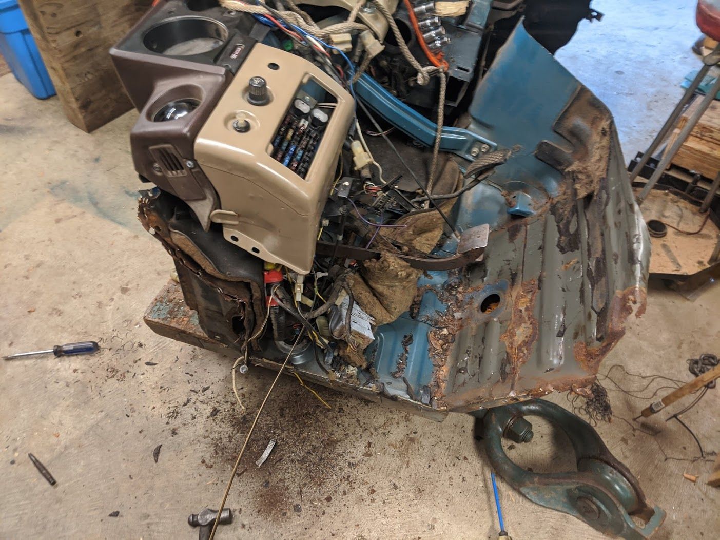

So yesterday, I dug the blue 60's firewall out, and had a go with a spot weld cutter. I went for the Blair branded one. Supposedly better? Who knows.
The moment the first cutter noticeably lost a bit of it's edge was when it actually had to cut weld and not just the tin around it because the center punch wasn't all that centered.
Removing the one in the truck should be easier, because I'll be able to properly lean into the cutter. With a loose firewall I had to do it one handed for the most part and hang onto the tin with the other hand. Blair kit came with 3 cutters and I'm still on the first one, so I don't think it'll be an issue. Didn't even have to use a zip cut at any point yet.
Had one side off in about 1.5 hours, did the other side this morning in a bit less time.
Worst part is that curved bit that extends down from the corners of the windshield where you have to drill through double thickness.
Still wasn't that big a deal, went pretty quickly.

These are the ones you need to drill out. It's double thickness so you have to go through two layers. I had a bitch of a time with that horizontal bit not wanting to release on the blue one, so ****it I just blew threw all 3 layers. :meh:
dg6EHiimtsxfwR1AAS2yq7MmiF78sxIBBD-Z5tO9Rpj0dR7xGc7sk2UDZjbfWdtF1xB8xhoSlNjyOCoKIjU4figBHH9dxlwf9_TvrAHXkhpaBE_aeEQwWWJUNtaJnSwH7h71_alrW_3XvmGLPVXiaNRh5d-TZ75r9phojGE8QexQ0rtwRq2BOsPpXaIIBoBV6qX_gseQj5DaVdtcBv6Qnx3yGKFblklxwMjzhN_JHjN0nToMMZU70e5uuajGwrSHd9NWWhOpE__t-wYMb27KoBeX_O-UuIax_MAxVAreaV8egpYovNFcL9t3TBlIB6Eo7SkorWpaOqCZYgHciNwQStOLTgUyHwMEOno-G0i-65BbqyLAYuq1s2voHtouaGvtbw6JxDsbB3asipv77KLKxOIXYgmWdqcPOiLpVMVrbV-RUPSDQLW5u5DZ9aoivwswI_4wGGKle71nKs8pE1VeUFt0l4fn1AxyJhGY1I4J0S6BxCTvwPgeYHEwi22H89VnTpoQORkRL1cySrj-kVC1zcyusMvA4hZaSLuxP2Wc7mf5ZC7eqWKLUQA1vA6mvBtf7JPuA5U8ZKBrIVGpbjXaTgo56yLlLQDkpdJvQ33H3GJOPOIpT9XgE0zLG9vKDhP4TSwkYgOB-sTADr8ybqMPWbwX3PMEYhOGnkn5s5zEgIcoiXM6O1Sd4N3ZPpR98Q=w469-h625-no
This is the awkward bit. It's brazed here. I found this little baby chisel works pretty well if it's nice and sharp to cut the sheet metal.
Not sure how I'll redo this...I don't have the technology to braze...might just weld the edge of the seam. :hmm:
It's actually loose in this pic. :grinpimp:
6xxFGEk8aYRNQCgqoEGNph9vEmfO653RUgysMxdQycK4vS6DnFGq-pKCndQWcCFv4RXAad1zJp4ixqNkVFjj_W5ZbtSiCgYb7fcPf_fhFyG6BHP5UmxP8Xwhg0s5ScOQfoXZdTQOEYYdhAEYd8UWHFgtH5alSIdJePOnvSSABclPxyn4XnQ8qI-hz0LkWW8UVbUzf2rIJTwG_N0IpK73lwdNhCl4y3mVVbvInIu-7Dy3oHa_7towXlRrRN2RTP4ZZybQlTs-lTP6PUKc6C30w-yg1UCZMnPB9go5QdxEgawAYvrKhC2wQ64Xz8T9qe734B4v51gangV0qivJUaobmZipHbuGifn-HIowb6PW57jE_YRcxI8SaUeBr250p6DNPM_ugTFtSVjvyczS8r6QGo6Of3oPXKpzhzId5pfcs2hj_DwKJd2UtrqRafVj_GIalXbj0B7-STtFA2vxPWB85BxiYCUGbPa76e9HhZ6w570gN2hC1O1DzR7ydOw_koYeCmtYQdft9sRo5Z6Ehw1G8UVuBajBix7ZOTqCADPBah3sQ4ZzvWQTnbHOJ49J2fAM73gpkTk0U9I7OEgr9sAu4haPzFsx-og9K8tUuzC6UuQpPpkTvPOyB_lloLKq13VC0RXbNGw5ENi-HGmgu9GJI8lqso0aIovLqO3I4r-MuiE1DL4r-fhiELcHYeVxQQ=w469-h625-no
Remember the middle bit is getting discarded, so bending it back like that isn't an issue in this case. What's underneath on the pillar is still pretty straight, and anyways, barely an inch of this is even visible once the fenders are back on.
Lot easier drilling spot welds when what you're drilling pushes back. Spot weld cutters are annoying things tho. The spring loaded center bit is virtually useless. A stronger spring might help, but for most of the welds I just popped a 3/16" drill through beforehand.
Didn't want to do that on that delicate spot at the windshield tho. Nice not to have the hole right through there.
