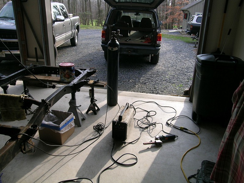

I had a guy I went to school with come over and do some welding for me on the 60 project a couple weeks ago. He's been welding since high school ,almost 25 years.
He shows up with this teensy 110 Hobart set up for TIG. I'm like wow.
He loves it because it's so portable and powerful. I had to find a 20 amp outlet, which was the washing machine in the house and run an extension cord, because it blew the 15 amp one in the garage a couple times.
I seen what can be done with experience and 110. I was thoroughly impressed.
110v welder above is inverter based is VERY DIFFERENT than your transformer based welder. It is much more efficient with electricity and WILL produce higher output than a transformer based machine.
I will not dispute your reply one bit as I have no real experience with types of 110 welding.
I just merely wanted to show some damn fine welding using 110 volts.:D
Got everything torn down today, but nothing welded. The factory frame rivets on the manual box were a pita to get out, but with enough air chisel, pry bars and hammering, they finally broke free.
LOVE my lincoln 110v. Put a downey p/s conversion in 9 years ago and is still in great shape. I'm locked with 37 baja claws. I would put the largest diameter fittings and hoses you can get for the saginaw box. It really makes a difference. Power steering is the BEST thing I have ever done to my cruiser. Good choice.
I think we'll just tear everything down, tack weld what we need and then I'll flat tow it to the fab/off-road shop 2 mi down the road. I'll let them burn it in with their professional touch.
:clap:
Great idea. If you're not 100% confident and lacking the required expertise, then tack it and have someone else zip it up. Save the DIY for something less important like bumpers or sliders. Once you have more experience and feel like you know what you can and can't do, then you can do more.
