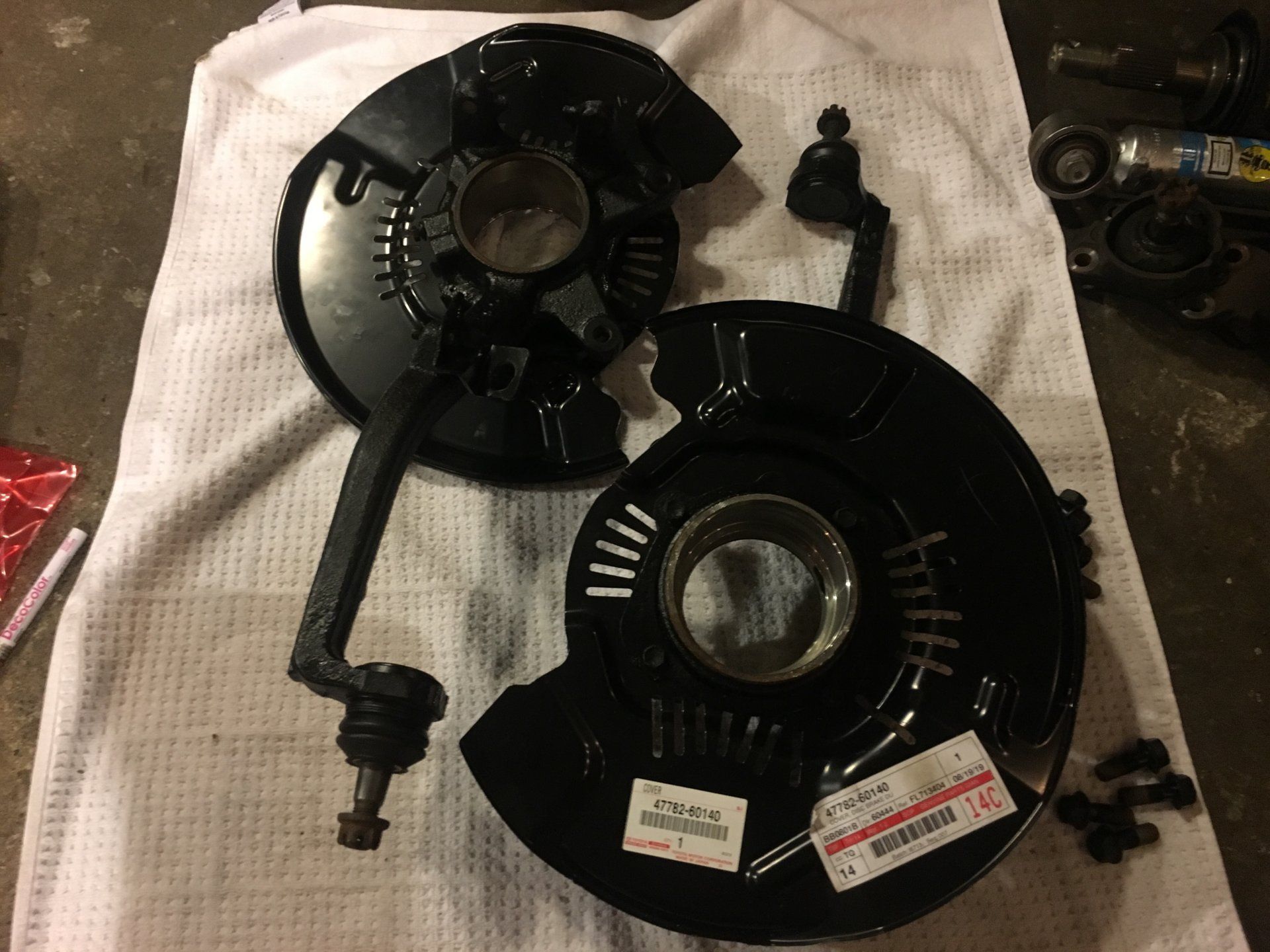

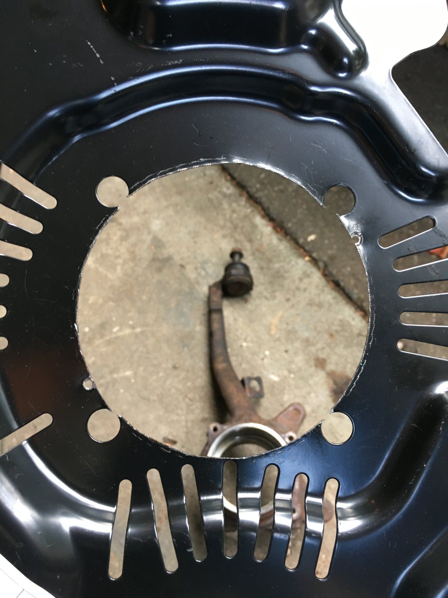

Today I mostly rested. I’m still feeling pretty haggard from my crash. I did make some time to tidy up the garage and the ugly rust on the frame, etc. Pics of that tomorrow. I also cleaned up the original reinforcement backing plate pieces and trimmed the backing plates to fit over the knuckles. Gotta pick up some calipers to proceed.
So I knocked off all of the rust scale then applied this stuff a couple times to neutralize the rust.
A little chassis black and it’s looking a lot cleaner under here now.

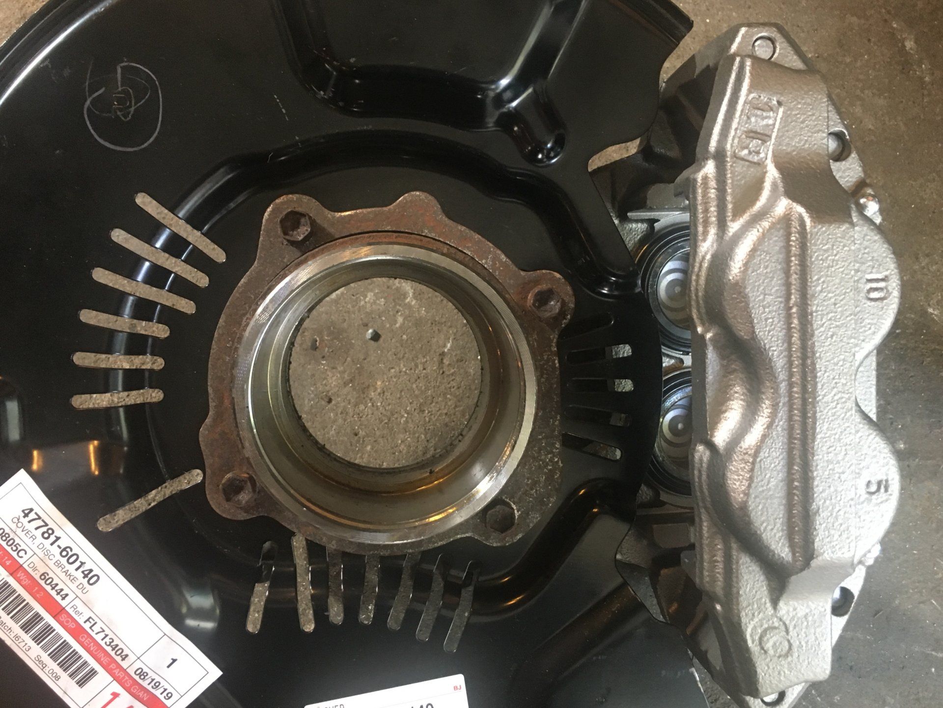

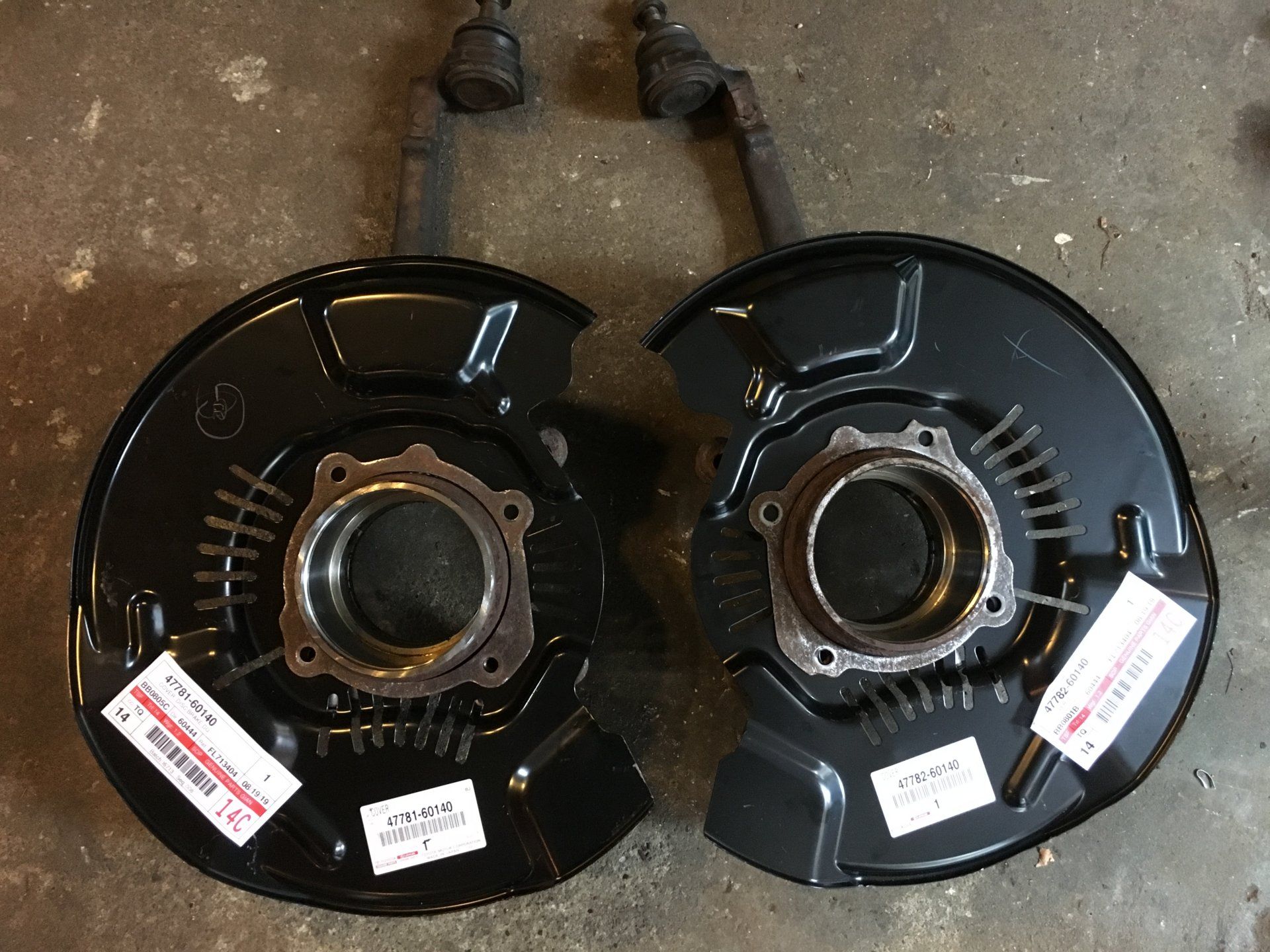

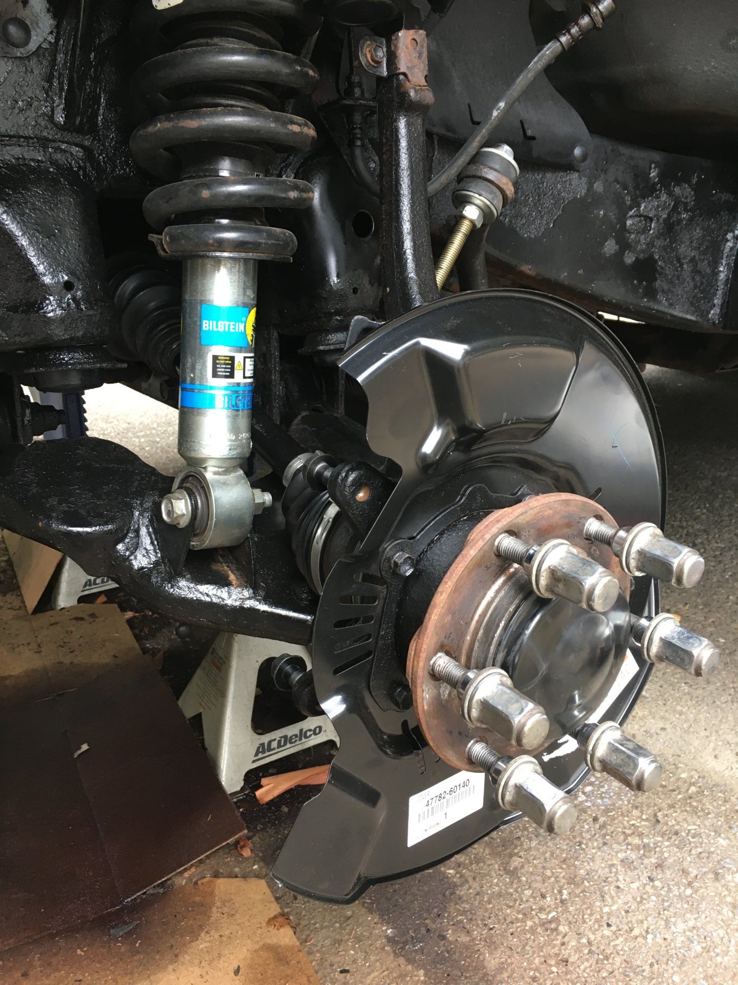

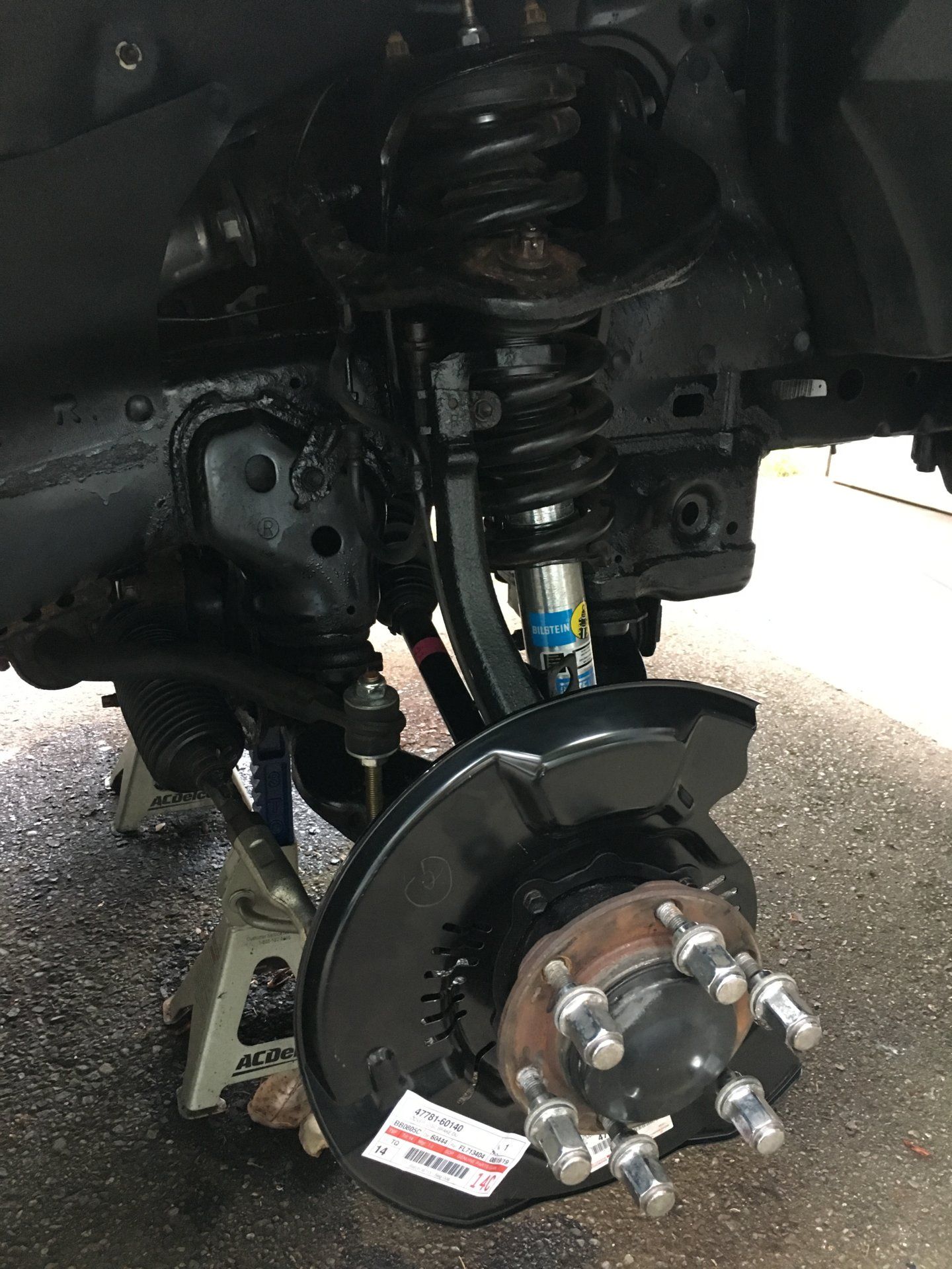

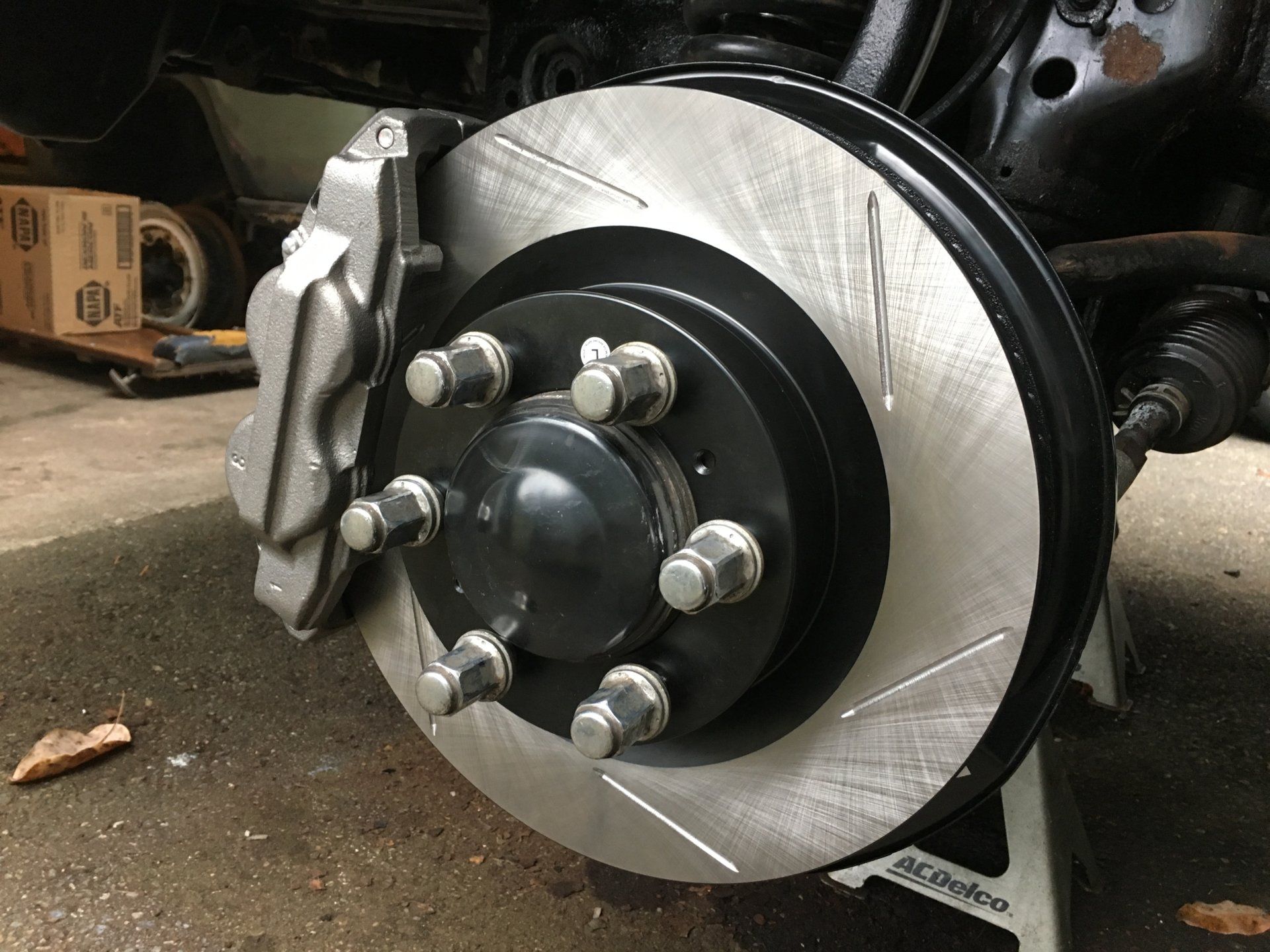

I learned about this brake upgrade as the “GX460 brake upgrade”. I knew the 5th gen T4R has the same platform but for some reason assumed that the brakes were better on the GX. They aren’t, it’s the same exact stuff. If I was smart I would have researched this sooner and bought my backing plates through Toyota instead of Lexus and that would have saved me $15-20 each, it’s the same part number. The good news is that calipers and rotors are much easier to find (and at a lower price) when you’re searching for Toyota parts vs Lexus. I’ve also found the slotted (not drilled) rotors through Stoptech.
Backing plates were an easy fight. Don’t think I’ll bother welding the reinforcement pieces, just some paint and they’ll be fine.

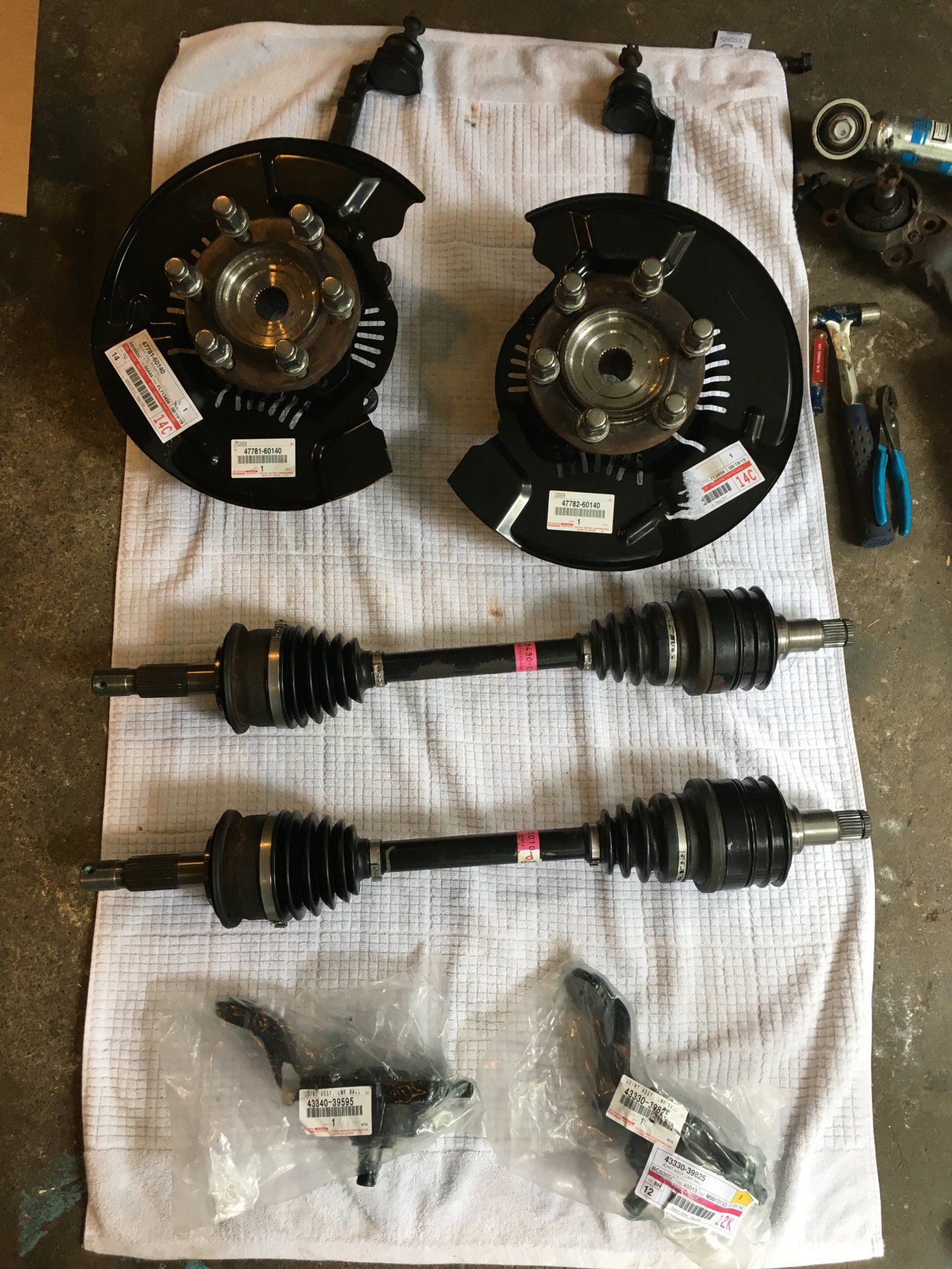

Picked my refurbished knuckles back from the machine shop yesterday with new genuine Toyota bearings, seals, etc.

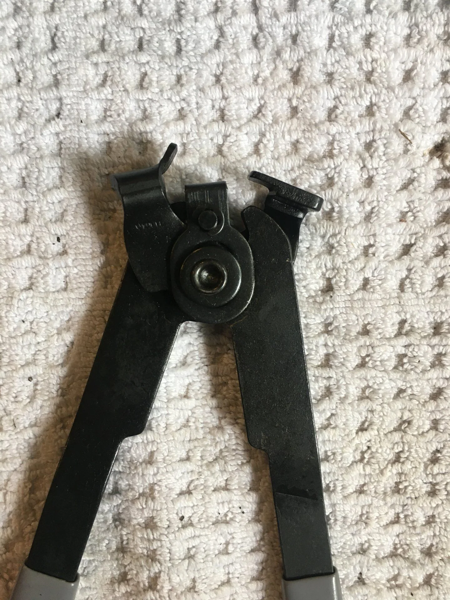

I also re-booted and greased my axles. I bought some inexpensive clamp pliers from Napa, they bent on the very first try.
I bent them back, gave it another go and that little bent piece eventually broke off. So yeah, don’t buy this garbage.
So I rang up a motorcycle tech buddy of mine, went over to his shop and I installed the clamps properly.
I just got the drivers side reassembled other than the brakes, sway bar and one cotter pin.
I should have the calipers back next week, hopefully driving by next weekend.
Buttoned up, other than cotter pins for the tie rod ends.
Just waiting to get the calipers back from the machine shop. Oh, I guess I should get some rotors on the way, too.
The Sequoia drives great, brakes are awesome. And finally, something forum worthy.

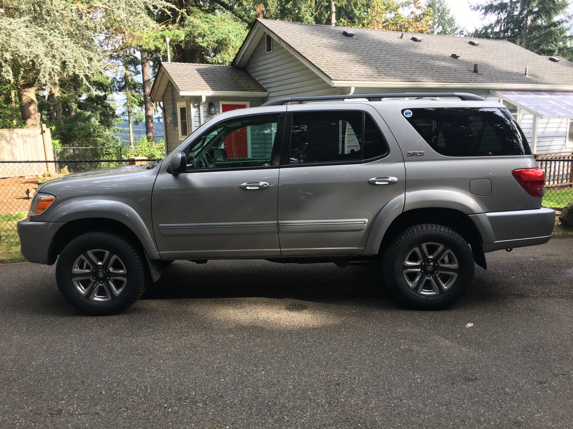

This isn’t exactly the look I was going for, and it’s a long, dull story as to how we got there, but I don’t mind it. The wheels are a little blingy for my tastes and bigger than I expected them to look. And the tires are far more tame than originally planned. But I can deal with it considering the price I got them for. And I think they work with the paint well enough.

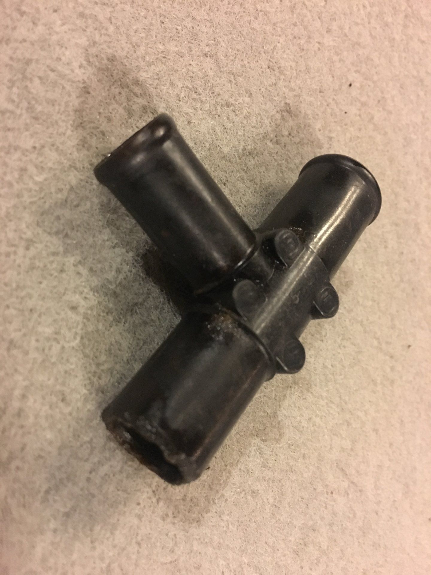

One last public service announcement, change your heater T’s!

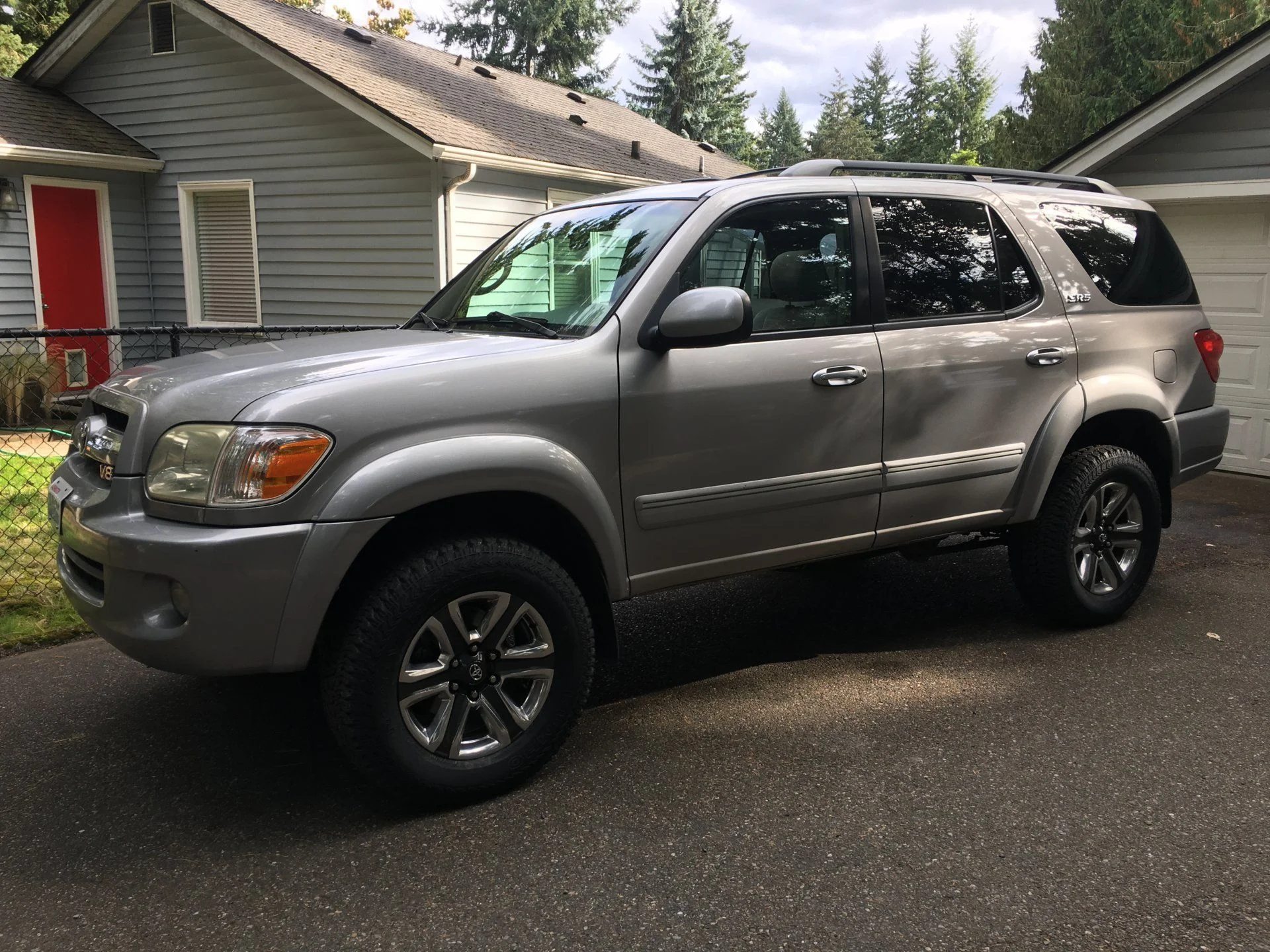

Looks great! I really like the height of yours, looks like you're still using stock UCAs? I'm planning on doing a mild lift and was on the fence about doing UCAs right away.
Never been to the salt flats but it's definitely on the bucket list.
Yup, I went super simple and basic with 5100’s on the third notch. All stock otherwise. I really like how the 32’s fit up front. It doesn’t look right with the third row in and a full tank of fuel though, a hair nose high. My buddy just gave me a pair of old rear springs from his 80 to try out, hoping for an inch or less of rear lift.
