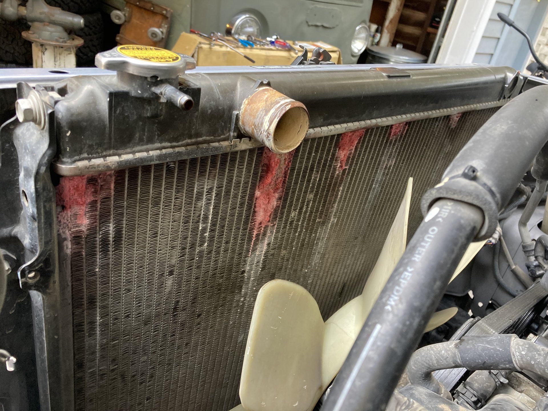

Bendix in the starter went out so we put a 2kw starter in there
While we were in there we replaced the radiator, coolant pipe, o-ring, thermostat, intake gaskets, starter and knock sensor connectors and installed 12 hole injectors.

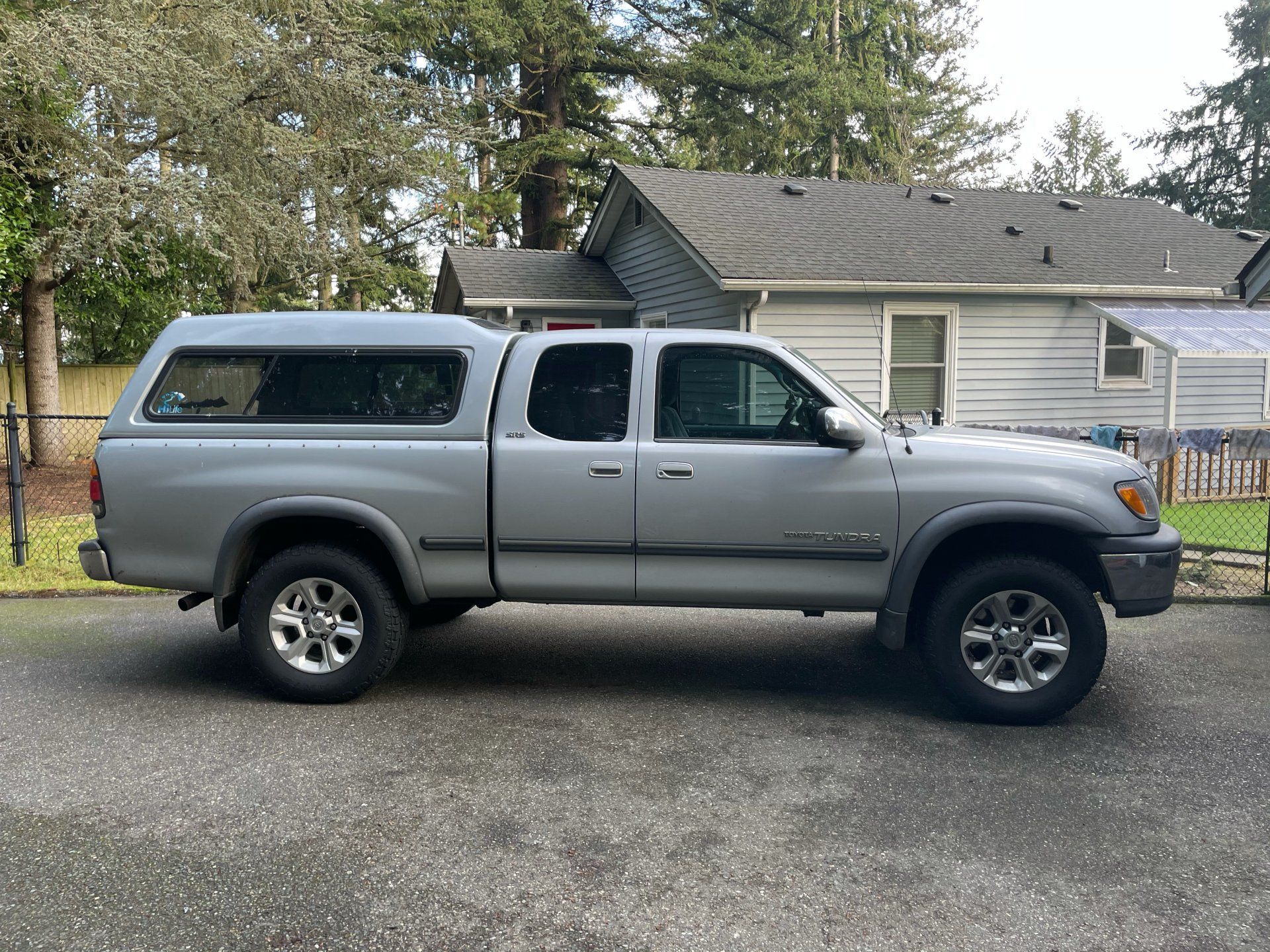

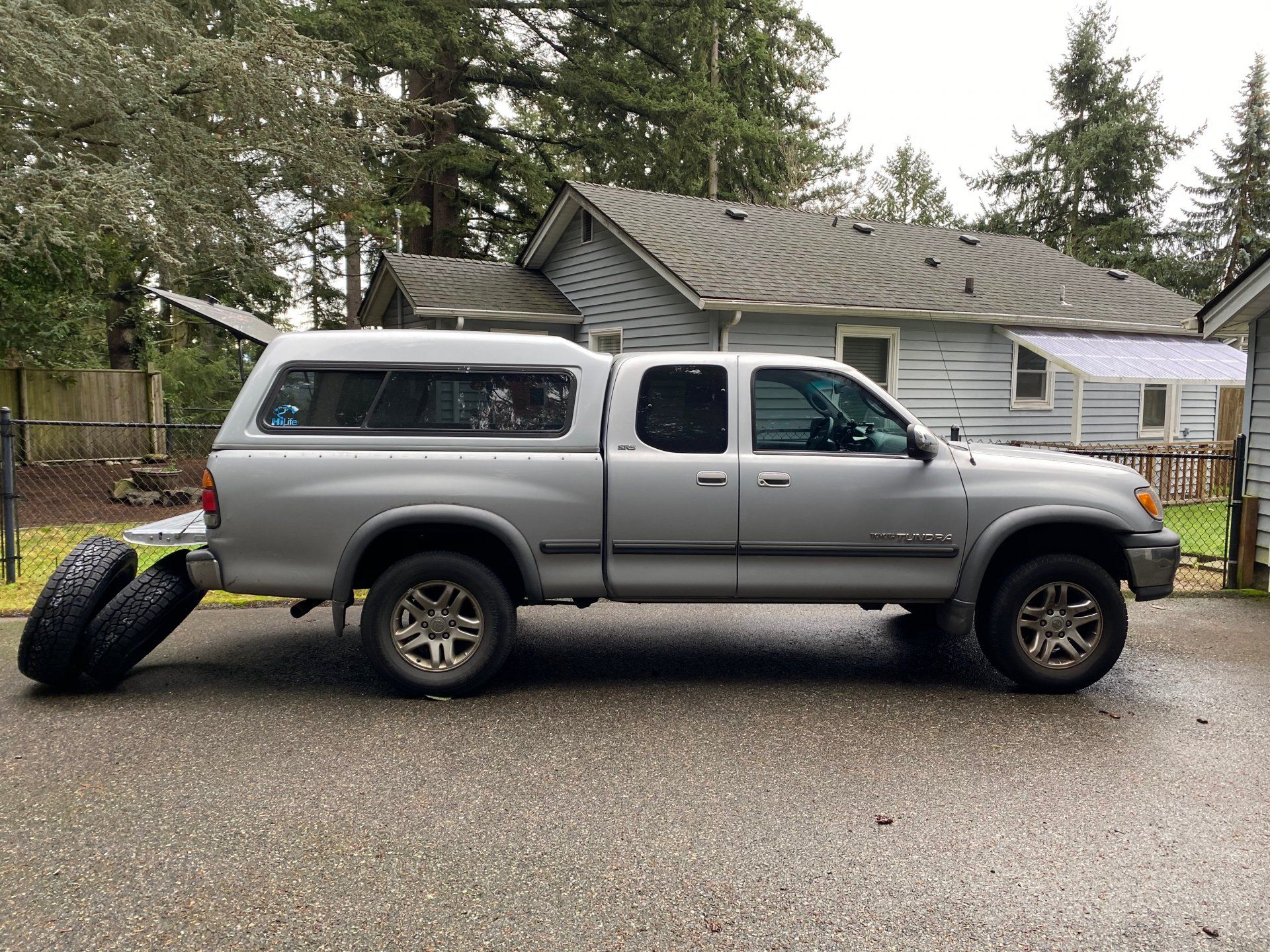

And recently picked up a set of 5th gen T4R wheels and 255/75’s (32”) A/T’s. I LOVE how it looks and the ride quality is massively improved!!
And recently picked up a set of 5th gen T4R wheels and 255/75’s (32”) A/T’s. I LOVE how it looks and the ride quality is massively improved!!View attachment 2559045View attachment 2559046
Are those the same offset as the Tundra/Sequoia wheels? BTW, those tall-skinnies are getting moment of love on the Toyota Sequoia Off Road Facebook. I'm digging the extra height without having to deal with a lift or spacers or whatever but I'm a little concerned the weight of a heavily loaded sequoia might be better off with something fatter. Any thoughts on that?
Yes, they are +15mm, same as original. The only difference dimensionally is that these wheels are 7” vs 7.5” for the original Tundra/Sequoia 17’s.
I think the tall vs skinny thing is subjective. Try it out, you may like it. Your contact patch will be loosing 10mm of width but it gains in length with taller tires. I bet the area remains similar to stock in this particular case. I can say without a doubt that steering feel is noticeably lighter/easier which I was not expecting (old front tires were standard 265/65 Michelin’s). Plenty of LC guys have used 255’s as well without ill effect and they are heavier than a Sequoia. Correct load rating is more important than width.
Right on. Thanks!
