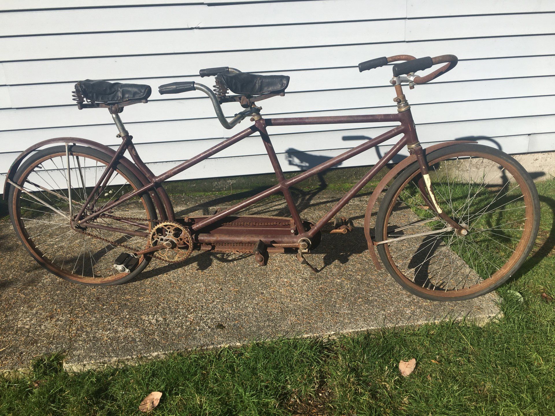

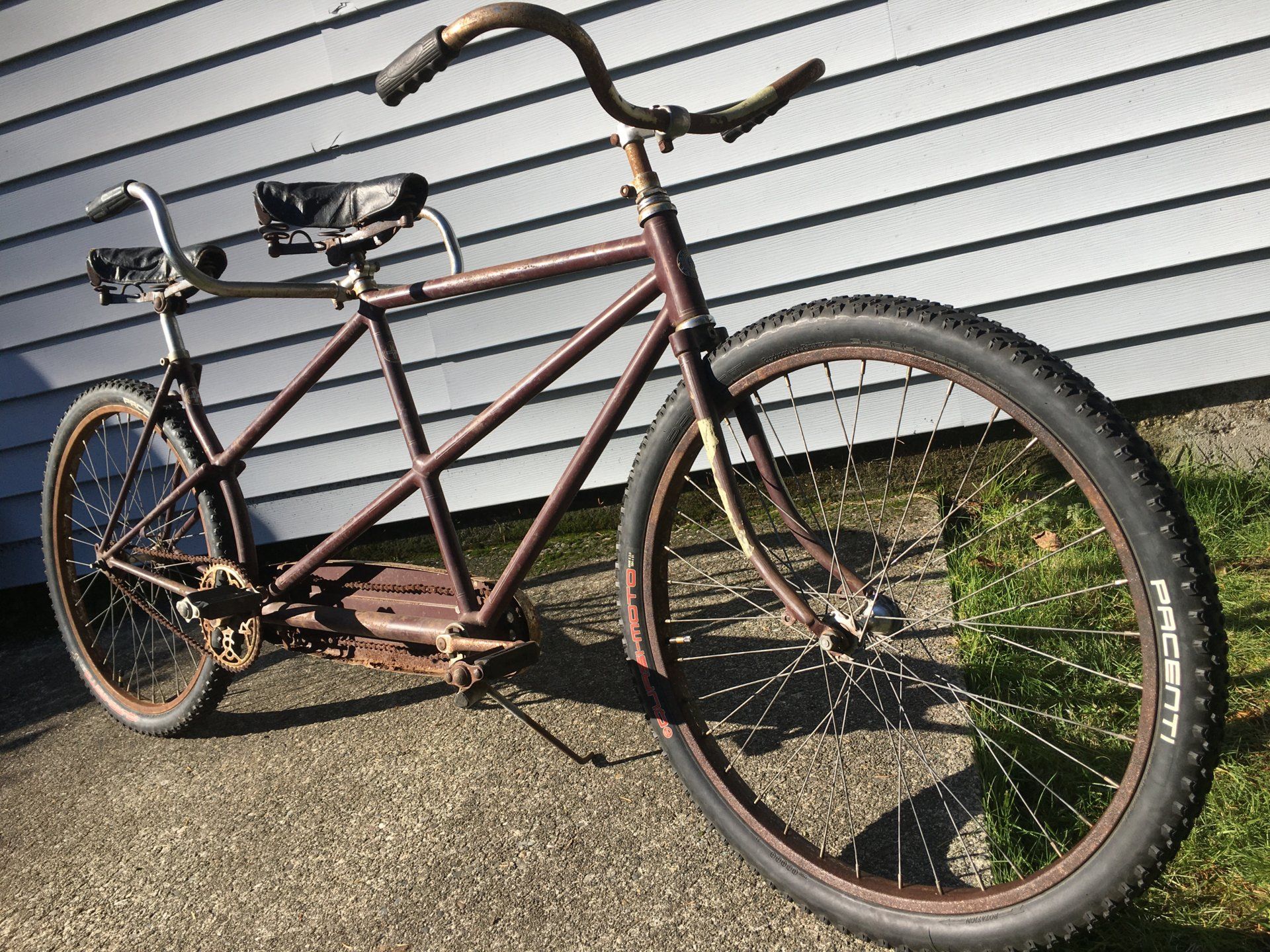

I dragged a bike back from Arizona. ‘48 Schwinn tandem.
Coincidentally it uses the same size wheel as modern mountain bikes so...
Pulled the fenders and stuck a slightly too big 27.5x2.0” tire in there (stock is 26x1.50”), I’ll have to go down to a 1.75” or so. But I’m loving how this old tank looks.
Swap a lockout fork on that thing
You mean a locking fork? I have one on my ‘40 DX, I did so to get an extra 3/4” or so of “lift”. This one is going to stay dead stock original other than the beefy tires and the saddles. Cheap fun until I probably sell it, eventually.

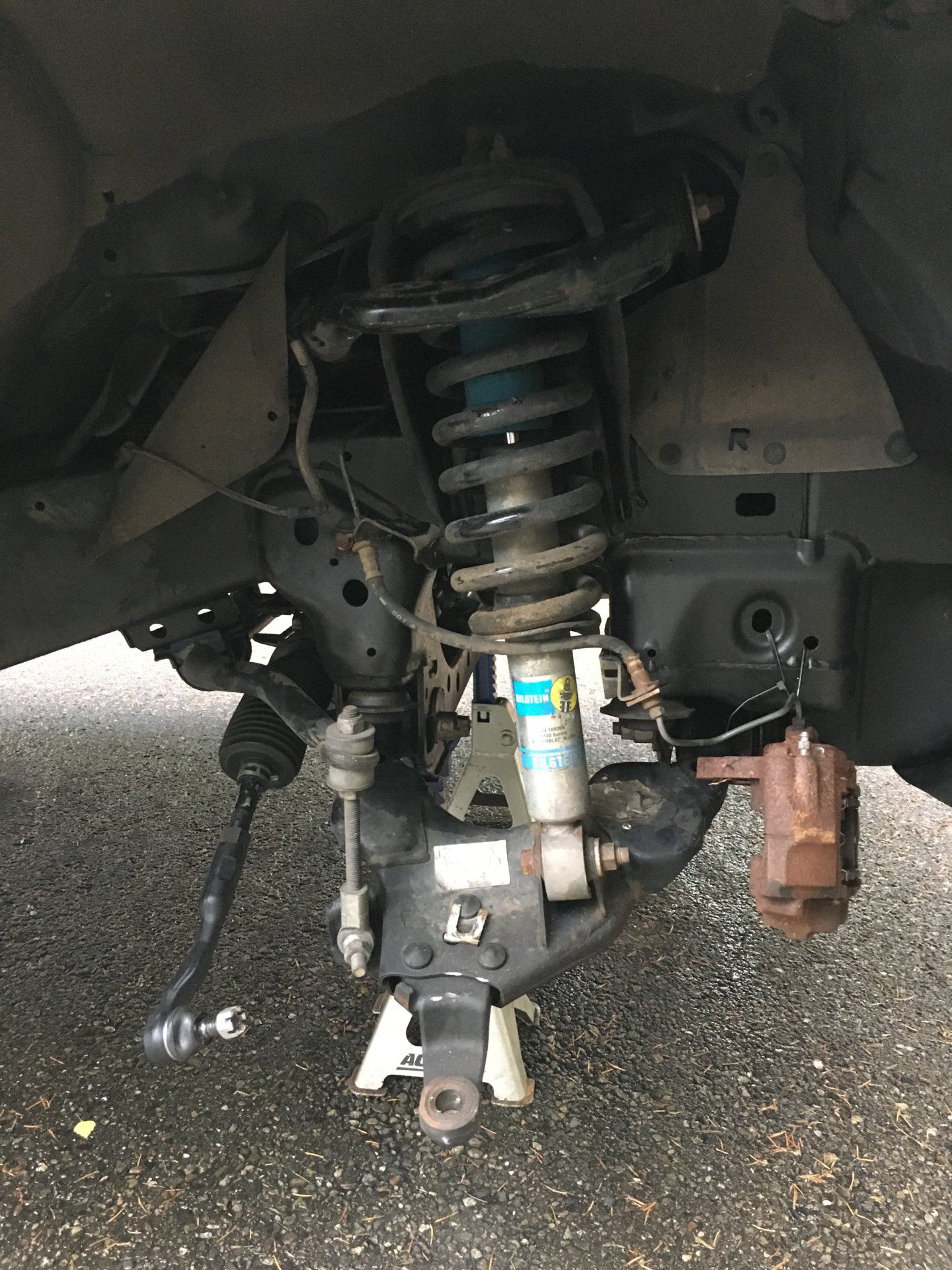

This is my fear every time my wife takes off in the Sequoia
Can "done at the dealer" be verified? Assume the po did that.
I had it done “at the dealer”. I had a friend who was a dealership tech that did a lot of work to the truck around the 200k mark. TB & WP, LCA’s & ball joints, etc. He of course used Toyota parts because he was able to a great deal on them. I reimbursed him for the parts and paid him his hourly rate, he did the work in between his other jobs at the dealer. There was no paperwork. It’s not his fault (he was a very detailed tech), for whatever reason the ball joint ran dry on grease, wore the socket out and separated. Shouldn’t have happened, just bad luck I guess.
Pulled it all apart today, ordered parts from Mc George. Doing all 4 ball joints and front flexible brake lines. The right side wasn’t leaking but it got pulled on really hard...
