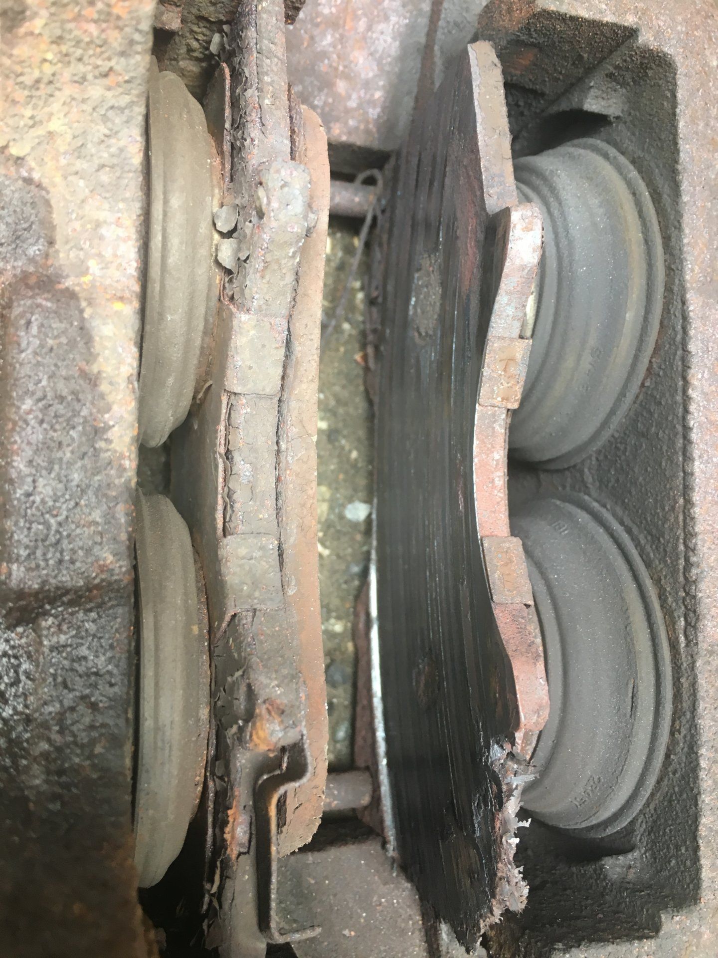

I’ve noticed the right front brake making a little noise lately. I looked into it and saw the outboard rotor face was getting chewed up from the pad, unexpected since I did a visual inspection when I did the rack and shocks, it all looked ok then. It also drove fine. I looked under the truck and saw this little surprise.

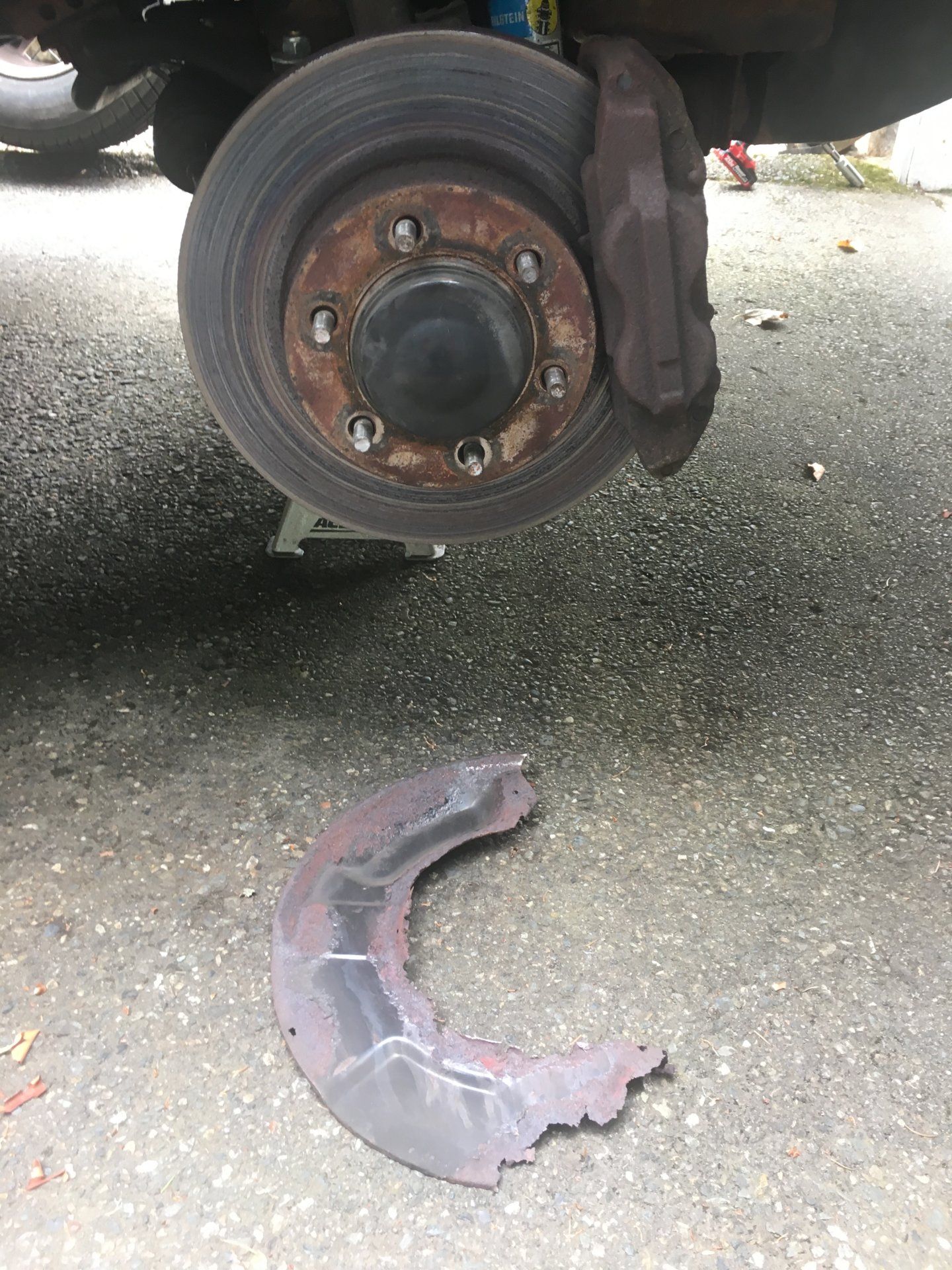

Off with the front wheels and the backing plate fell to the ground.
Off with the calipers and as expected the outboard pad was toast.

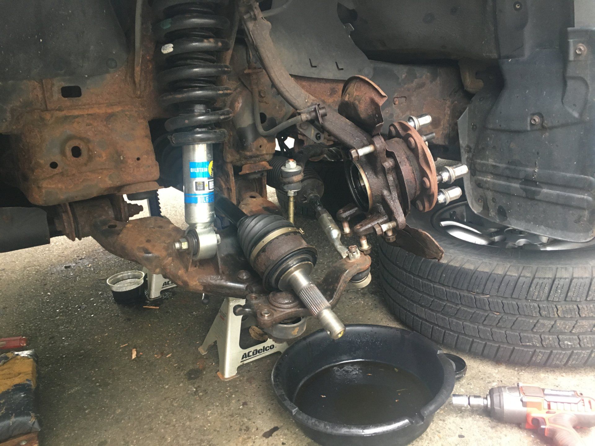

Current state, need to get that left side axle out.

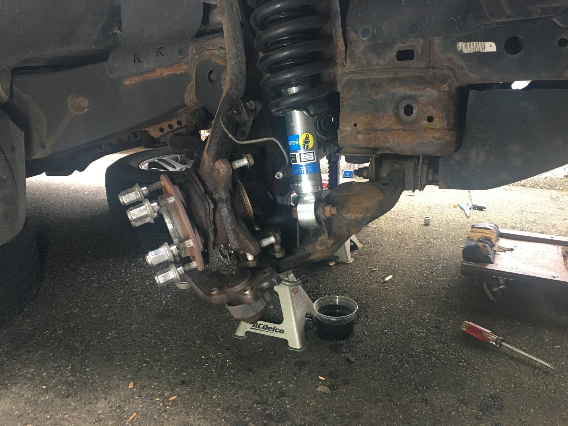

Time to get these knuckles off so the hubs can be pressed out and the new backing plates installed.

Been fighting with rusty cotter pins, super fun but it could have been a lot worse. The right side knuckle is now off.

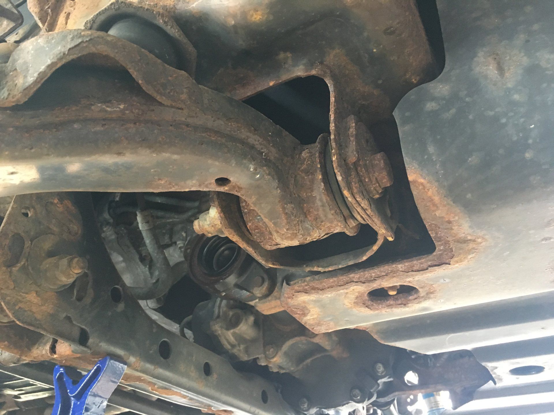

UCA hardware looks new, it even looks better than that in my Tundra and that has been an AZ truck most of its life. So that must have been replaced relatively recently.

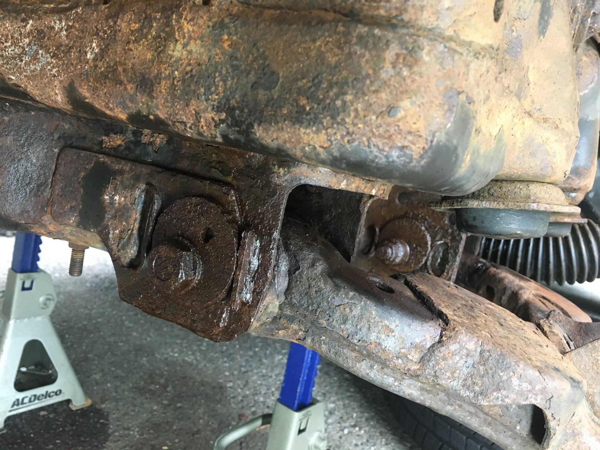

Not surprisingly, the LCA is a totally different story.
Now that I’m this deep doing the cam adjusters and bushings look like a better idea. This also is a great opportunity to clean up some of that surface rust and throw some paint or POR-15 on there. Additionally I’m considering taking the 5100’s down a notch (.7”/18mm), dead level just doesn’t look right to my eye.

Stripped down to the arms. Wasn’t too bad getting there, rusty cotter pins were the worst part. I wasn’t planning on doing these but while I’m here...
After much deliberation I’ve decided to leave the control arms alone for now. The bushings test out ok, the alignment is good enough. No sense in throwing another $600+ at it at this point in time. I’ll also leave the 5100’s where they are for now, once I get my wheels and tires on there I’ll decide whether to drop the front down a hair or put a short spacer in the rear.

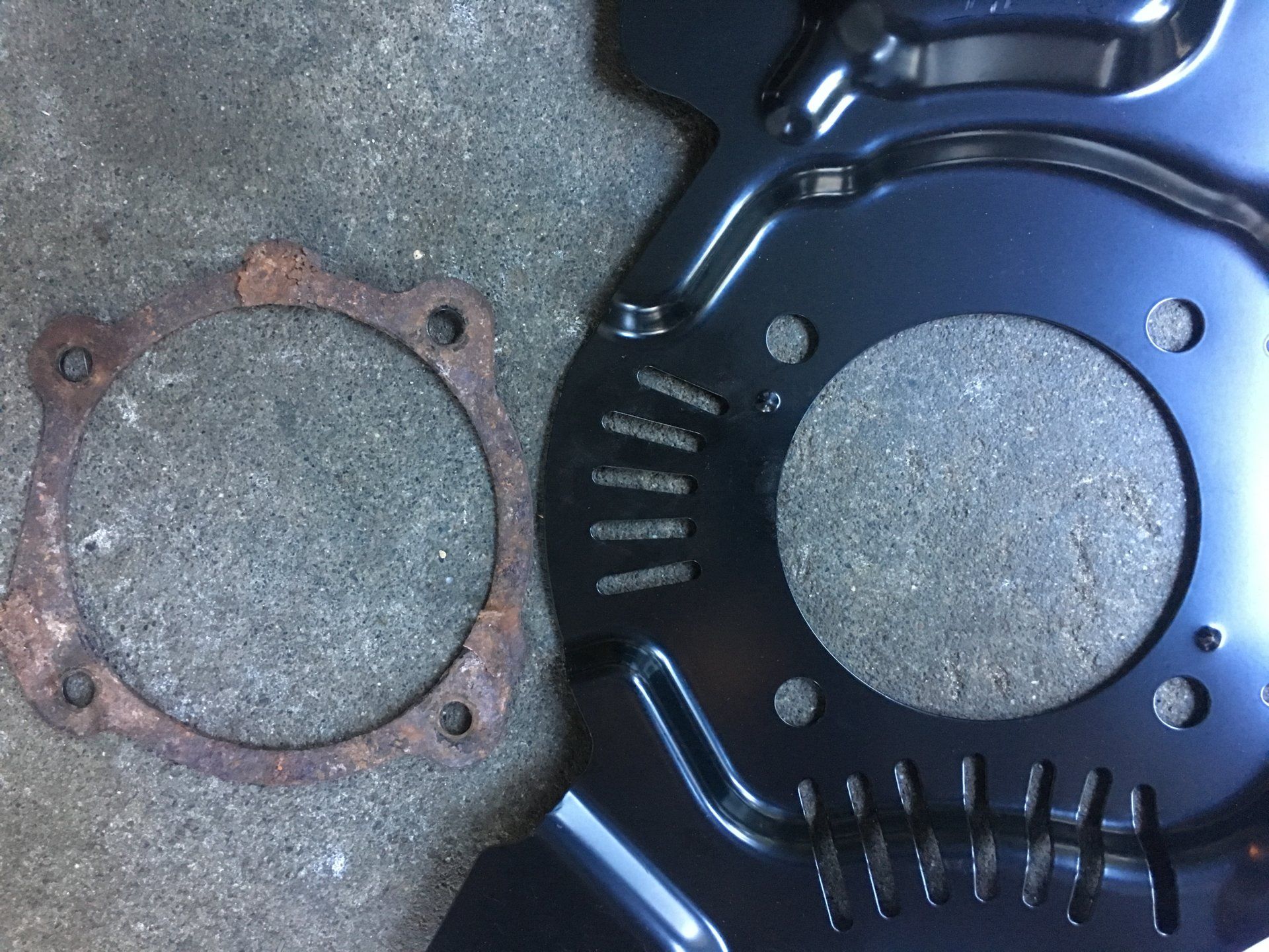

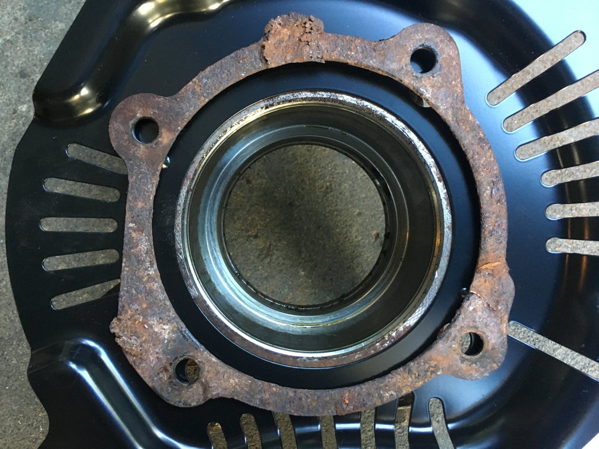

Let me start by saying that I understand backing plates aren’t necessary. I’ve run plenty of old cars without. I do prefer to use them, so when the originals rotted out I figured I might as well replace them with GX460 units to match the brake upgrade. It should be easy, right? Pull the knuckles off, have the hubs pressed out, swap the new plates on, have the old hubs pressed back on and Bob’s your uncle.
It’s not that simple.
When I dropped the knuckles off at the machine shop I was told that pressing the hubs out usually ruins the bearings. Fantastic. And that I would have to replace more than just the inner seals (that I just spent $80 on). Super. At least I won’t have wheel bearings with 260k miles on them anymore.
Picked the pieces up today. Got home and offered up the backing plates. No go. Inside diameter on the GX plates is quite a bit smaller. That’s the factory Sequoia reinforcement piece lying on top (which was welded to the original plates, interestingly the GX plates are not reinforced).
Does not come close to fitting on the knuckle.
Also the bolt pattern is different.
If I would have known this debacle lied ahead I would have just skipped backing plates and saved myself heaps of money, time and sweat. But I’m here now so there’s nothing to do but follow through. These backing plates are going on.
So I’m thinking first I’ll open up the ID to fit. Bolt up a GX460 caliper to see how the plate needs to be clocked. Find where the new holes need to be in the plate and drill them. Clean up the original reinforcement pieces and spot weld them on. Hopefully by then Robert will in fact be your father’s brother.

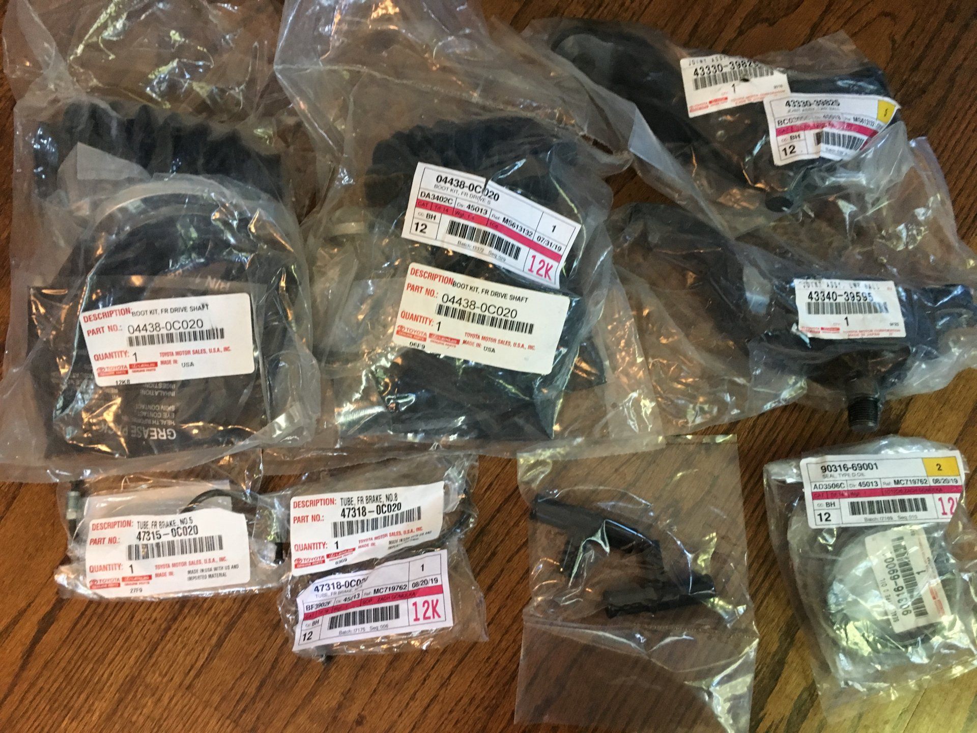

Also, parts finally arrived today from McGeorge. CV boot kits, lower ball joints, hard brakes lines that connect to the caliper (one of mine snapped), inner CV/knuckle seals, and the ubiquitous heater T’s which are so well talked about on the 100 forum.
