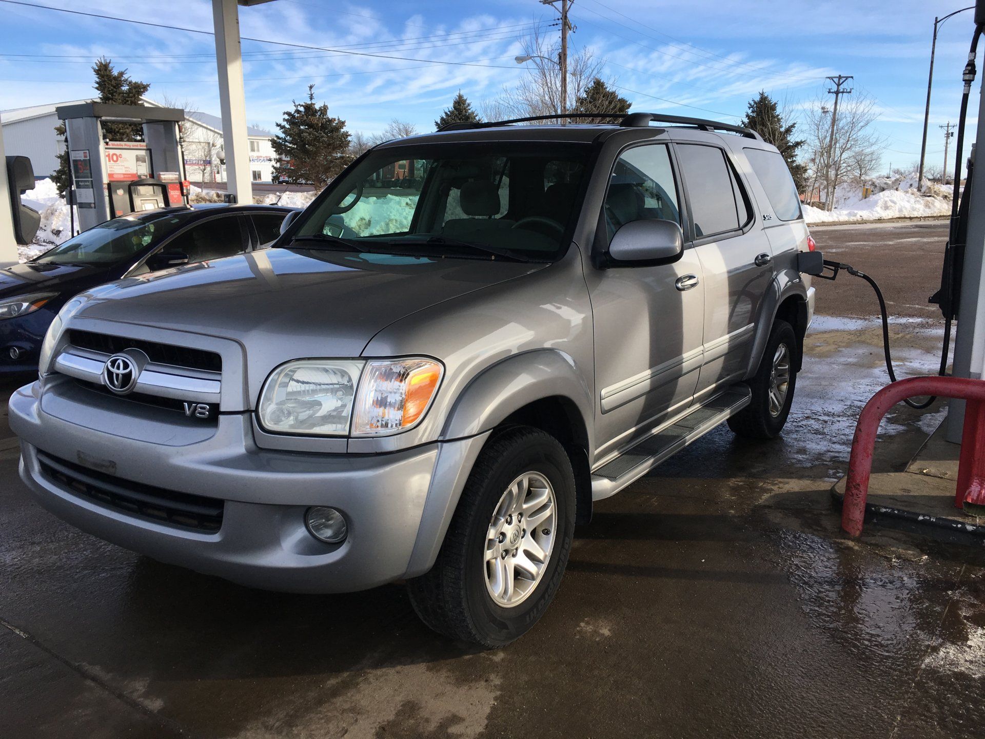

First thing I noticed was how damn cheap Sequoia's are! Once I learned that, I talked the wife into it and it was game on. After about 6 weeks of searching I found my victim on eBay at a used car dealership just north of Chicago. It was the exact truck I wanted (except maybe the colour). 2005, SR5, cloth seats, towing package, sunroof and that all important 4WD. Very basic. One owner, always dealer serviced, mint interior, solid frame and clean vehicle history reports. 256k miles, $3,750.
They're not the be-all end-all of trucks or suvs, but they are hidden gems for sure. They're all used as minivans around here so once you remove the kid mess, you end up with a pretty decent vehicle for not much money. Congrats on the find, and I hope you have many great years with it.
In stock form it is for sure a soccer mom special. I don't have the desire to do any heavy off roading, with a slight lift and much better tires I'm sure the Sequoia has the capabilities to take me anywhere I want to go. At least for now... we'll see if I evolve on that over time. Truth be told, I'd prefer to have a 06-08 V8 4Runner (a Sequoia is much more vehicle than I actually need), but all else being equal that would cost me 2-3x what the Sequoia was. So I'll live with it.
The only problem I saw with this particular Sequoia is that it was 2,000 miles away... Buying something sight unseen and taking a chance on it is going to be a little nerve racking. Especially considering what my drive home would look like, in the dead of winter.

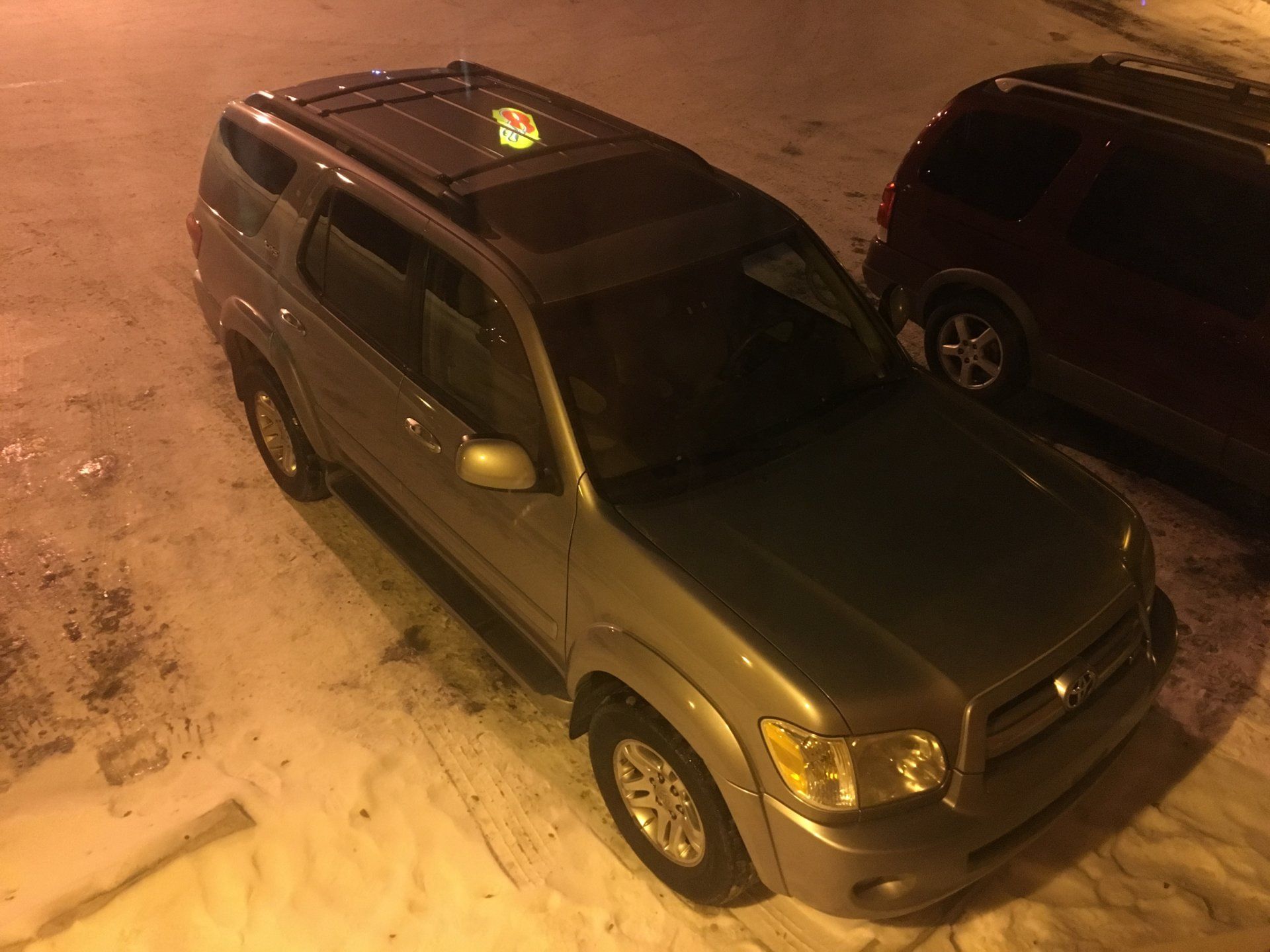

This afternoon I was in the middle of nowhere on a tiny two lane highway in the southeastern corner of Montana, I missed my turn so I made a u-turn, totally mis-judged it, went a little wide and ended up sliding down the snowy embankment. Put it in 4 lo with the center diff lock on and crawled right out, even with the crummy tires that are on there. It totally saved my hide!
I slept for s*** last night, so I didn’t get the early start I was hoping for. Drove straight through to Butte, nearly 900 miles. Just got in a few minutes ago. This rig is gaining my confidence with every mile I drive (now just over 1300). Still averaging around 15mpg, the 80mph speed limits up in this part of the country aren’t great for mileage!

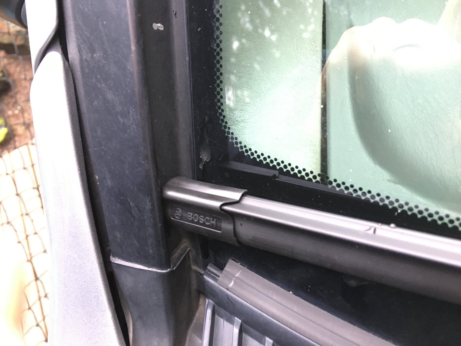

Tundra’s and Sequoia’s use little 19” blades. Years ago while shopping for new blades on my Tundra I noticed that there was a lot of real estate on the windshield for larger blades. And since blades are mostly the same cost regardless of size I figured, why not? Anyway, eventually I maxed out with a 21” blade on the drivers side and a 24” blade on the passenger. A substantial increase in coverage.
One of the first things I noticed when I used the wipers in the Sequoia was the weak coverage that they have. So I figured I would do the same as my Tundra. I tested my 21/24 blades out and realized that the Sequoia has even more room to go up. I maxed out at 24” on the drivers side for a upper sweep increase of 2.5” and 26” on the passenger for a sweep increase of 3.5”. It’s tight, really tight, but it all fits. All blades are Bosch Icon, I haven’t found anything that works better and lasts longer.
Just slides under the lip on the left A pillar molding.
The difference is pretty massive. I realized that previously I was leaning forward in my seat so I could see certain areas of the road, now I can sit back and see everything clearly. This is a modification that I do to every car we own, and since the price is the same, why the hell wouldn’t you? And why the hell did Toyota use such dinky little blades to begin with?

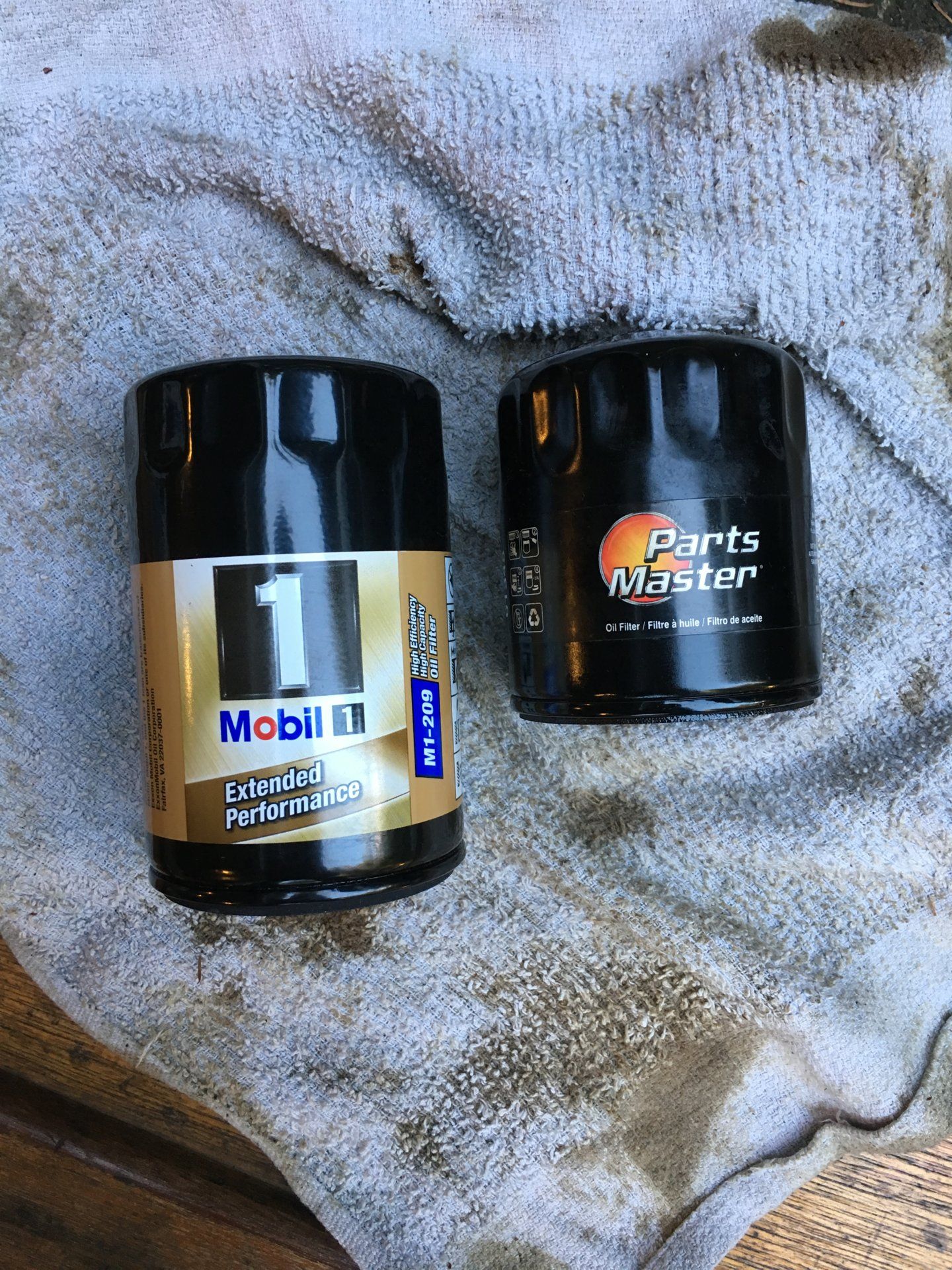

A couple days ago I was reading the owners manual and figured out the “engine maintenance” light just meant that an oil change was due 🤣 How was I to know, this is the newest car I’ve owned! So I obliged. Mobil 1 5w30 and a larger capacity filter, in this case the M1-209.
