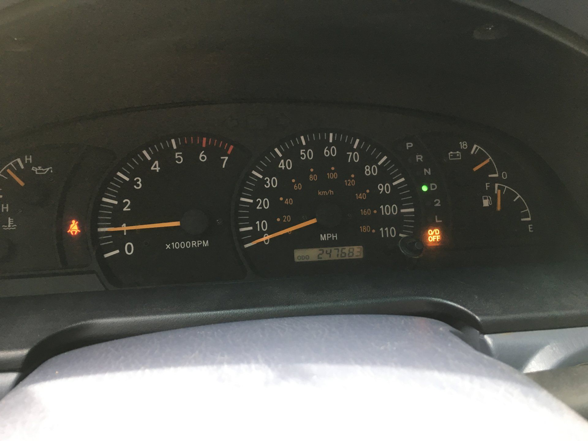

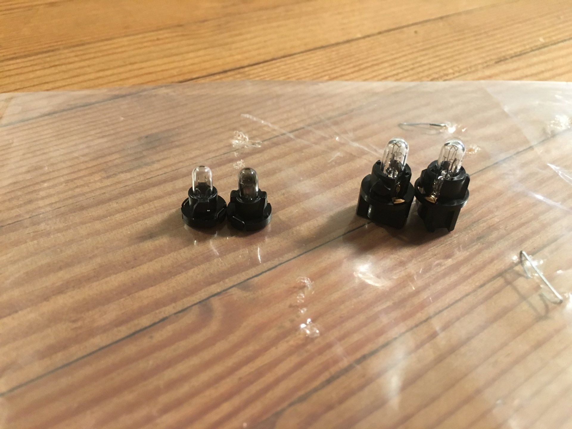

Parts arrived today! The plan was to put the instrument panel back together in the Tundra but unfortunately the drive and O/D off bulbs they sent me were far too big.
Originals on the left.
Anyone know what’s up with this? All of my research showed that the correct bulb was the 83120-60020. I’m awaiting response from McGeorge Toyota.

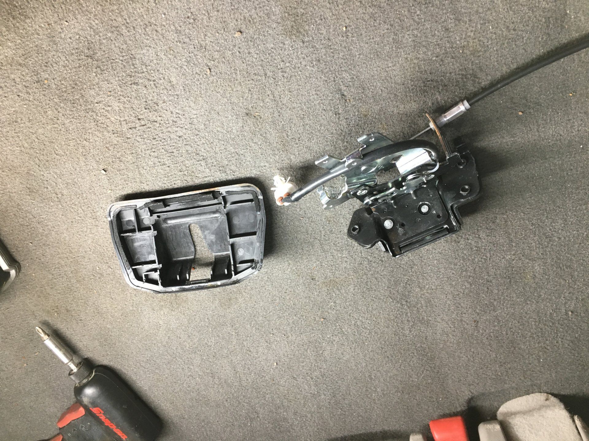

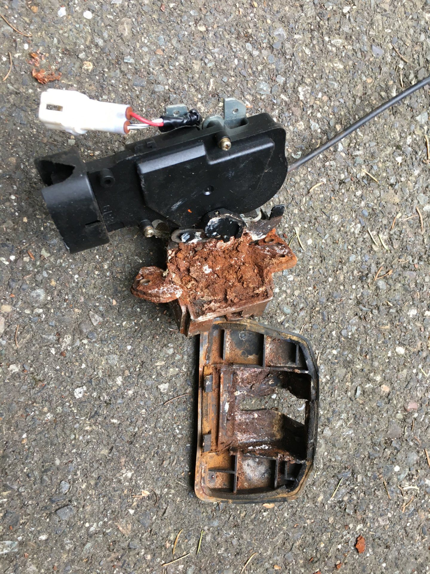

Since finishing that project wasn’t an option I turned my attention to the rear hatch on the Sequoia. Since my ownership the hatch has been very difficult to unlatch and it wouldn’t completely close allowing it to bang around a little bit over bumps. It finally stopped working altogether a couple weeks ago. I ordered a new latch assembly and got to it.
The original latch was completely wasted. Hard to believe it worked at all!
It took longer to clean the gobs of old lithium grease off of everything than to r&r. The handle itself looked relatively new, it must have been replaced somewhat recently.
Install went smoothly, and I also found a 6mm nut inside the hatch that is back to where it belongs and no longer rattling around in there. The hatch opens easily and closes tightly. I’m happy!
good work. I also have something rattling around my hatch. I need to open it up and see...
Do it before it breaks, it’s a bit of a pain in the ass to get in there when the hatch won’t open.
McGeorge has been helpful, they said the bulbs I ordered should have been correct. I sent the picture of the old vs new and now they are sending a return package for the wrong bulbs and a new pair that should work, 83120-04090.

Still waiting on the correct instrument panel bulbs, hopefully today.

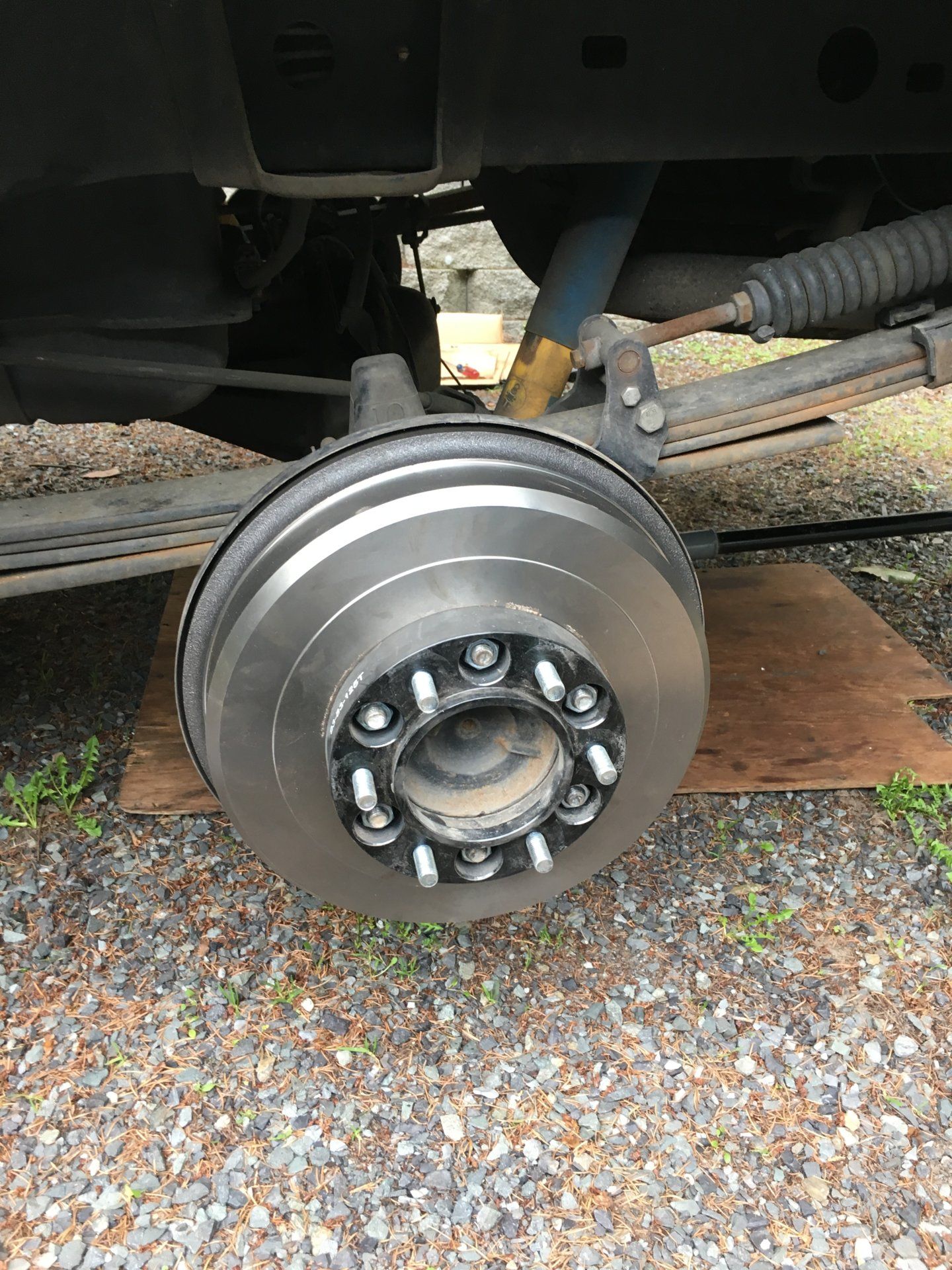

I’ve had some brake vibration in my Tundra that I narrowed down to the original 247k mile rear drums. I tried getting the original drums machined but they were slightly past spec and I couldn’t convince the guy to just do them anyway so I picked up a cheap pair of replacements. Good enough to sell.
McGeorge hasn’t even shipped the correct bulbs to me yet, I got tired of waiting so I asked for credit and bought the bulbs at my local dealer (for twice the price). I haven’t seen the D and O/D lights in years!! And I’ll have to start driving this a little more, no way I’m selling it will a full tank of 92!

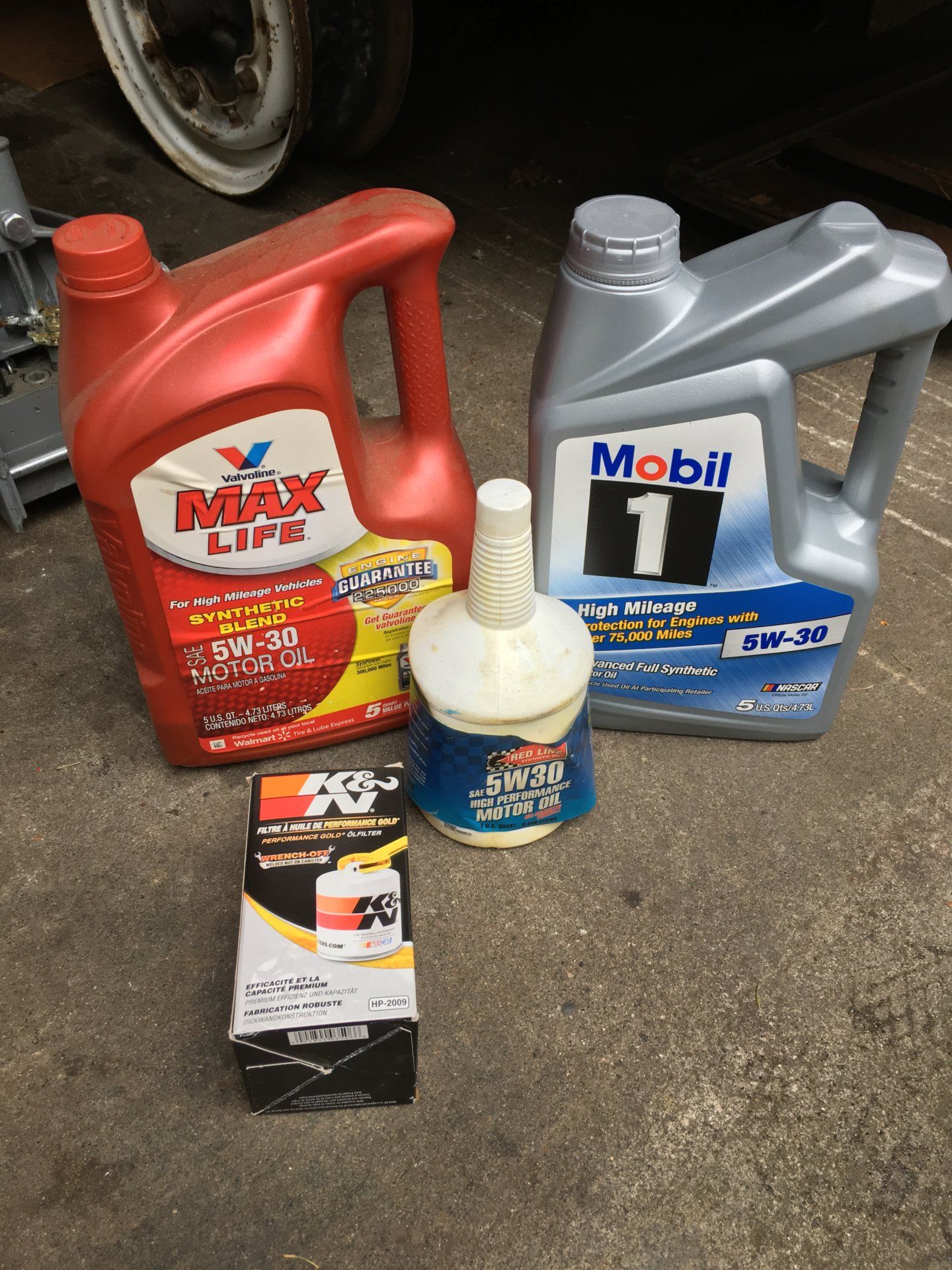

It was also due for an oil change. I had a little Redline left over from 10ish years ago and the PO of our house left a little Valvoline in the garage. I made up the difference with some Mobil1, at least it’s all 5w-30! I used the K&N version of the Mobil1 filter I pictured previously in the thread (larger capacity) because I’ve read good things about the K&N and it has that handy nut welded to the bottom.

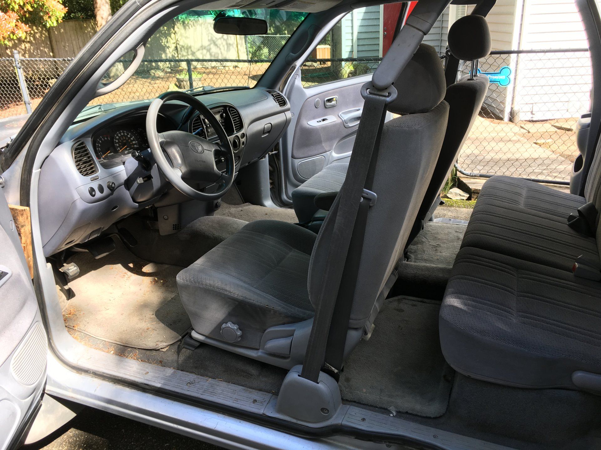

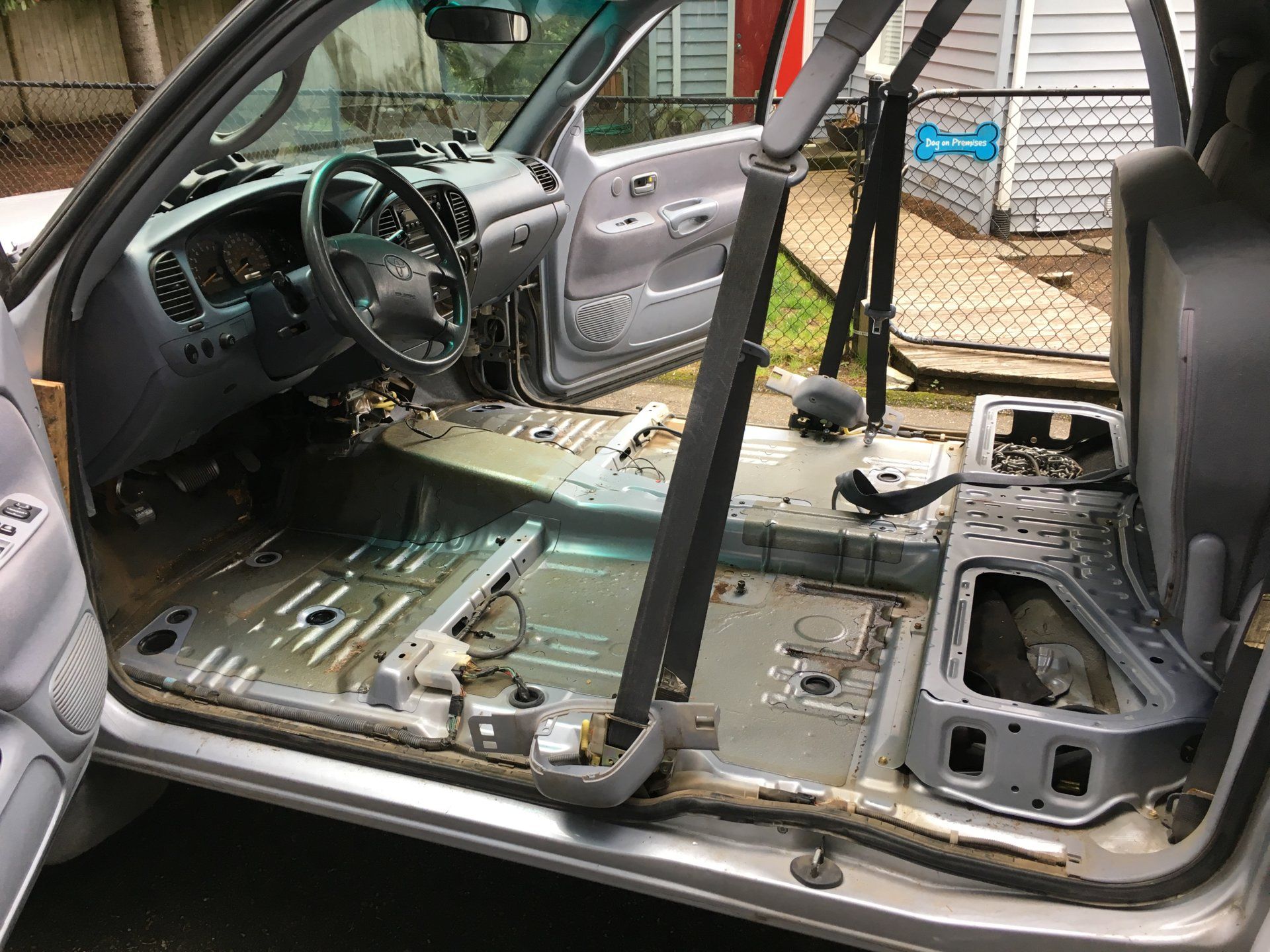

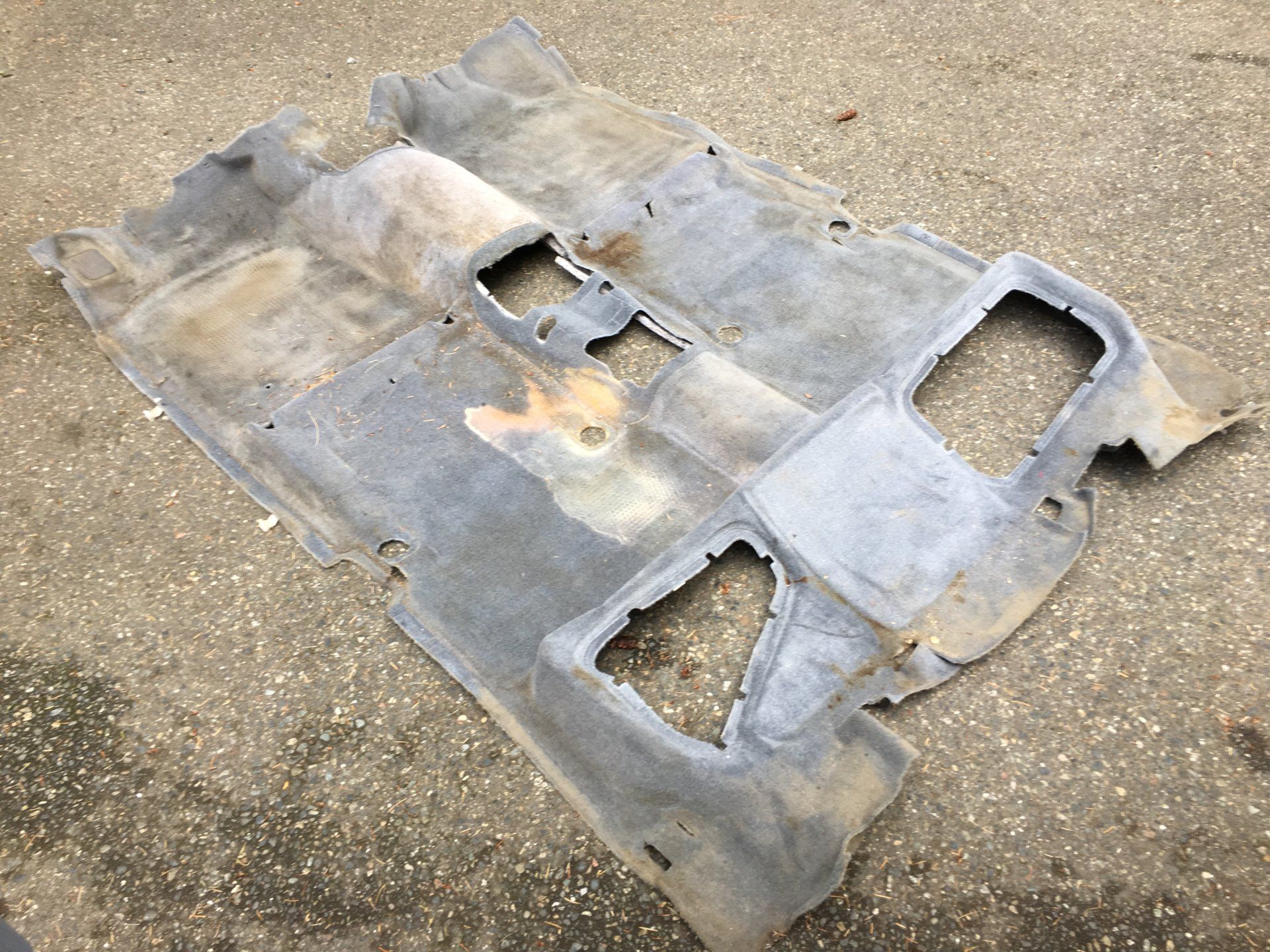

I needed to get at the AUX cable to see why it wasn’t working. I figured it was a good time to pull the carpet and give it a well needed power wash. I also took the opportunity to clean up 19 years of dust and dirt from the metal surfaces and door jambs. It’s going to be downright civil in there now.
I’m hoping it will be dry enough to reinstall tomorrow but I’m not betting on it.
AUX cable now works 👍🏼
I had a little break in the weather after work today so I got busy and reinstalled the interior. Cleaned and detailed every piece I touched along the way. All that’s left now inside is cleaning up the door panels and dash.

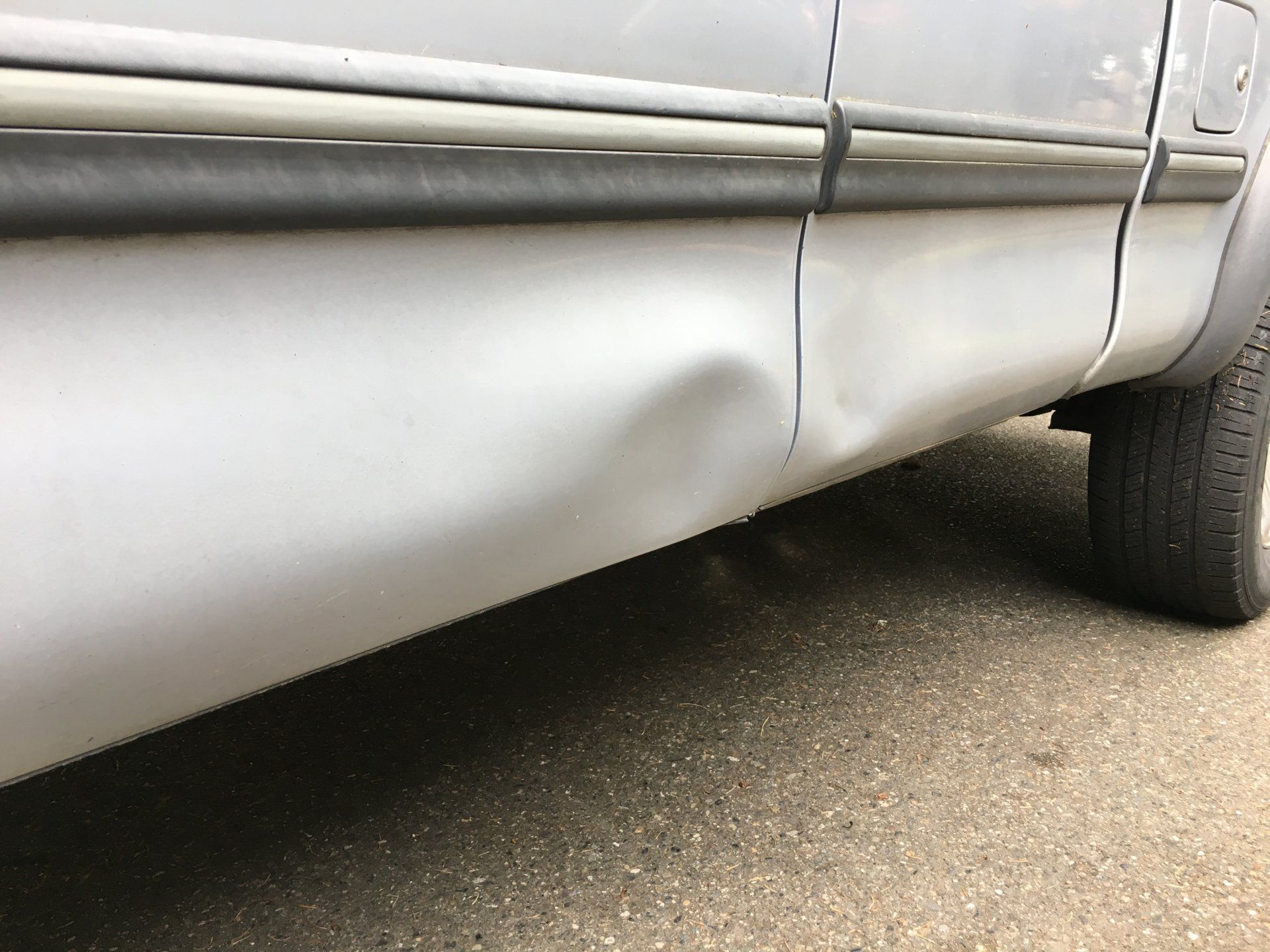

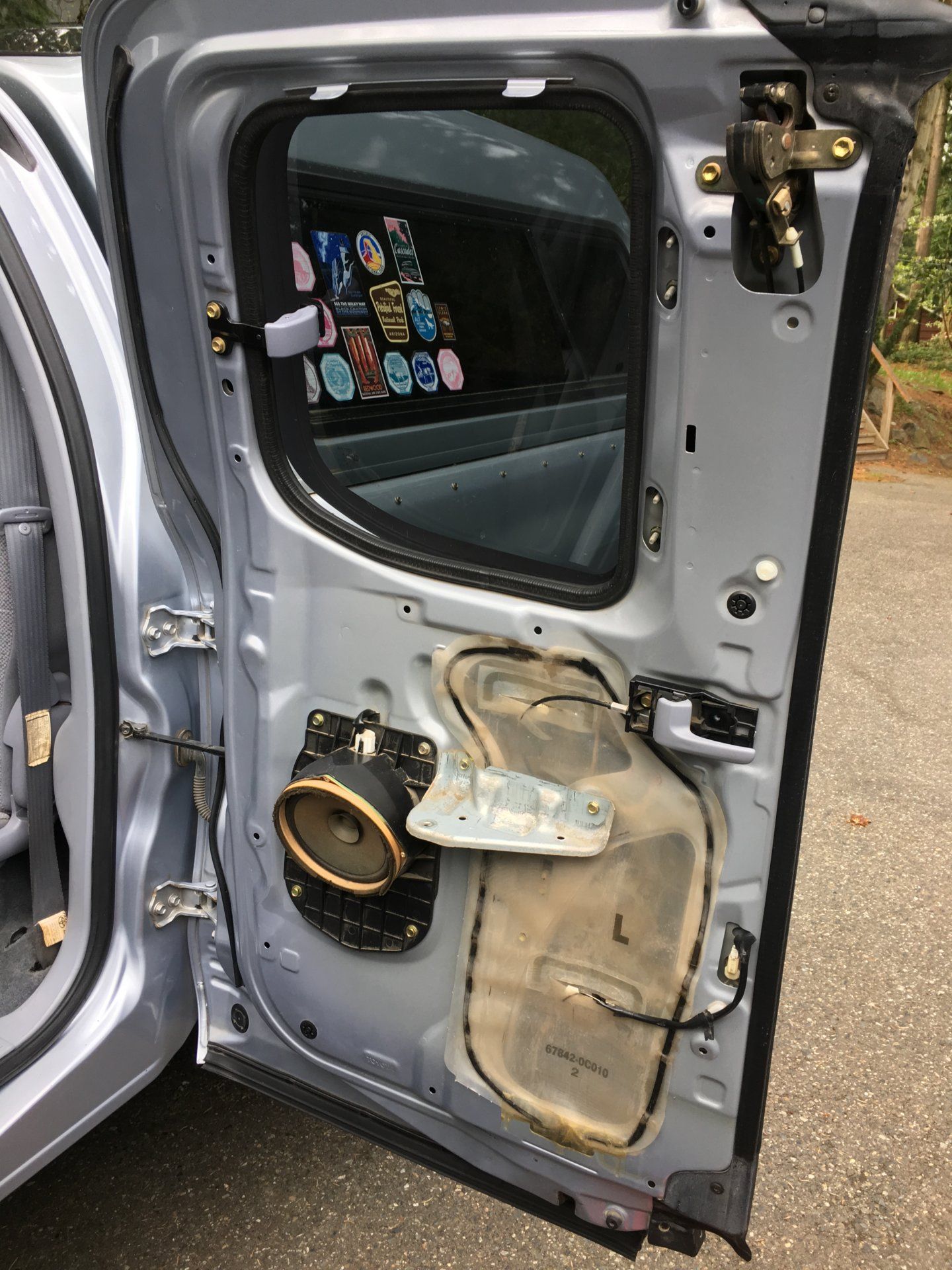

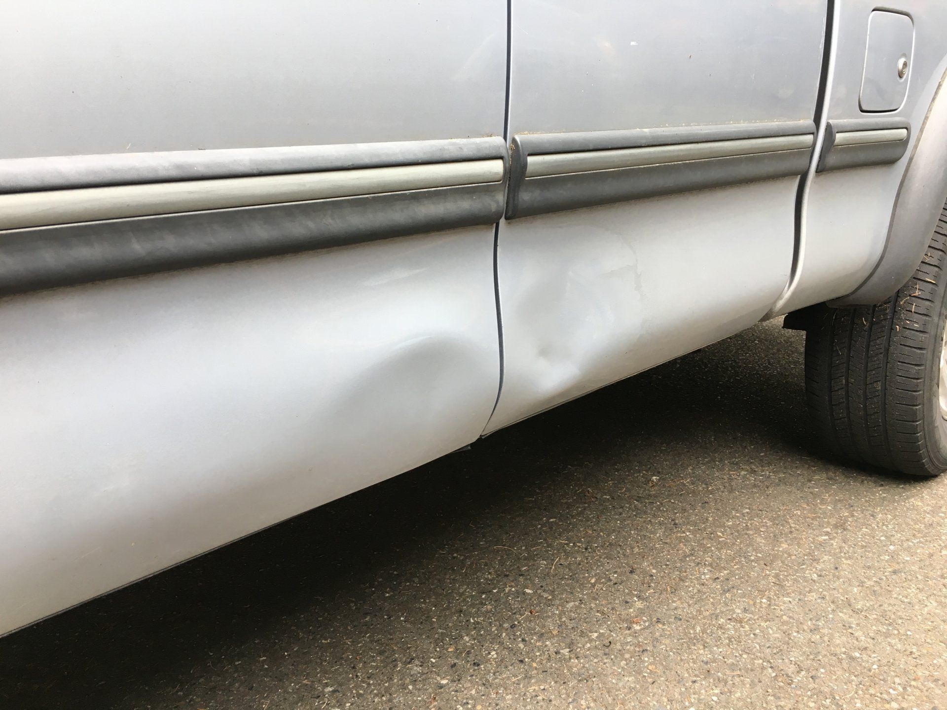

Anyway, I did a little more work yesterday. My goal was to use the football trick (stuff deflated football between panels and pump it up) and pop out this dent in my door where a deer hit me 4 years ago. I was able to work it out a little but not as much as I hoped for.
At least it gave me the opportunity to clean up the door panel and inner door properly. I also saw that I forgot to plug the tweeter back in from the last time I was in there. Oops!
With that door put back together I moved to clean up the rear suicide door. I was 99% done when this happened :bang:
Luckily (very luckily!) I had kept a new hinge in the center console all these years.
Within maybe 20 minutes I had the panel off, new hinge installed, panel and inner door cleaned up and back together. I love how easy Toyota's are to work on.
