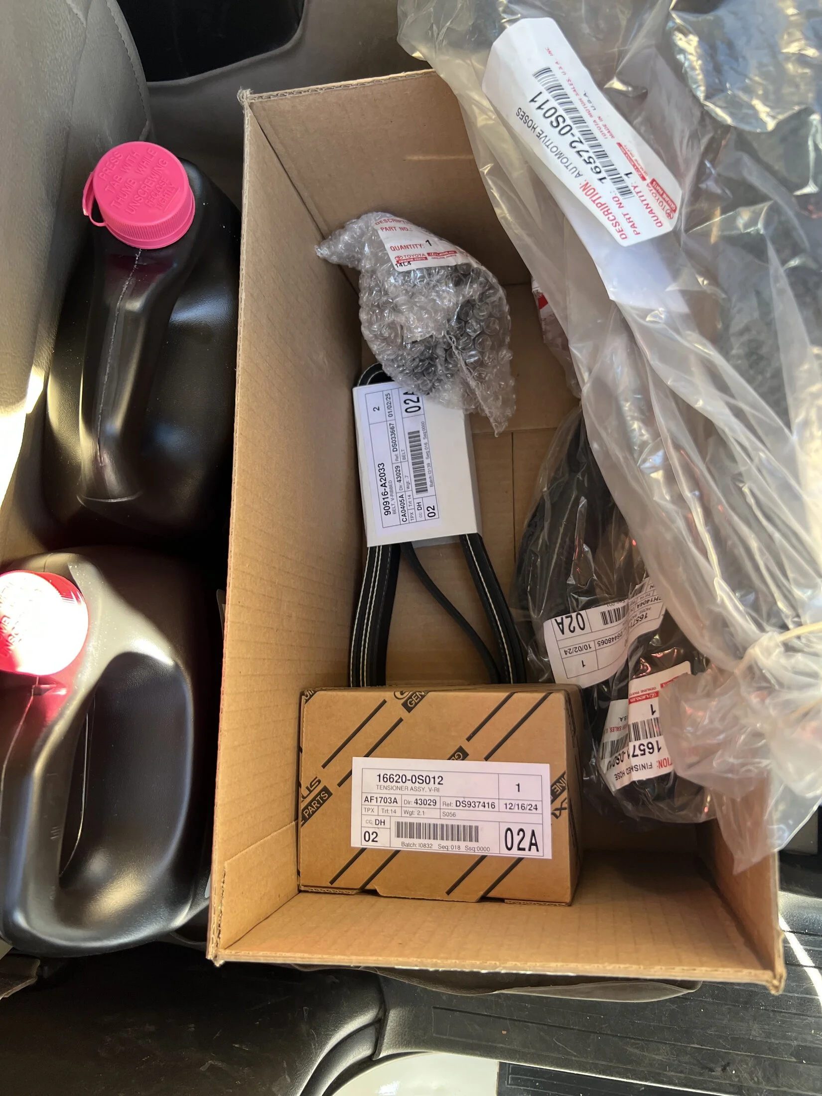

Anything else you suggest? I was going to order the parts above from Rockauto but they’re all Gates or AC Delco, which I’ve had mixed experiences with.
I think I’m going to go OEM for those parts, even at 2x the cost.
Wouldn’t hurt, the tensioner is a common issue. Also check the water pump and make sure it isn’t seeping. OEM wherever possible unless Aisin or Denso parts can be sourced. The OEM tensioner is not very expensive, I think I paid $75 for mine.

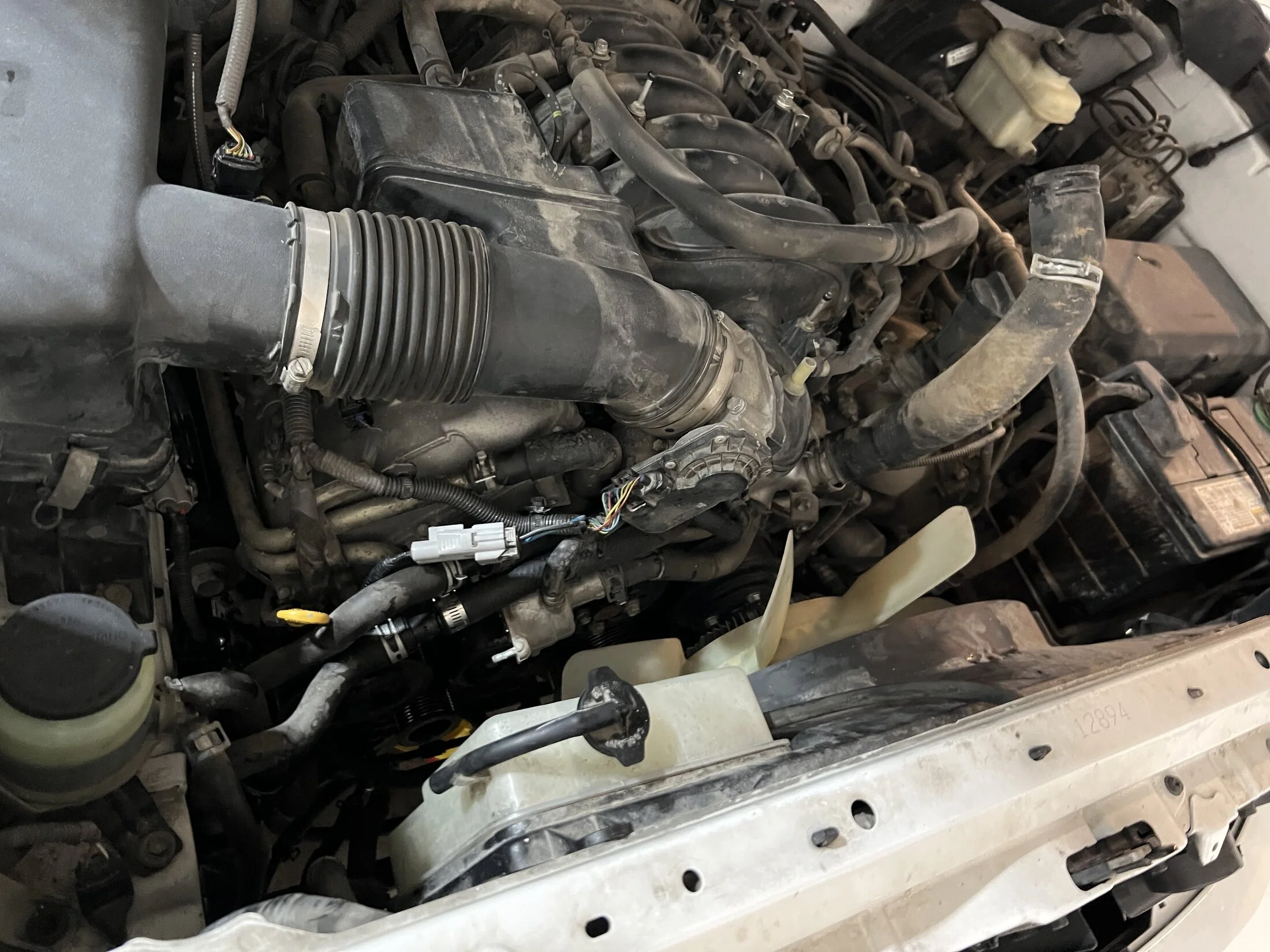

Got it pretty much done. Wasn’t bad at all. I didn’t remove the fan. It was very easy to get the radiator out. I didn’t even need anyone to help guide it out and the new one back in. I did remove the little petcock to help it get past the fan shroud easier. Probably a non-issue if you have a friend helping.

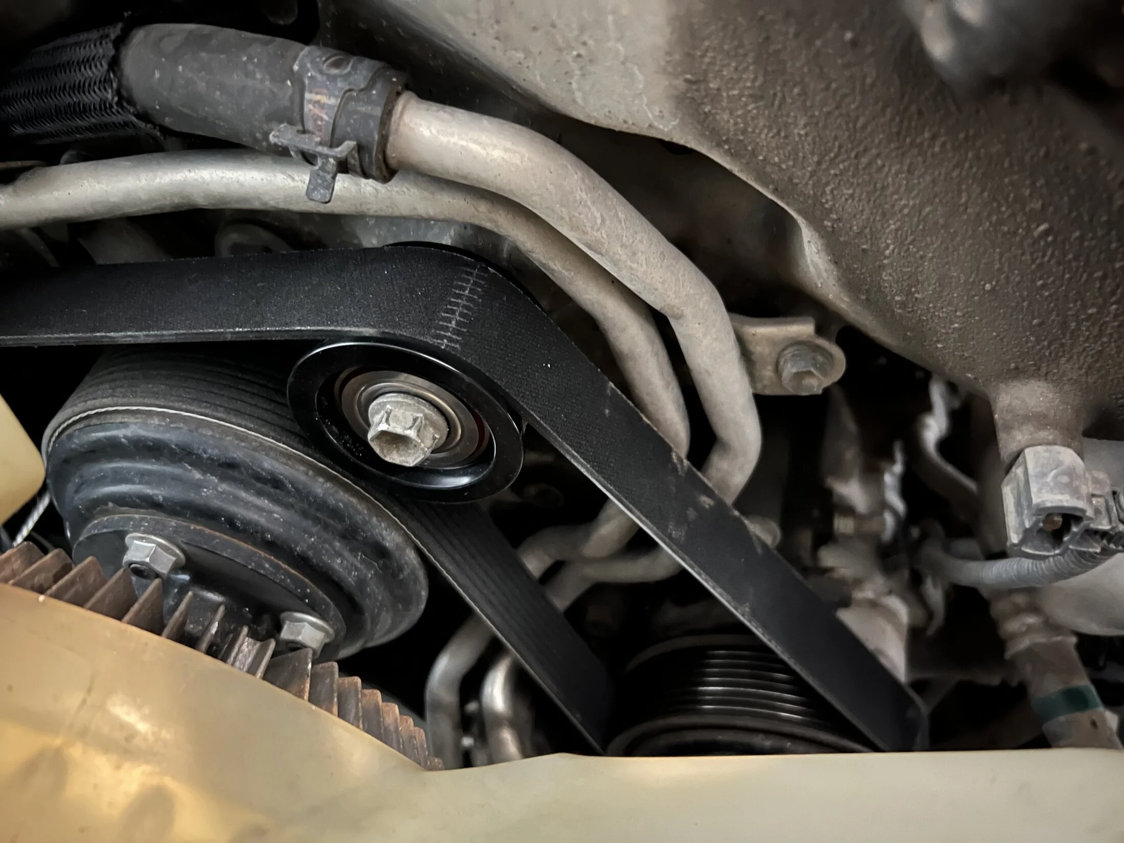

It was MUCH easier to do the serpentine belt with the radiator and hoses out of the way. I removed the radiator, lower hose and thermostat and there was a lot of room to work with. Some videos showed having to snake the serp belt through the top then moving to the bottom to loop around the pulleys, then back to the top… This was easy with all of the parts removed.

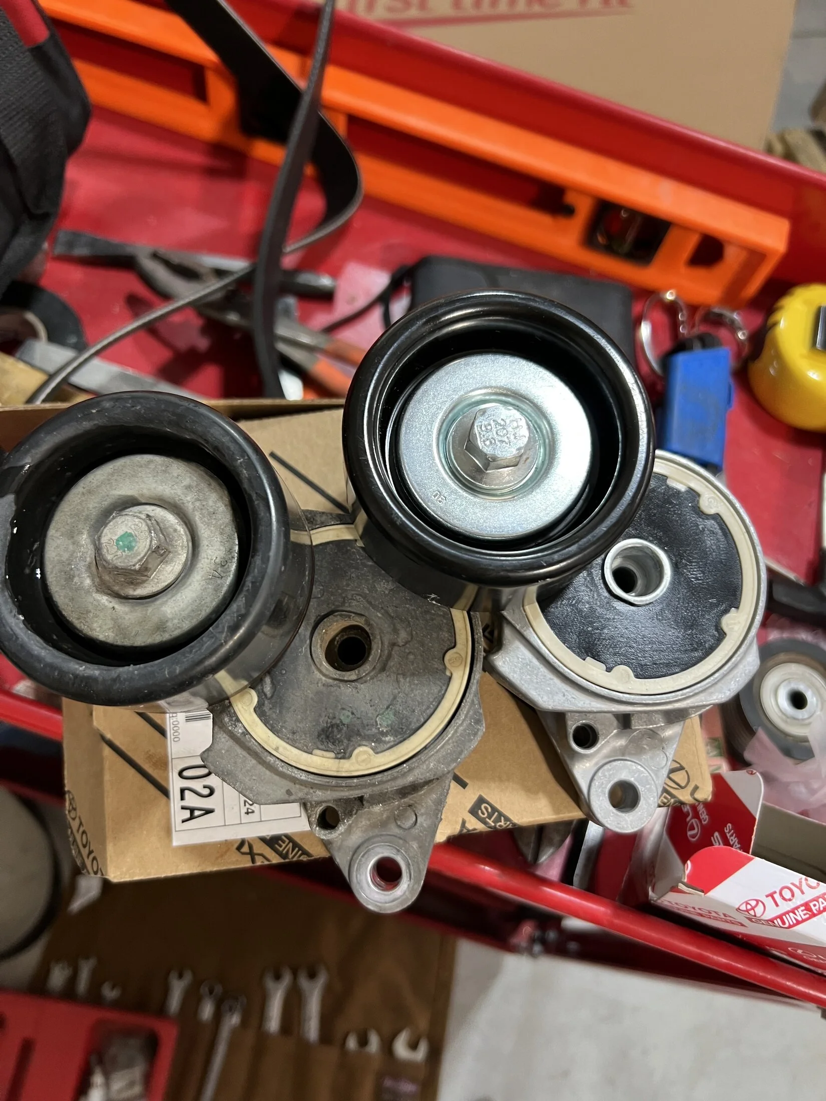

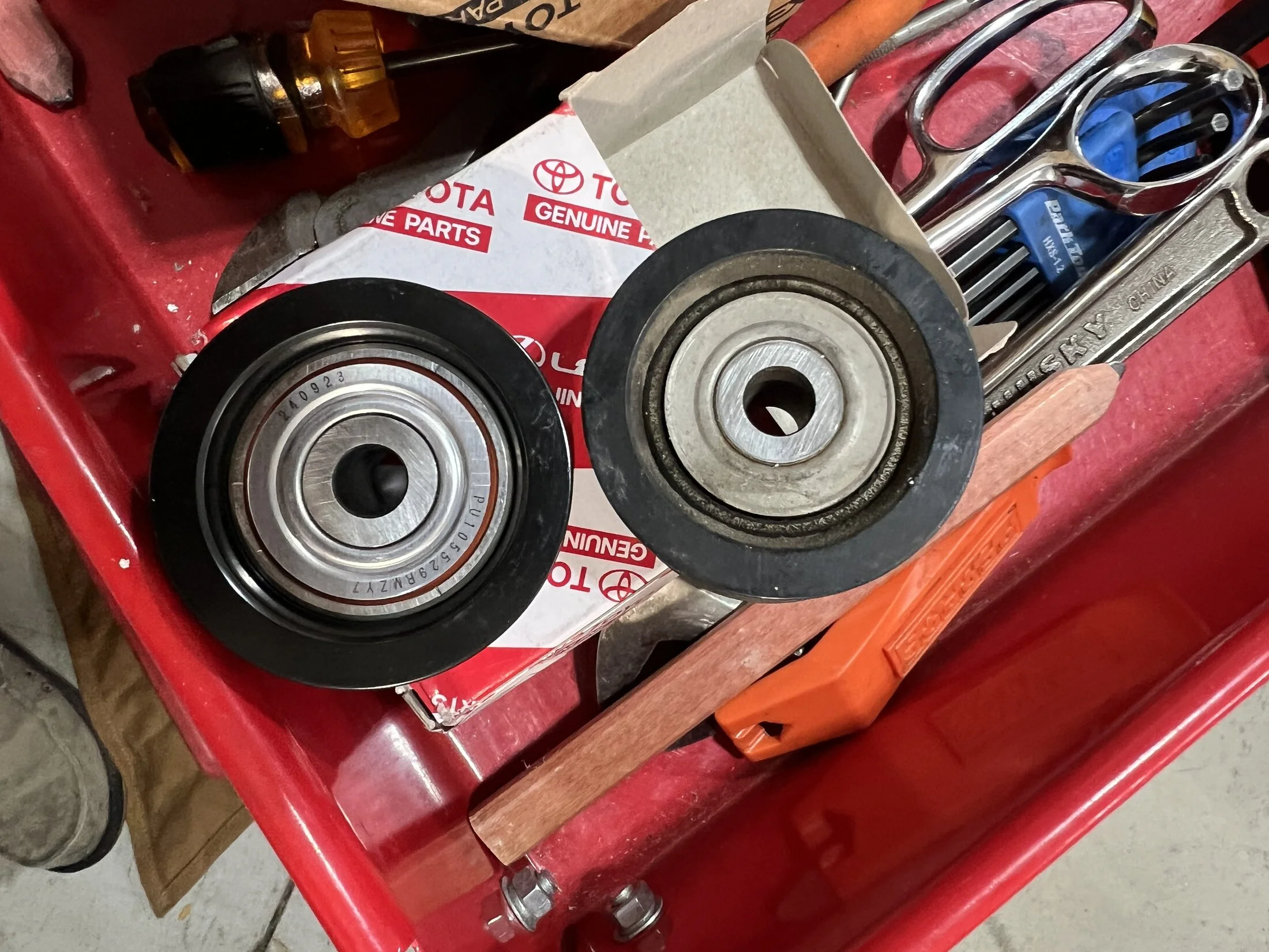

Old vs new bearings. Lots of play in the old bearings, which I believe are the original (200k miles). No more squeaking at start up.
I just paid the dealership & got a new serpentine belt & tensioner done <6mo ago.
It only has ~90K on the powertrain but the belt was ~13YO & a tensioner seemed like smart $$ as it only added 1/2HR to labor charge.
IIRC it was just about $300-$325 taxed total.
Peace of mind it was worth it - even at just 90K it quieted the startup noise.
