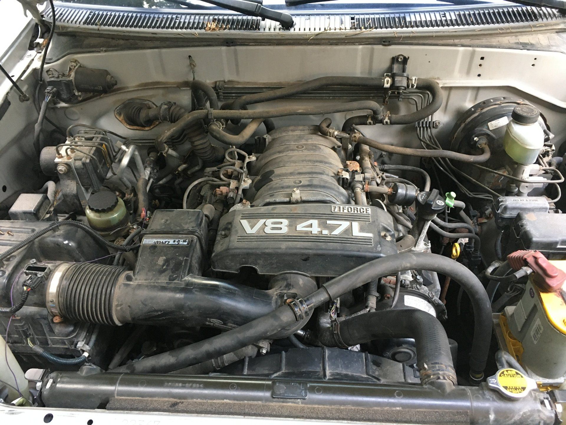

Water pump appears to have a slow leak... according to the dealer. I haven’t looked under there yet but I knew coolant was getting out of somewhere. They wanted to do that, timing belt and cam seals to the tune of $3,000:rofl: It’s not quite ready for a timing belt yet (16k more miles) but I can hear some pulley bearing noise that doesn’t sound classy. It would be nice to take care of all of that in one shot. So I should plan on doing that this summer...
I’ve been tinkering away on this. I found out that the “water pump leak” that the dealer found was actually just the thermostat housing o-ring. Fixing that seemed like a good time to replace the tensioner/belt and clean the throttle body and MAF.
I eventually learned that the tensioner is pretty buried.

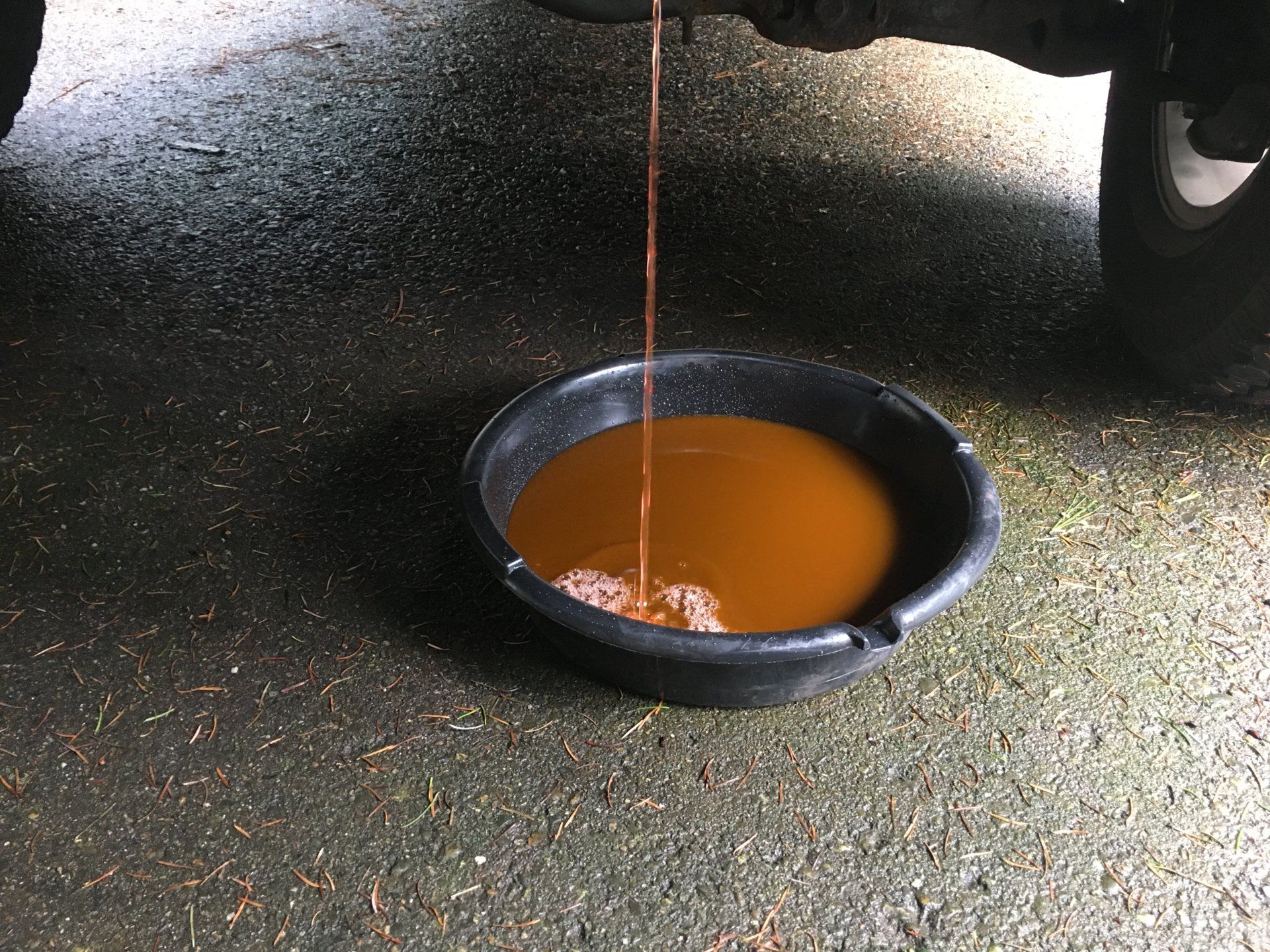

I also learned that I was very much overdue for a radiator flush.
But eventually I got it all back together, leak free and a lot quieter.
I’m running distilled water and cleaner in it currently, planning on doing that a couple times before going back to proper coolant.

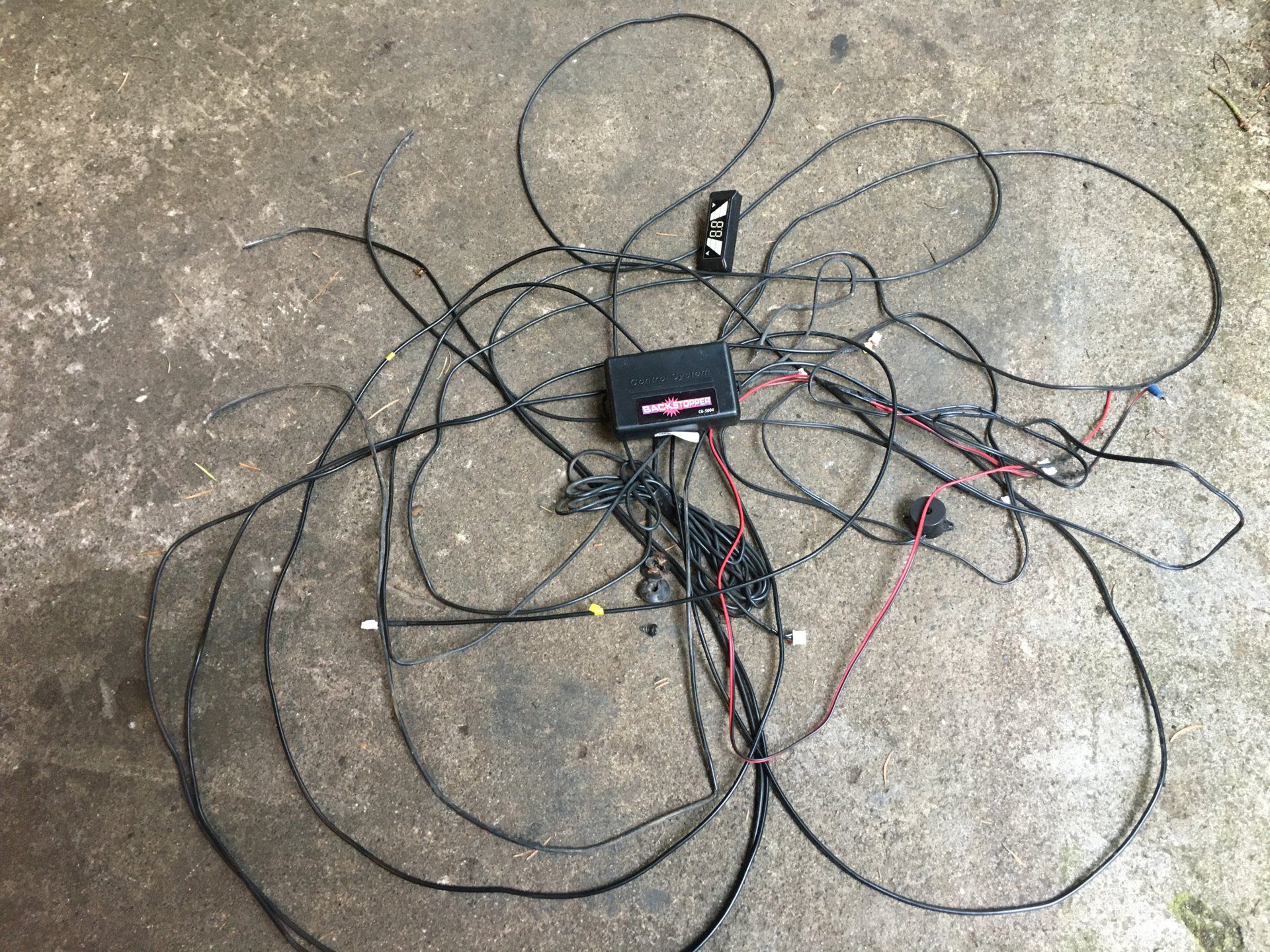

My Sequoia only had two non stock modifications when I bought it: The Optima yellow top (still going strong) and this stupid BACKSTOPPER reverse beepy thing. I have no idea why I waited so long to rip this garbage out.
