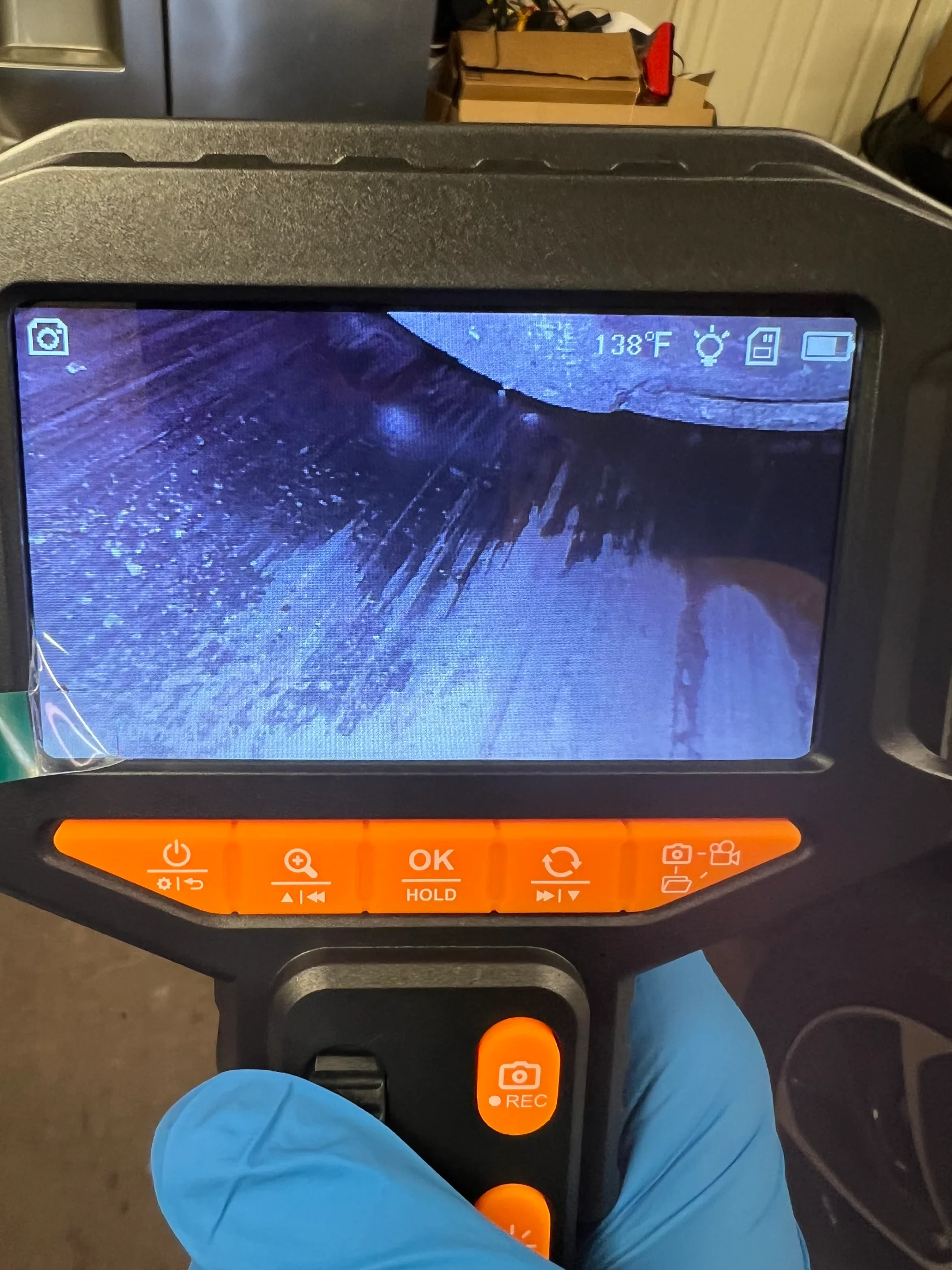

Did some better scoping today. Several cylinders are so scored they are flaking off and that is the debris seen on the piston head. I think she’s cooked, literally. I guess compression is low enough it isn’t starting.
It is best to find a replacement engine or if you can find a wrecked 100 with good engine.
