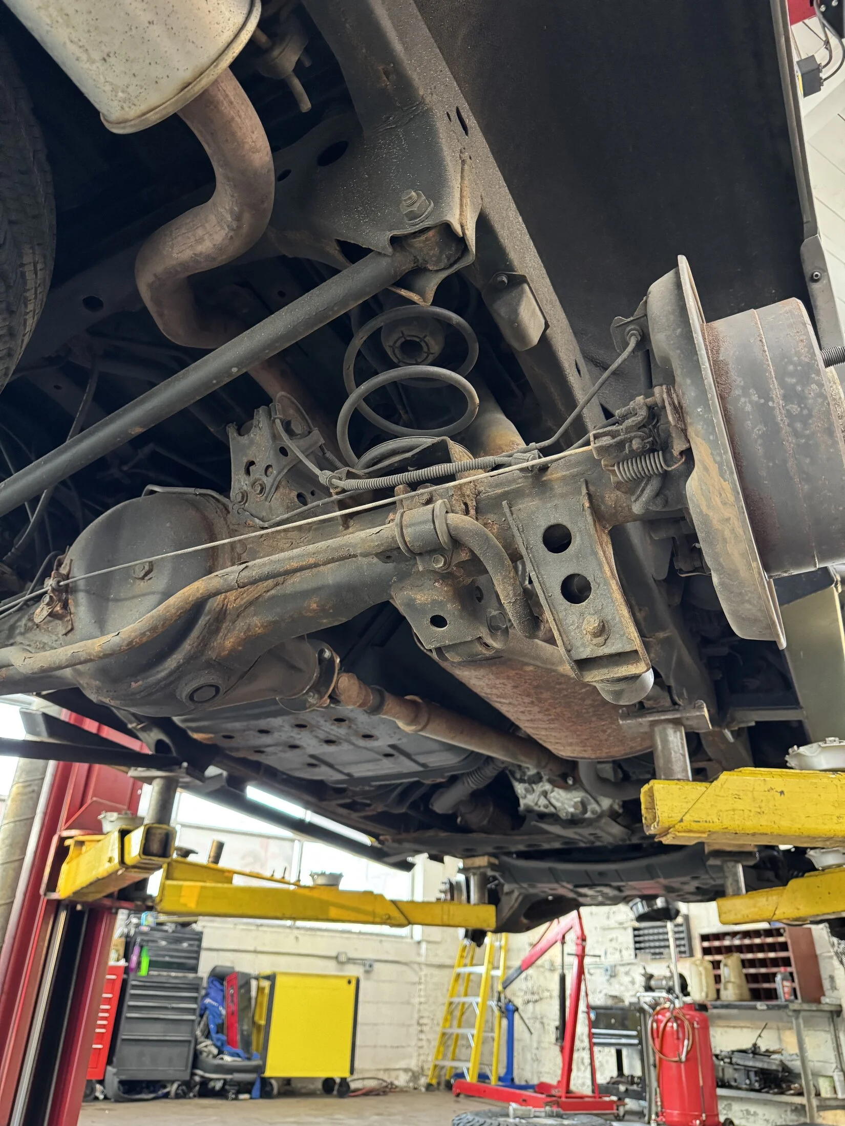

Moved to Boston with it 3 years ago and immediately had it waxoyled per a recommendation from a buddy up here who is also into keeping old trucks on the road. Yesterday, in the process of putting on new tires and brakes all around, was able to get a good look underneath for the first time in a while. The guy at the shop said nothing crazy for what cars look like around here but there is one spot that looks kind of gnarly to me. I'd like to put another 100k on this truck if possible, so if there is something I can/should do I'd like to.
@whitec13 - you mention the "standard hole developing in rear crossmember" - is this what you're talking about? It appears to be a lot worse on left than right.

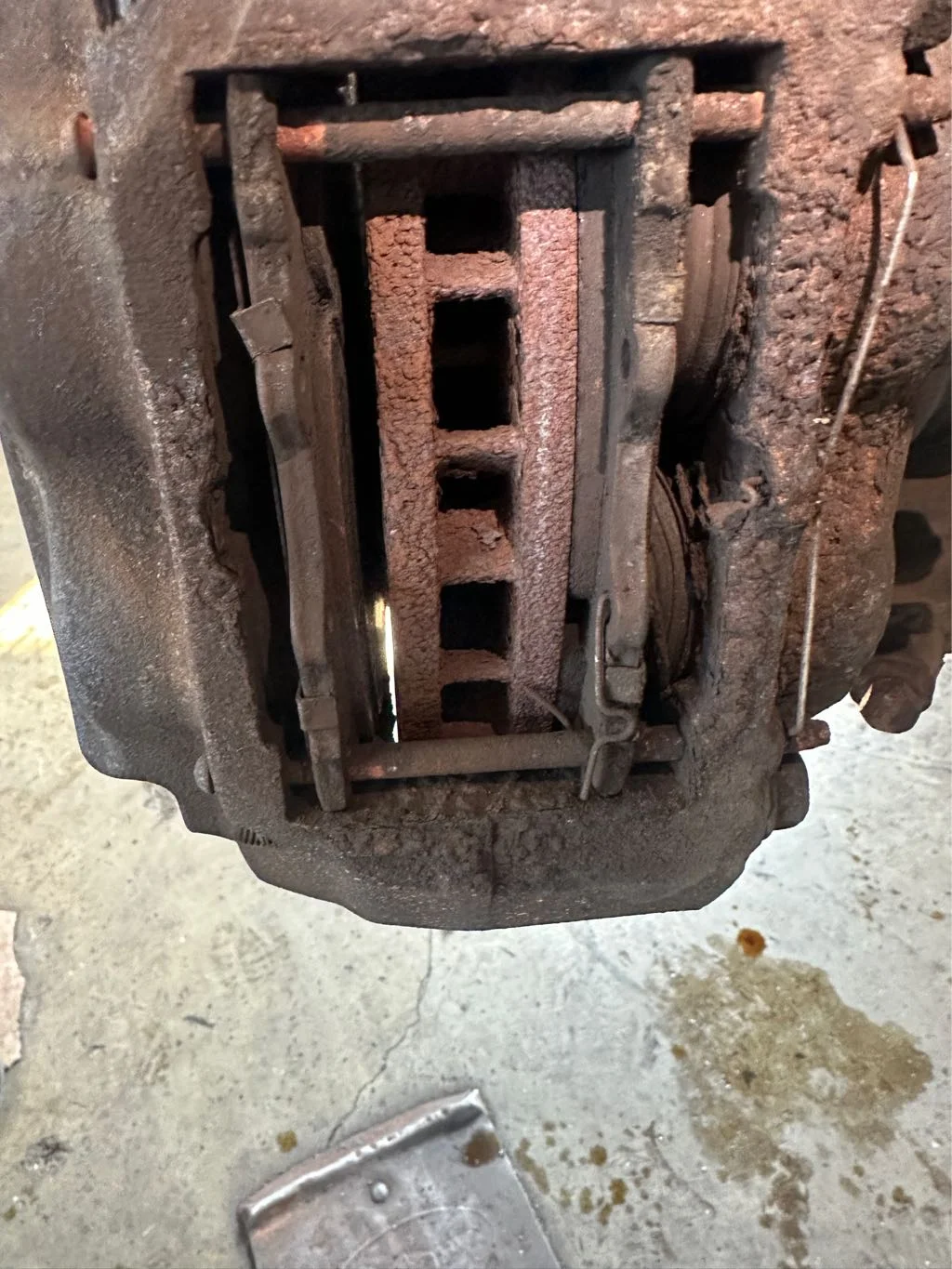

Aaaaand here are the front brakes that got replaced. Big yikes. Rears weren't so bad.
Yes sir, even excellent examples out west have this on occasion. Just a bad design that created a festering pocket. Frames have never been Toyota’s strong suit 😂
The left side of that cross member (above spare) can easily be repaired, but you may run into some additional work where it attaches to the frame. A very common repair needed on these trucks. Looks like you will need calipers, rotors and pads as well. Looks like the pads are getting hung up on the slide pins due to corrosion. If you go this route, take some time to paint the calipers. It slows down the oxidation significantly.
Highly recommend at least a Woolwax application to slow down the oxidation build up that is attacking your frame and suspension. Drop the exhaust, pull out the shocks (replace if rusted through and leaking) and as many components as possible in order to clean and prep for application. The more time and effort you put in, the better the result!

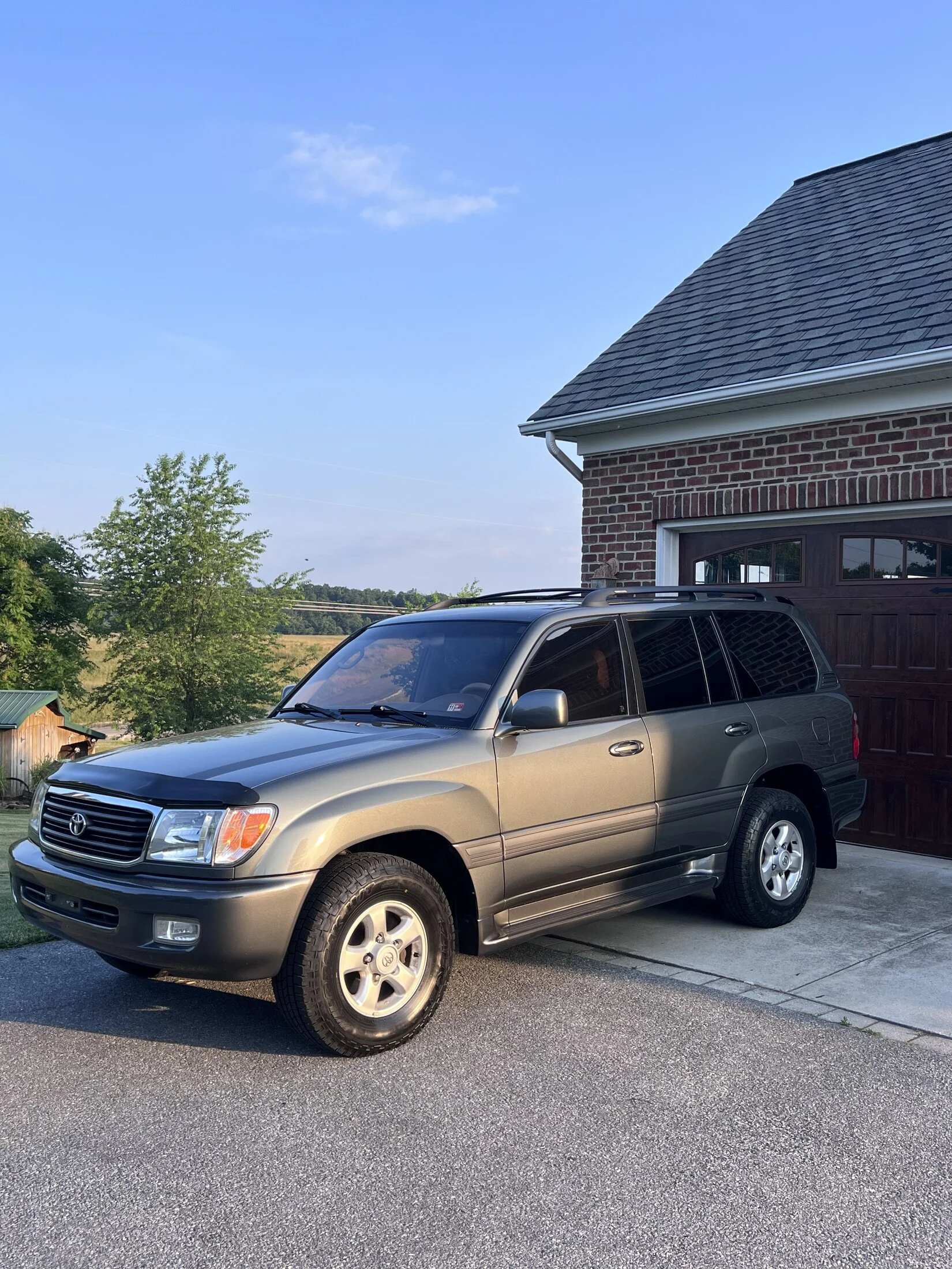

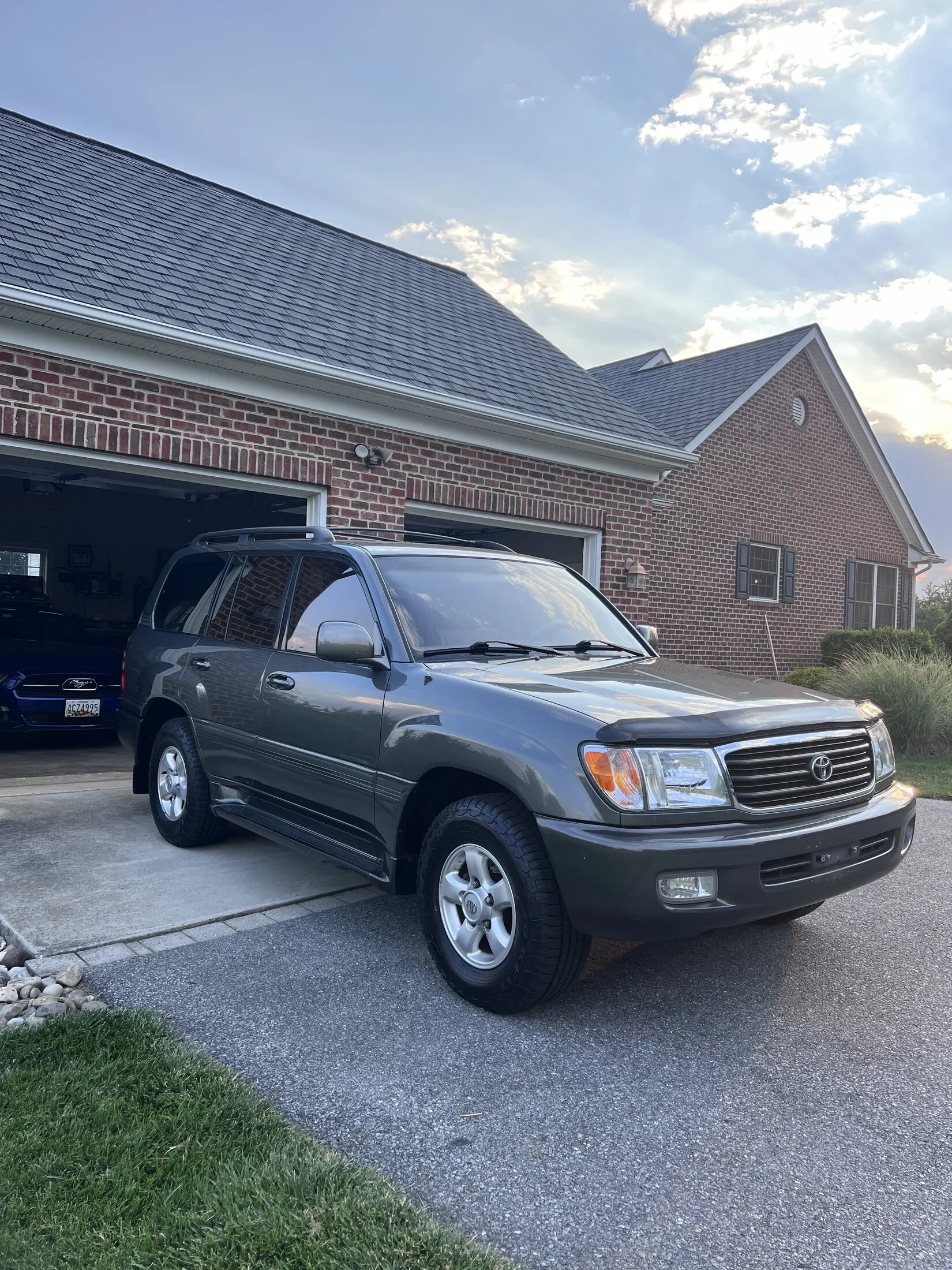

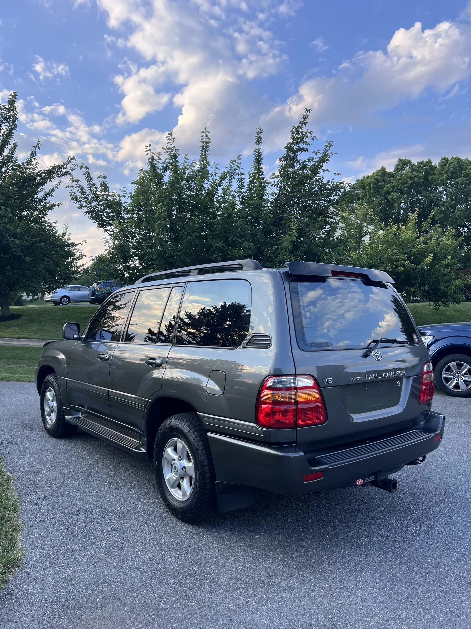

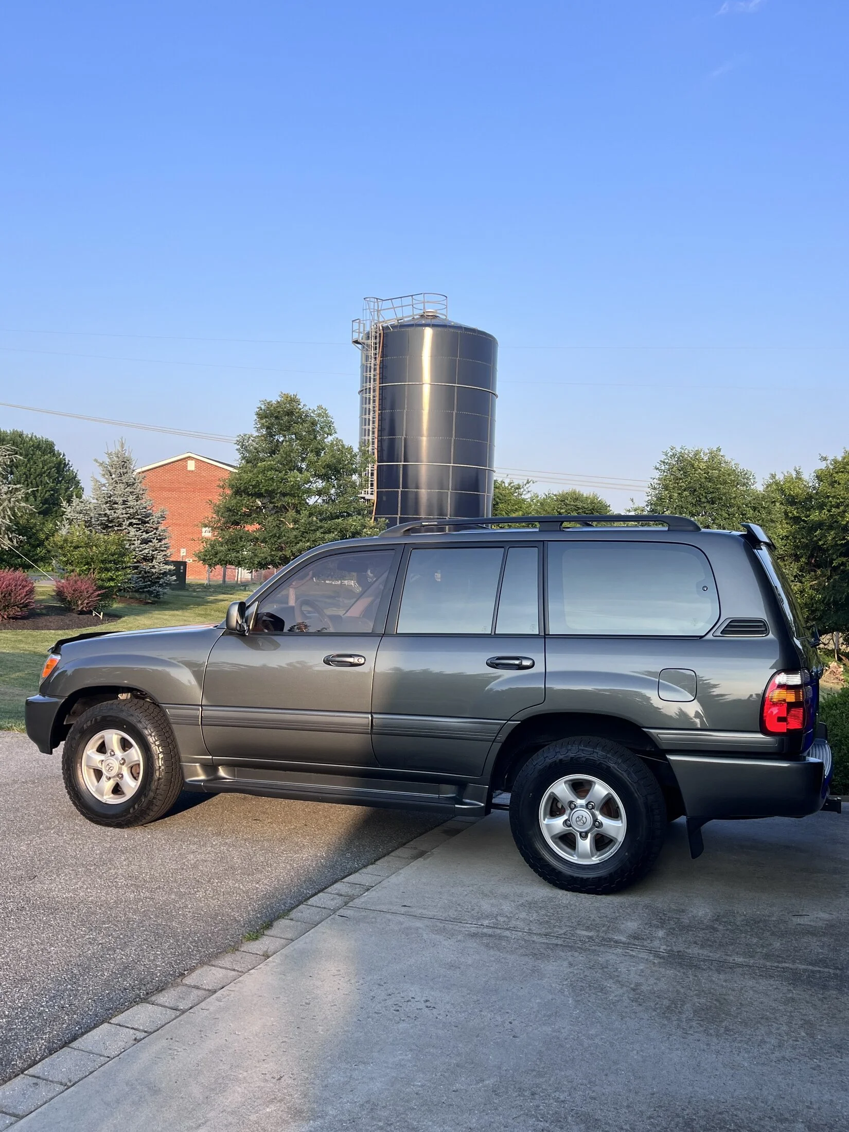

Are you saying the level of rust on my specific LC would cause you to run? Maybe it’s because I’m from Maryland but personally I did not find it to be concerning enough to walk away with how clean the exterior and interior were. I most likely would have had to fly out somewhere to find one with no rust. Wasn’t sure that was something I wanted to commit to.
As a fellow Marylander that bought a model year 2000 with similar rust, I can tell you that if you do not treat it and remove or convert all of the rust
you see, as well as liberally apply fluid film or wool wax, in 4 to 5 years you will not want to invest one penny in the truck anymore. In fact, I went and bought a second completely rust free 100 series from NC due to this exact issue. Just treating with fluid film will not be enough for Md. Considering it’s shape so far I would private message the guy up in Boston that replied above and see what it takes to get your car professionally done. Rust is like cancer, you treat it or cut it out or it spreads every single day you don’t. Do not delay your cancer treatment. It’s raining and misty today, it’s feeding that rust, drive it and the flecks of rust land on other areas, then that is the catalyst for that area to rust. YES, there are states where people put up with rust, but that’s stupid and you don’t have to if you act today. The brine on Md roads is sticky and if you don’t wash your undercarriage regularly with a salt remover, every time it is humid, or wet, that salt instantly corrodes everything. Better to have an oily underbody that mechanics with soft hands complain about than a vehicle with every nut and bolt and brake line, and frame that will rot.
Nice buy! That's super clean, and practically no rust to speak of! If you have the time, treat the heavier spots with pitting and bubbling, its only going to get worse. Preventative maintenance on rust is the way to go. I had great success with the Eastwood Products: Rust Converter and Encapsulator. I'm in New England and get my undercarriage coated with WoolWax yearly. Any action taken now to protect from rust, you will thank yourself further down the road.
It’s definitely a different opinion based on region- I’d consider that way too much rust but like you said it depends on where you live
