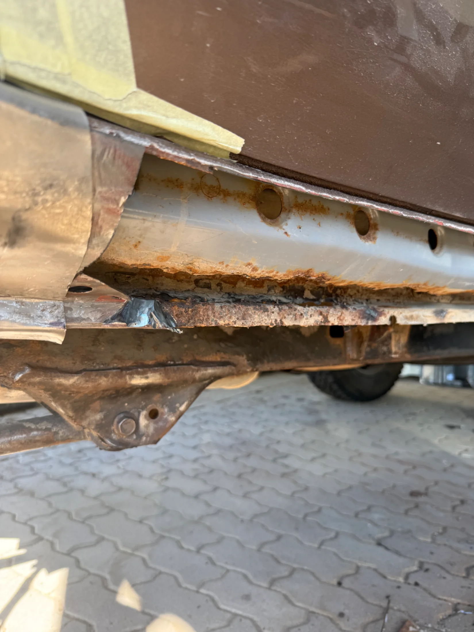

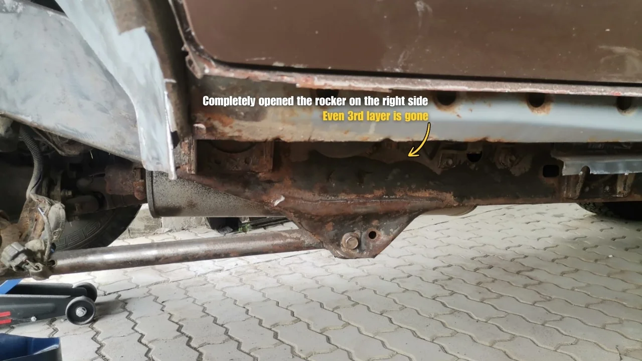

Cutting into the right rocker today… and yeeeah, what should I say? I went in hoping for the best, but prepared for the worst — and yep, we got the worst. You could pretty much carry the remains away with a shovel. It was completely gone.

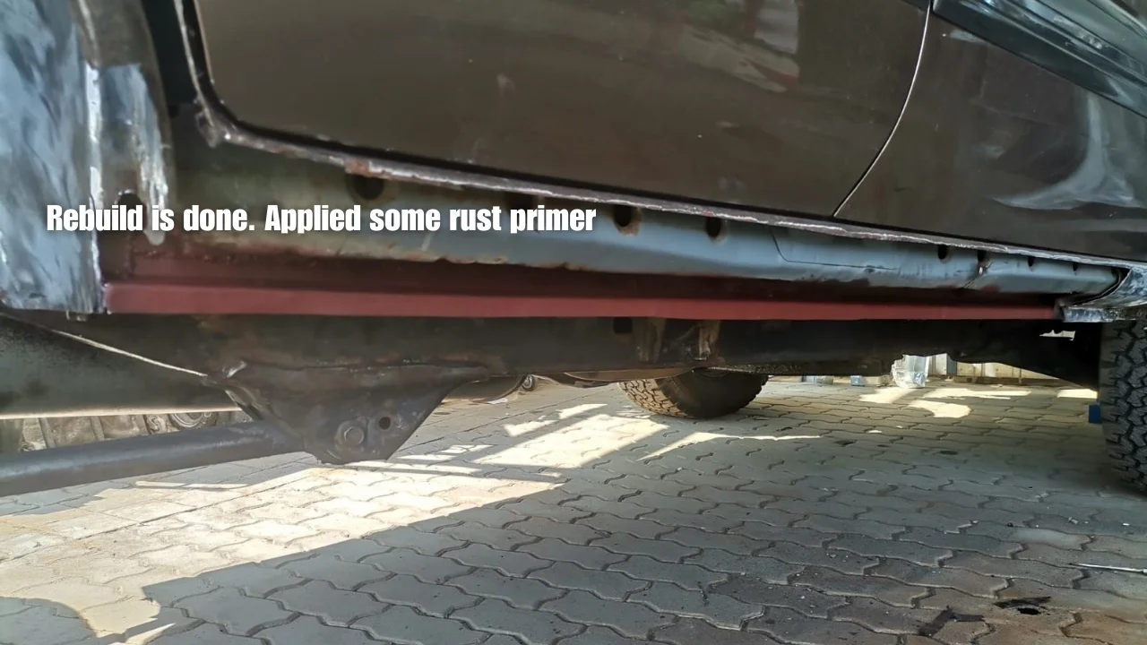

All three layers that make up the rocker had to be rebuilt. I started with the third layer, the deepest one. Shaping it was a bit of a pain thanks to the awkward curves and its location, but we got it done. Of course, I made it from scratch, doing everything I could to mimic the original design.

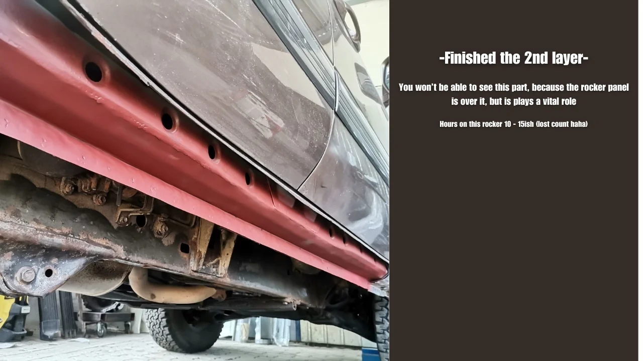

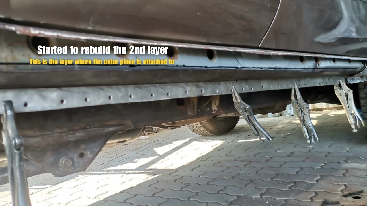

Once that was in, I hit it with rust primer and moved on to the second layer — the one right behind the visible outer rocker. Same approach here: copied the original as closely as possible, even though no one will see it again. Minor cosmetic flaws here are fine — it’s all about strength and longevity.

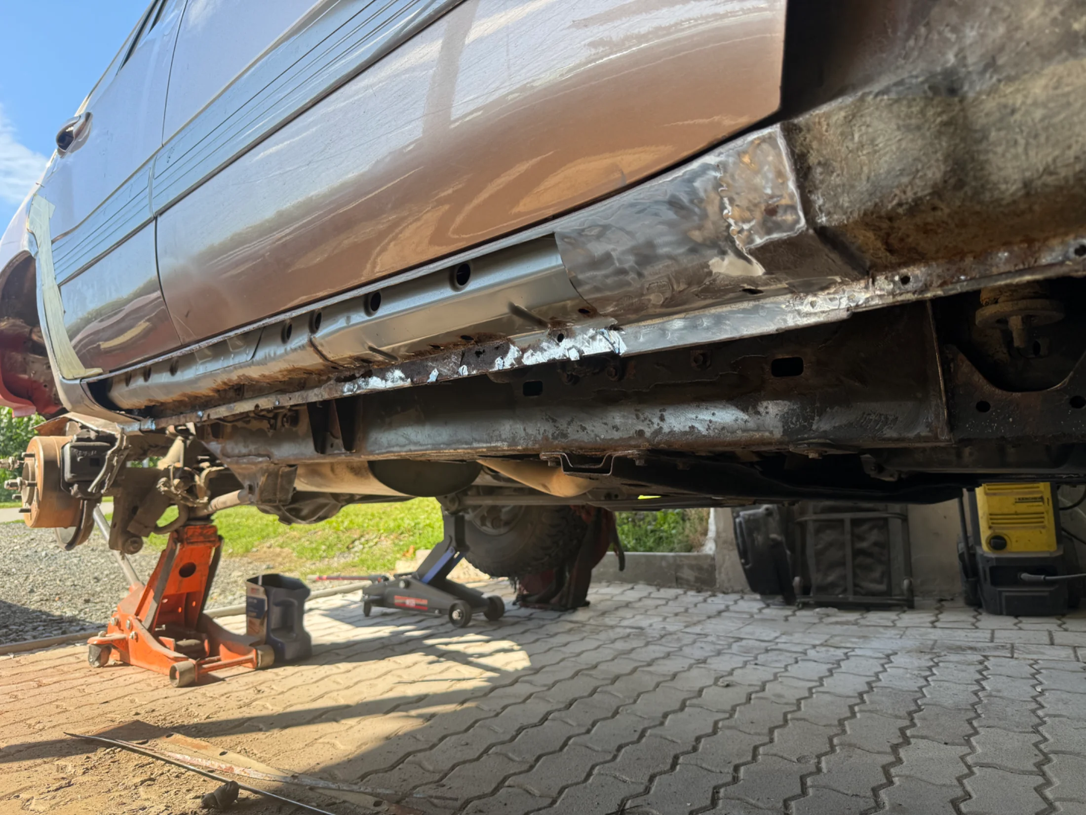

Tomorrow’s plan: outer panel (the one you see) and wheel arch. Let’s just say… the wheel arch might be hiding something interesting. You’ll see soon enough.
