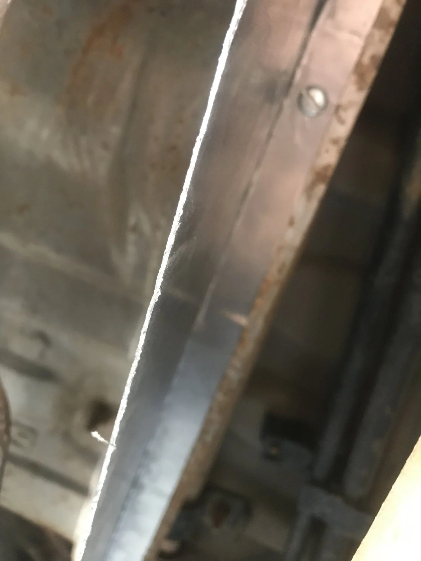

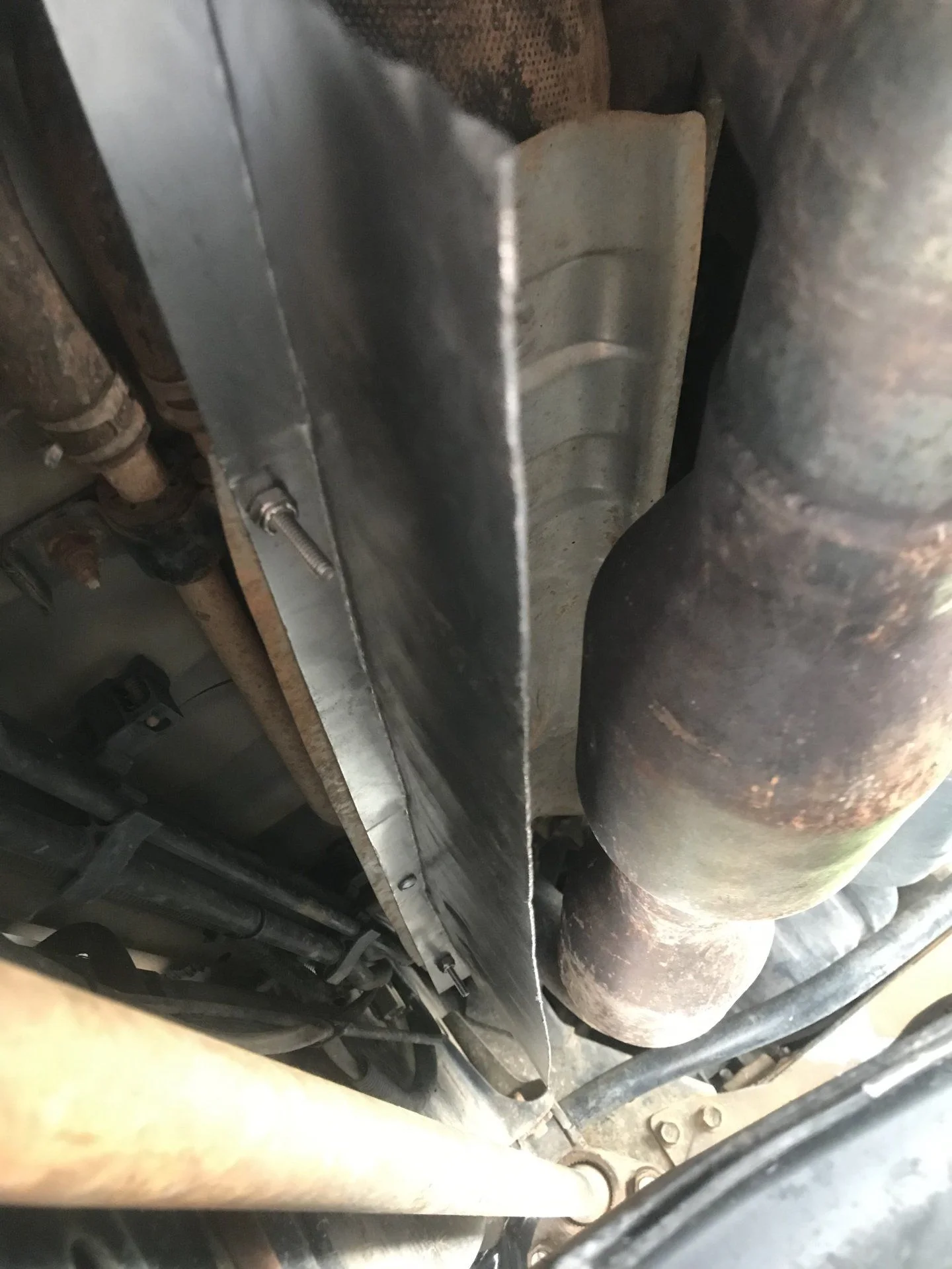

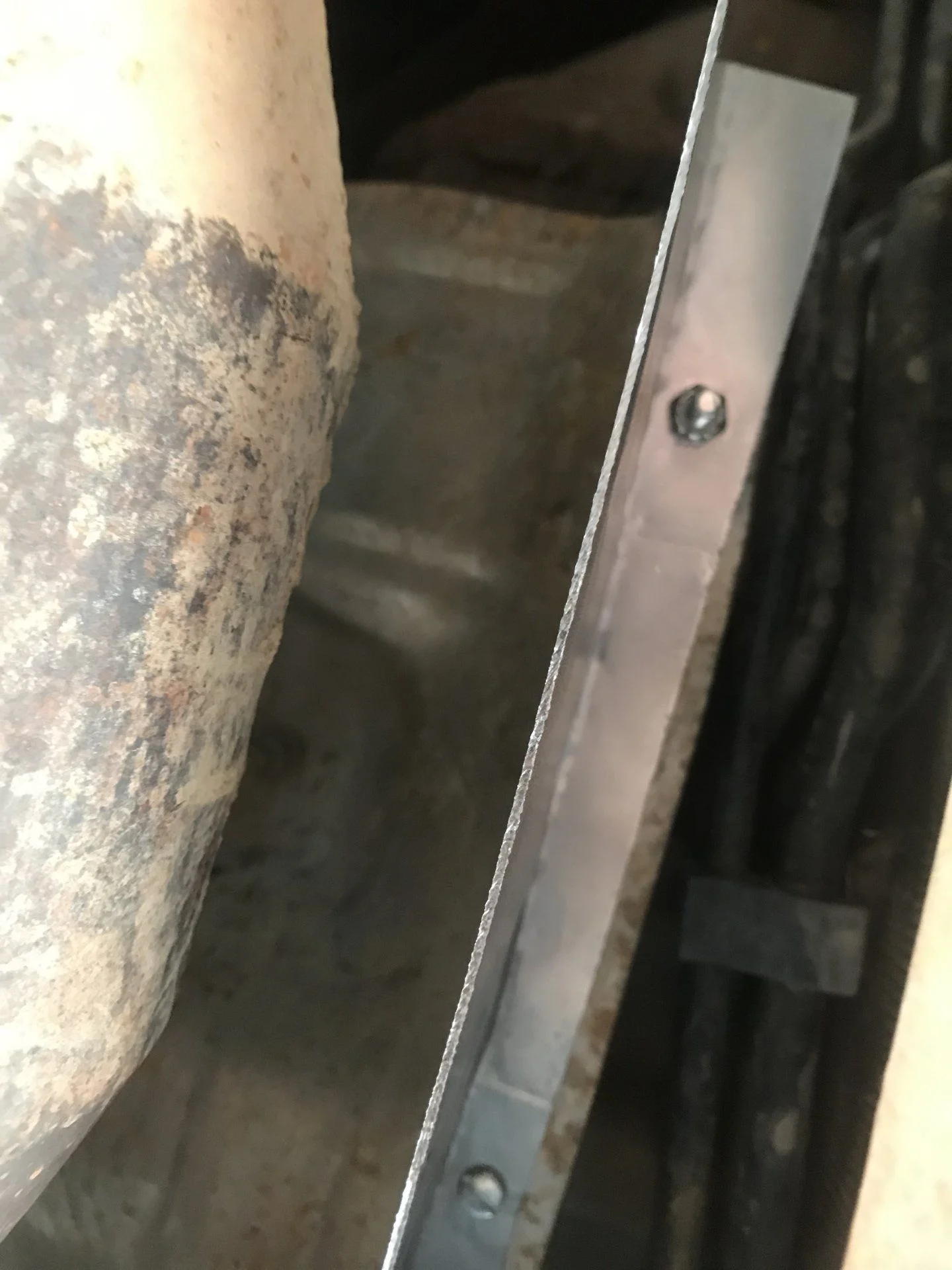

I have 2004 with same issue. I will be building the heat shield this weekend. Thank you to everyone who contributed to this thread and Toyota should do a recall.
And is the heat shield still working for everyone? @1meancruiser
Built the shield.

@savirc more pictures after work. My cats looks different because I have aftermarket high flow cats.
