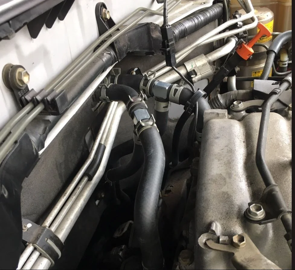

The black line on the right in this image is the fuel return line.
That line has to get hot. I will be wrapping that one. Thank you.
