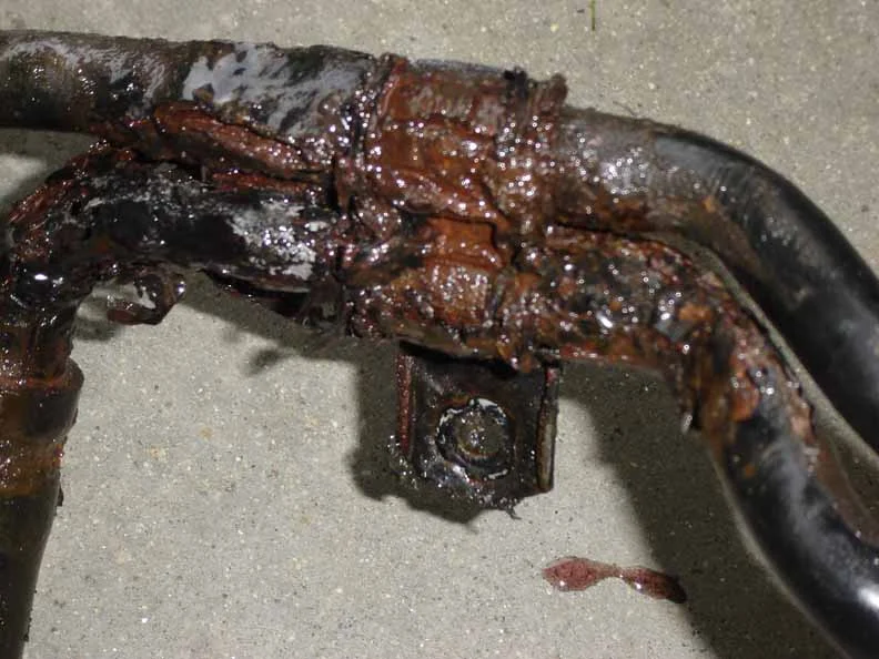

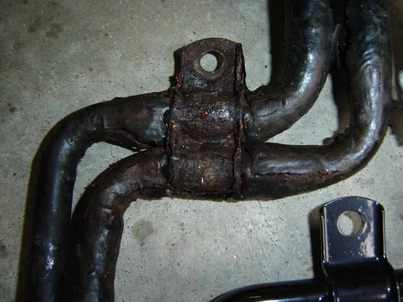

That's right, with a little luck you won't be wondering what to do with that free month of Sundays. A quick trip under your truck might reveal rear heater tubes that look like this. If so, happy days Fred because the tranny needs to come out for the repair.

my 62 is a northern import, wile doing the cooling system on it was was under it looking at very similar lines, I cashually rubbed a screwdriver across one to get off the scale and see the metal underneath and it split open
my fix for the 62 was bypass the rear heat, fortunatly this will be way down the road for my 80.
I didn't have to pull the transmission to change it.........;)

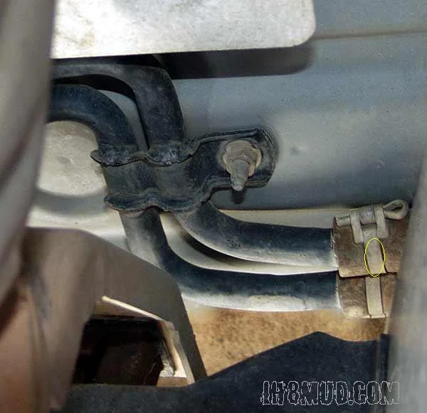

so, where exactly do we look for this thing?

They're actually in 2 sections. The front section bolts to the firewall right behind the head with 2 bolts, then travels along the tranny tunnel and turns right over to above the Catylitic converters where it joins to the rear section above the heat shield and then travels back and ove to the rear heater.
Even bypassing this bastid at the firewall will be a very unpleasant job as the nipples face down and are well behind the engine.
