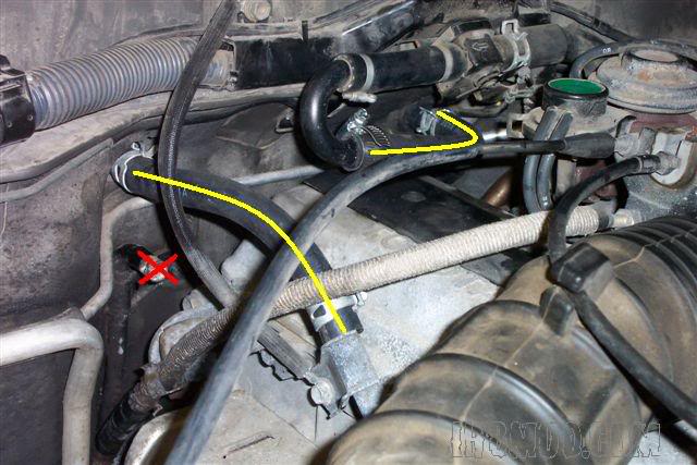

You could, but I suspect you'd lose a lot of flow through your front heater. My pic shows the Y pieces that fed both heaters changed to just feed the front heater.
Resurrecting this because I still can't quite figure out the RHH bypass...
Are the two hoses marked in yellow the two hoses that replace the stock 'T' hoses?
Red 'X' is one line that goes to the rear heater, but not clear where the other one is that gets unhooked.
