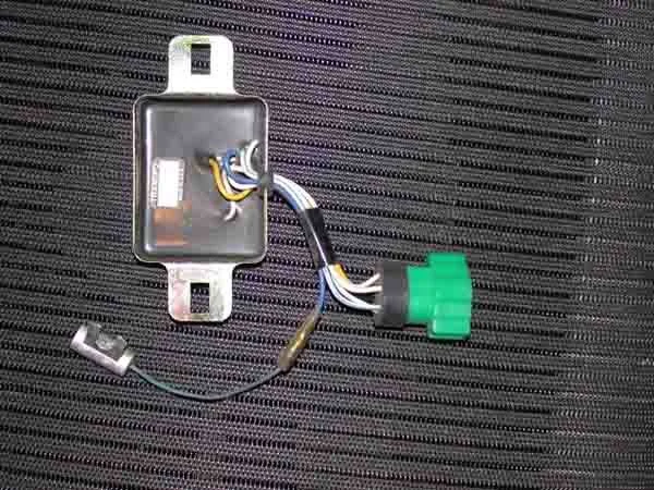

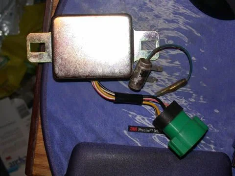

Ever burned up an alternator diode or had a weak electrical system due to the voltage regulator or maybe even had your vehicle parked while you went hiking or to work only to come back and have a dead battery because the contacts on the regulator had welded together and drained your battery. We'll I've experienced them all. If you are still using the factory alternator you might want to get one of these. I got it at the alternator/starter motor rebuild shop. My alternator had a burned out diode and they wanted to check my voltage regulator. I took both that I owned and they were both bad. I ran this one for a number of years without incident and no ammeter gauge bounce until I stepped up to a 200 amp alternator with internal voltage regulator.

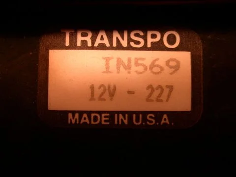

TRANSPO
IN569
12V-227

I hear you. This unit ran flawlessly for the 2-3 years I used it until installing the 200amp alternator. There is something to be said for not having that arcing mechanical contact. However, if it is the cause of problems in the field, a solid-state unit is not repairable but you can take your Swiss army knife and file the contacts, readjust the gap and probably have enough to make it home. Even though I'm a mechanical engineer, I'll take that solid-state device thank you.

That connector you see in the photo is identical to the one on the mechanical voltage regulator as far as interface to the harness is concerned. The only thing different is that some of the mechanical voltage regulators I've gone through had a clear plastic sleeve around the connector to enhance the water resistance.

This VR was purchased 2-3 years ago at the alternator shop for under $15. I do not know how many different harness connector styles Toyota used over the life span of the FJ. This VR has the same bolt pattern and the same harness connector. It is the same shop I went to recently when I decided it was time to switch to a gear reduction starter. The rebuilt GR starter was under $90 with a core exchange that I had picked up for cheap. This GR starter was rebuilt by the same house that MAF sells for $125. I think it pays to look at local shops for the support you need. I find that on average, the local shops are more than competitive with nationwide parts stores. When I had the factory alternator go out, the local alternator shop rebuilt it replacing bearings and diodes etc, and supplying the solid-state VR for less than a rebuilt alternator was at the AutoZone, PEP Boys and of course MAF & SOR.
I just got off the phone with two alternator shops here in Tucson. They both have solid state voltage regulators on the shelf that are plug compatible. They show two Transpo VR that are interchangeable - IN551 and IN569. The cost is $22. They also said that they can special order SS VR for LandCruisers back to the late 60s. So my question is, why would you not buy one that is plug compatible with a cruiser as opposed to buying one meant for another vehicle and change out the connectors with questionable results?

Did you not look at the photos in post #1?
