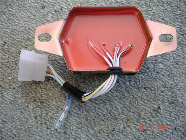

Anyway here is the solid state voltage regulator I've just bought from them for my 1979 BJ40 through REPCO here in NZ. (REPCO I guess is abit like NAPA in the States.) Cost me $86NZ but we're used to "paying through the nose" in this part of the world. (The cost of living in paradise :D)
Here are some pics:

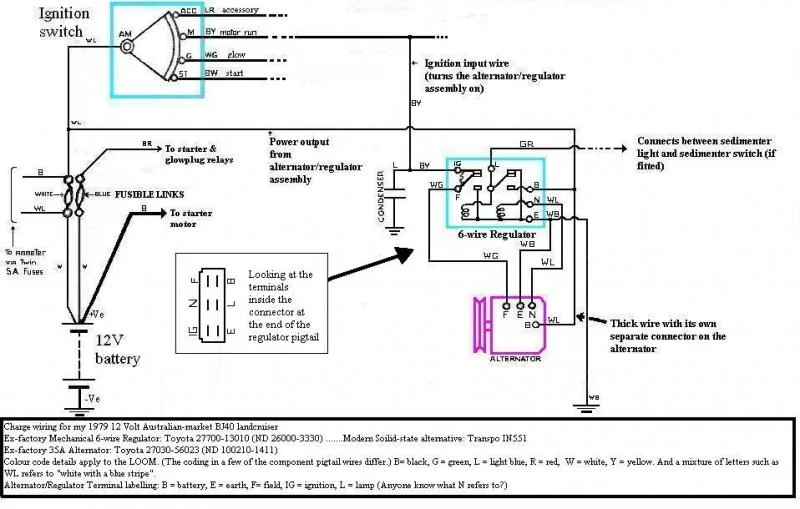

Here is the way I think my 1979 BJ40 is wired (as far as the charging system goes):
But I'm not 100% sure that the internal wiring of the regulator is correct as I've drawn it. Toyota seem to vary this according to which diagram you look at - and some clearly contain drawing-errors. (It would help if I knew exactly how the regulator does its job.)
Anyway - so that RGX2032 regulator is the down-under equivalent to the Transpo IN551 regulator.
