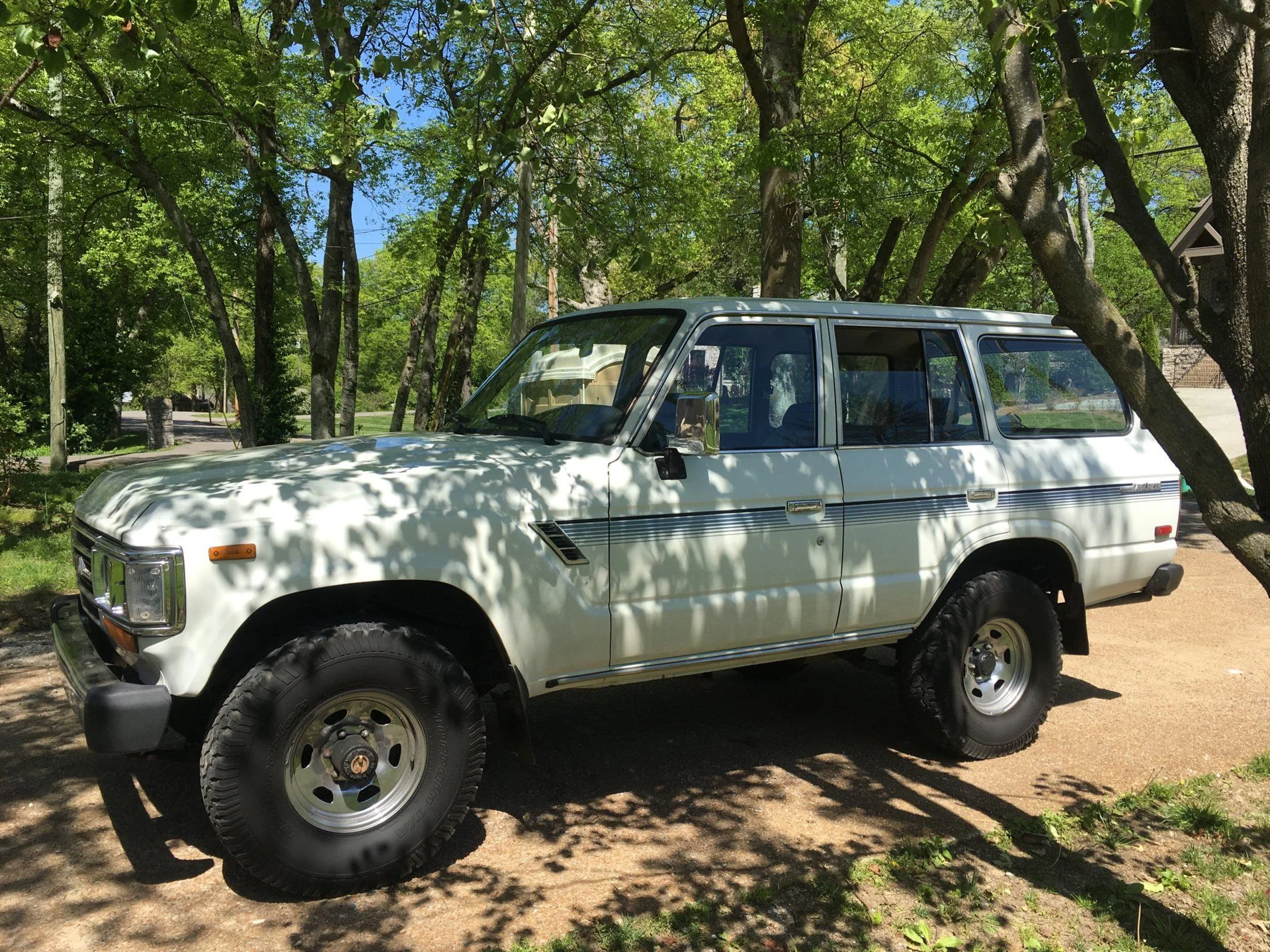

Not sure about doing any of those except for better lighting. I removed my AC, smog pump and associated air lines. Now it's really easy to get around the engine compartment. Recently looked at a 2F-in comparison it's a real mess in there. Improved fusible link, new seat foam and covers for front seats, extended seat brackets for driver's seat, ARB front bumper and custom high school welding class rear bumper are my favorite mods.
I noticed your rig-red?-has the stinkbug going on. Maybe a replacement extra large fuel tank would bring it down a bit and give you a greater range.
Wow, the smog pump and air lines is a huge job. Nice work!
Yes, I've purchased new carpet and plan to install this summer. I've already inspected the entire floor and repaired the minor rust (welded new pieces, primed, and then coated the floor with bedliner). The driver's seat is a wreck and reupholstery is planned after I make sure it is operating well after a few months. Yes, that is my ref truck with the stink bug look.
A long-range tank would be incredible especially because I drive down to New Mexico all the time! That's kind of hard to sneak into the house without my wife noticing...)
