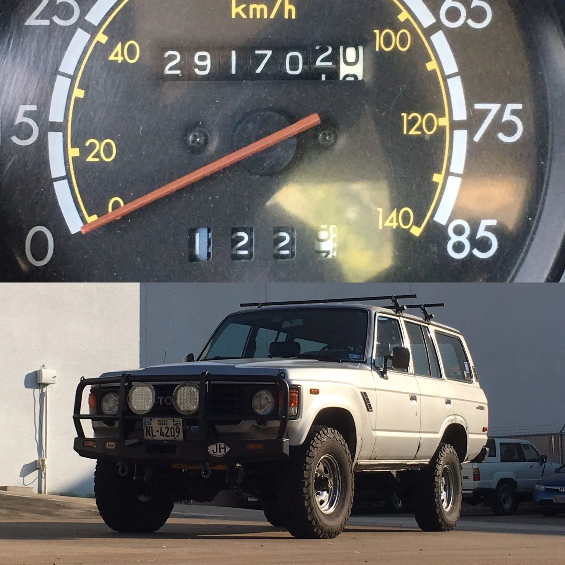

I've spent 22,000 miles daily driving my 87 60 series. I bought it with 277,000 miles on it. It was bone stock. A cracked exhaust valve, 28" Highway tires, a dead suspension and some rust.
I can now get it in it with complete confidence and drive anywhere. It has never left me, tried to not start or had an issue. My wife is now begging me to trade her cars on Fridays.
If I had to rank the updates I've done, this is how it would go:
1. ALL OF THE OVERDUE MAINTENANCE
All of it. All the rubber hoses, leaks that have gone overlooked, all the noises that you turn up the radio just a little bit to ignore. They will dam up, and you'll get stuck.
For me, it was the following:
Cylinder head refresh to get the engine back to 95%.(I still needed work on it after all this for fine tuning) Its pretty close to factory compression still and it uses minimal oil.
All the hoses. Coolant, fuel, oil cooler, delete rear heater (Subjective to area). All of my stuff was starting to bubble and go.
Complete cooling system. When you break coolant, do it all at once. I tried to avoid the hoses after the cylinder head refresh and it warned me by pissing coolant a few times before I replaced all of it again.
Fuel system hoses. All original and dry rotting. Huge safety bullet that I dodged.
2. Fresh suspension. Doesn't matter which one. Completely changed the truck. Considering how two of my springs were broken at diagonal ends, and my shocks were blown...also my rear shock crossmember failed eventually...it was all needed.
I ended up with CS005F and CS005RA/B. I've got front to rear rake which levels with load and no lean. Im happy. I used Bilstein shocks and I really like it.
3. ARB Bumper. I fear nobody on the road, and they will not cut me off. Winch is optional, I added it. May never use it til I need it. I can live with that. Mine was the old style and used so I get patina points.
4. PFRAN Led lights inside. So simple but made it much more functional. Also get the back up lights. Well worth it.
5. CityRacer Fuji Carb. I tried a stock unit that was rebuilt by the PO, A trollhole carb that currently collects rain water, a stock 200,000 mile carb and the FUJI. The CityRacer Fuji has a very clean transition between all three circuits and starts quickly. I'll never put any Chinese junk on my truck like that TH carb again. Honorable mention to the JimC rebuilt carb but I was on a time crunch.

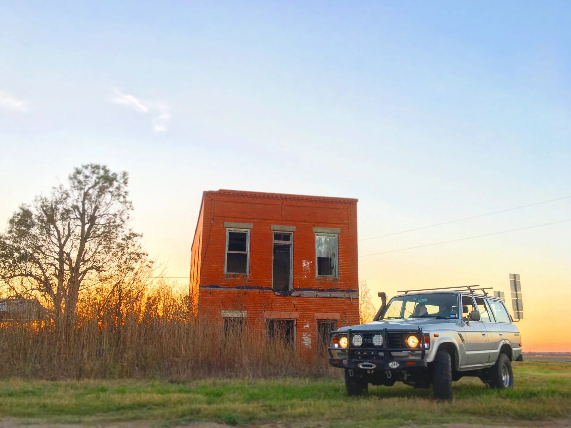

Hey Alex what tire are those?
33x10.5-15 BFG K02's
Nothing fancy. If I lived anywhere else but Texas, I'd have 31" MT's.
Honestly, My well tuned 2F and 3.7 gears has no problem holding speed over some of the big bridges and even throughout Big Bend.
