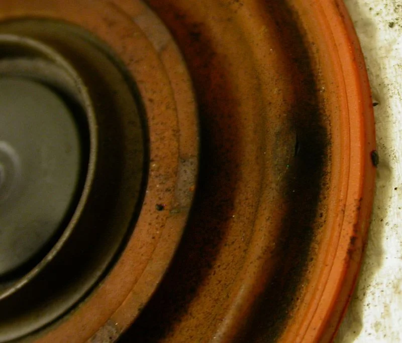

the bottom port of the modulator is exhaust pressure, were the diaphragm to get a hole in it then exhaust could get into the upper portion of the modulator, this usually shows up as carbon that people find in the modulator, in the winter I could see it condensing moisture out of the exhaust gases but it would smell like exhaust.
moisture in a vacuum system in the winter will wreck havoc,
my modulator also had a hole in it, hard to see in the pics but there is a pin hole leak
