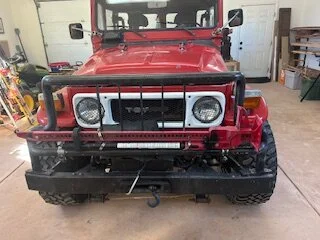

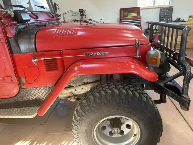

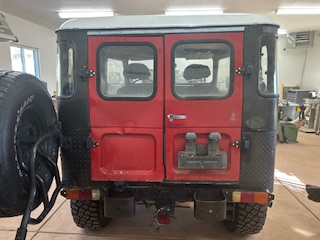

Just bought my first Landcruiser. I am sure this is a dumb question, but I'm asking anyway. I am trying to figure out exactly what I have. It was listed as a 1979 but There are multiple vins/identifiers on the rig. Can anyone help me to figure it out?
It was imported from Canada last year by the guy I bought it from. I am pretty sure it is a frankenstein rig, but for parts I figure I need to know what I have :
The canadian vin was JT3BJ42C2E0006463. Which is a 1984.
One plate says BJ40-033741 (This would place it as March 1965 per this post Pre-1980 FJ40 VIN Information - https://forum.ih8mud.com/threads/pre-1980-fj40-vin-information.755288/post-8680150)
On firewall of engine it says Model BJ40LV-KCJK (which says March 1978-July 1980 per Toyota Land Cruiser - BJ40LV-KCJK complectation - Auto parts - https://toyota-usa.epc-data.com/land_cruiser/bj40lv/3674/?color=309&trim=LP11)

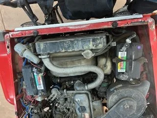

The engine is a 3B Diesel Engine with a giant 3B cast into the block (1981-84 era?). but the firewall plate says it is a B engine. PRetty sure the engine was swapped at some time before coming to the USA.
Is there a good guide out there to know what is what or which parts are interchangable between years? How do i decide which date takes precedence?

First BJ40 is introduced in 1974, so that´s not right. What´s the VIN number stamped on the frame?

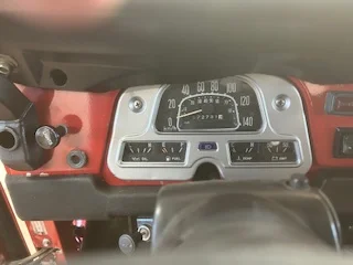

Dash is not 1984, more like 80-82, as the bezel too. How´s the frame, Ø 25 or 35 mm spring ends, 1 or 2 bolts in the solid end spring pin? So small pictures that I can´t see.
