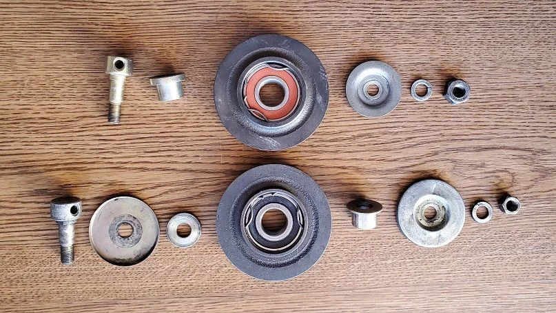

On the cast pulley I've seen two different flavors. One with a heavy, small dust shield on the outside, no dust shield on the inside, and a 19mm nut. A second has thin dust shields on the inside and outside, and a 14mm nut. See pic. The orange bearing is a Nachi 6204NSE with the single outside dust shield. The black bearing is a Koyo 6204RS with the double dust shields.

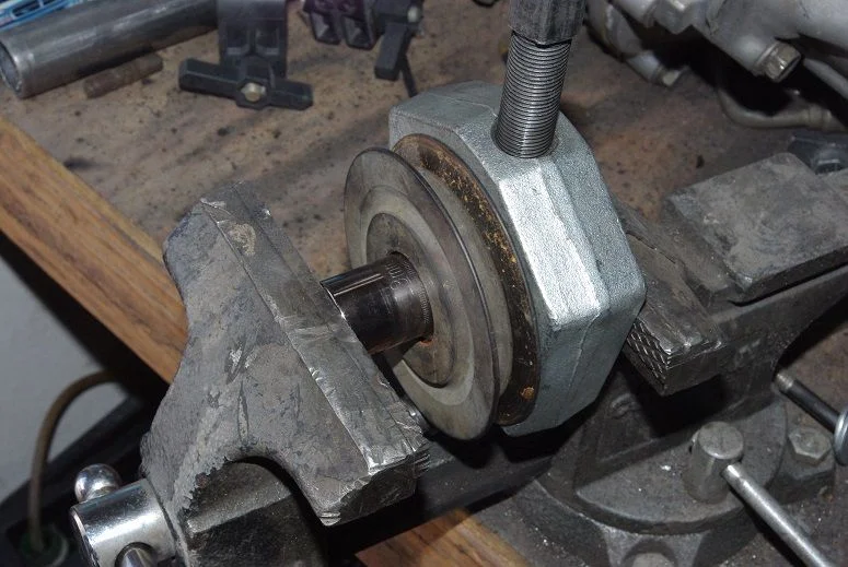

Replacement is pretty easy, but you do need tools like sockets and a vice. You don't need a fancy 20T press. Before the bearing can be pressed out you need to remove the spring clip ... you can see it in the pic. A screwdriver works well. After that clip is out the bearing can either be pressed out in a vice or hammered out. In the pic I straddled the pulley in a vice, placed a socket on the bearing, and LIGHTLY tapped it out.

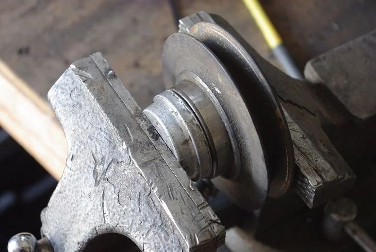

For install I never hammer it in. I used the vice to squeeze it in. When you press the bearing in you want to drive it in pressing on the outside of the bearing, not the inside. In the pic I used a bearing seal driver ($40 for a set at Harbor Freight) on the bearing. You can also use a large-size socket.

Pic of the two cast pulley choices. Top row has the 19mm nut and the single outside dust shield. Bottom row has the 14 mm nut and double dust shields.

Bearing removal is easy and a fancy 20T press isn't necessary. A vice will do just dandy. Don't forget to remove the snap ring. You can either press the bearing out, or use a BFH. First pic is pressing out the bearing with a socket, backing the pulley with a gear puller.

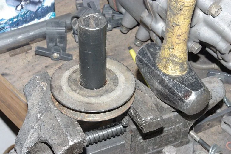

If you hammer out the bearing it's easier to get the bearing started first with the socket and vice, then place the pulley on top of the vice to hammer out the rest of the way.

For the install you want to press the bearing in, not hammer. Make sure the socket used to press in the bearing is the same diameter as the bearing. You don't want to load the inside of the bearing, press from the outside. In the pic I used a seal driver.

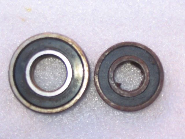

Note that the cast pulley uses a larger bearing. Here are the two side by next.
