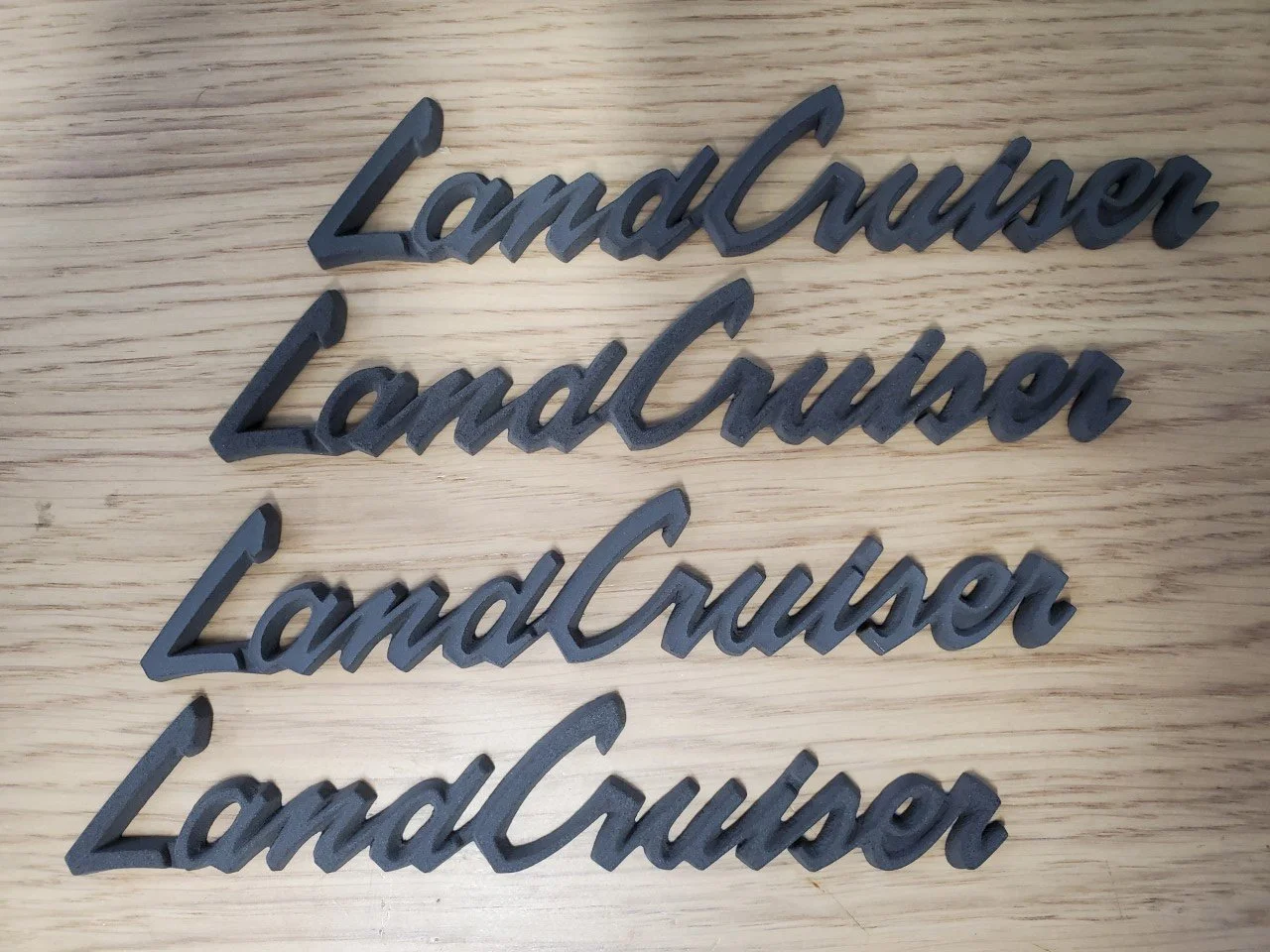

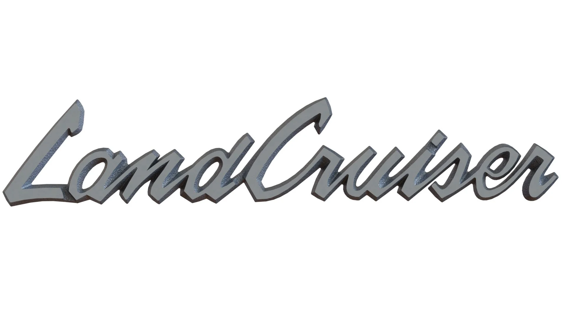

Sorry guys, took me a few. This is ready for me to 3D print to verify shape and mounting boss location. Not long now. Still planning to share the file as I've done before. Thanks to @scrapdaddy for the loaner (and again sorry for the d-lay). Calvin

Here is what I know: I've built several 3D printed prototypes dialing in the front script and the posts on the backside.
I'm realizing that even if I nail the distance between posts (which I think I have within ±1mm) there is no guarantee that the distance would remain "right" in the final metal 3D printed version. Parts shrink and warp slightly during print. Posts that are close but not quite right render the part useless... in fact I've heard that very gripe about the aftermarket solutions out there.

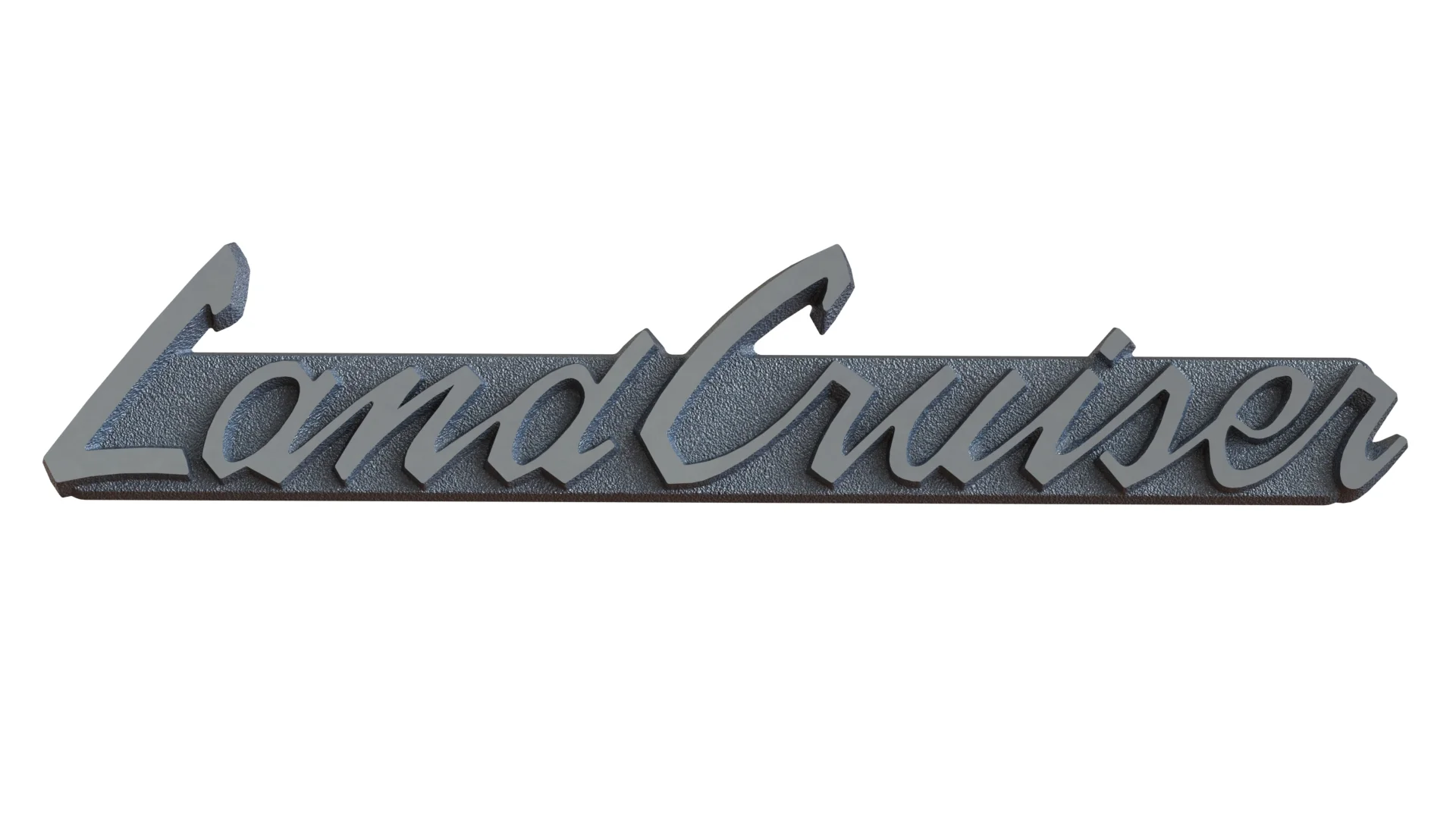

Weighing different options and tradeoffs, I feel like the best move is to use the aforementioned Very High Bond (VHB) tape to affix the emblem to your truck. But there's a catch here - this particular emblem has extremely limited area to affix the tape. If it had a rectangular backer, like this newer emblem, we'd be golden:

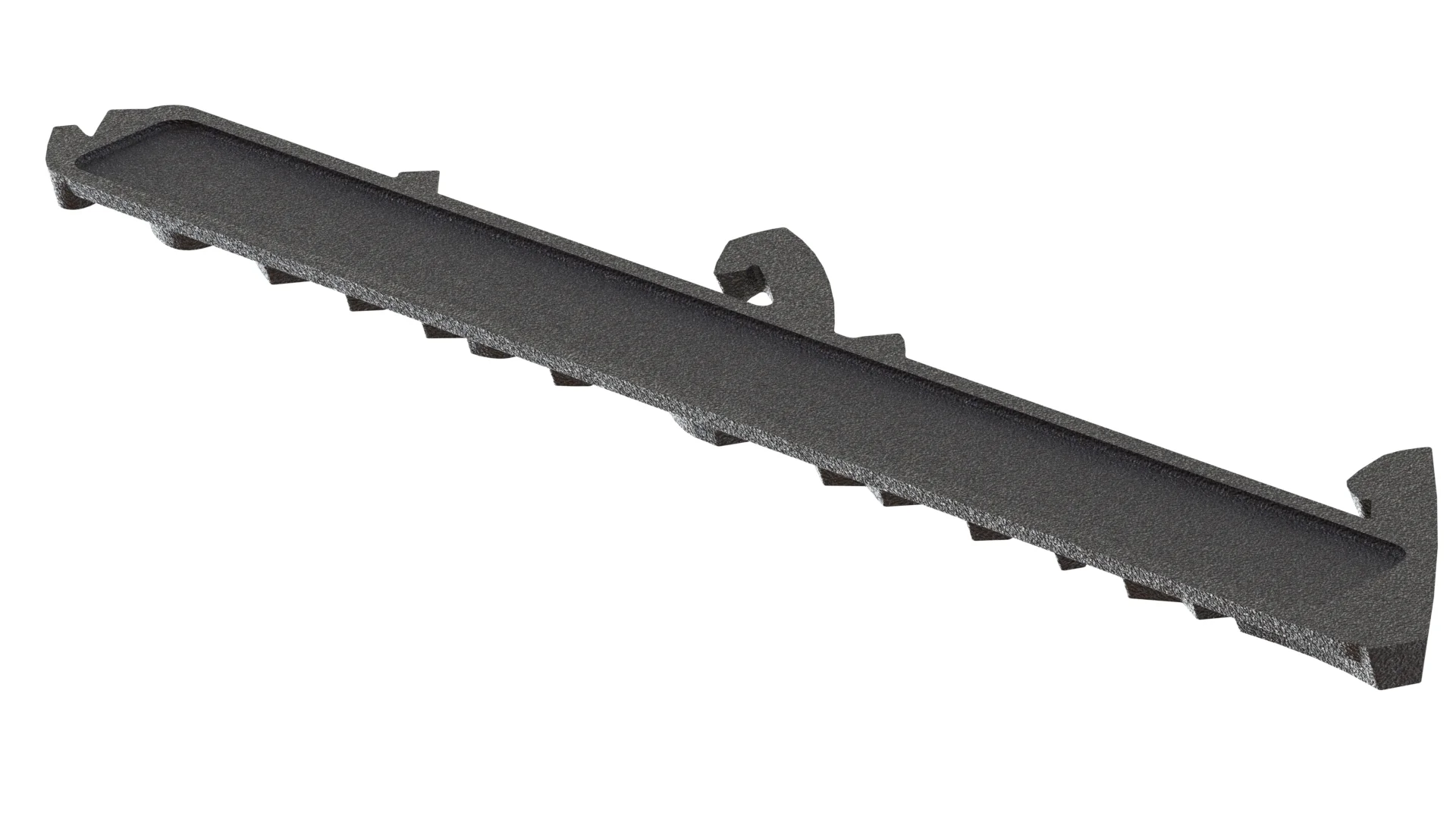

Giving it a shot. I'm modeling in a bezel similar to the newer badge. The purists may feel this an unacceptable deviation - in response I'm glad to offer up the version with posts as well. Regardless, here is what I'm proposing:
The backside has a .030" recess, that's just over 1/2" wide. So a nice unbroken strip of 1/16" thick VHB would live in that gap and stick 'er on to your fender.
Is this of interest to everyone? Hit me with feedback. Again the plan would be to offer these up on Shapeways (or similar) for metal 3D printing.

They all look great and I'm pretty far left from a purist, so I'd rather adjust the mounting holes with a rat tail and a little two part epoxy glue on the studs. The old style script is just so cool I would hate to give that up.

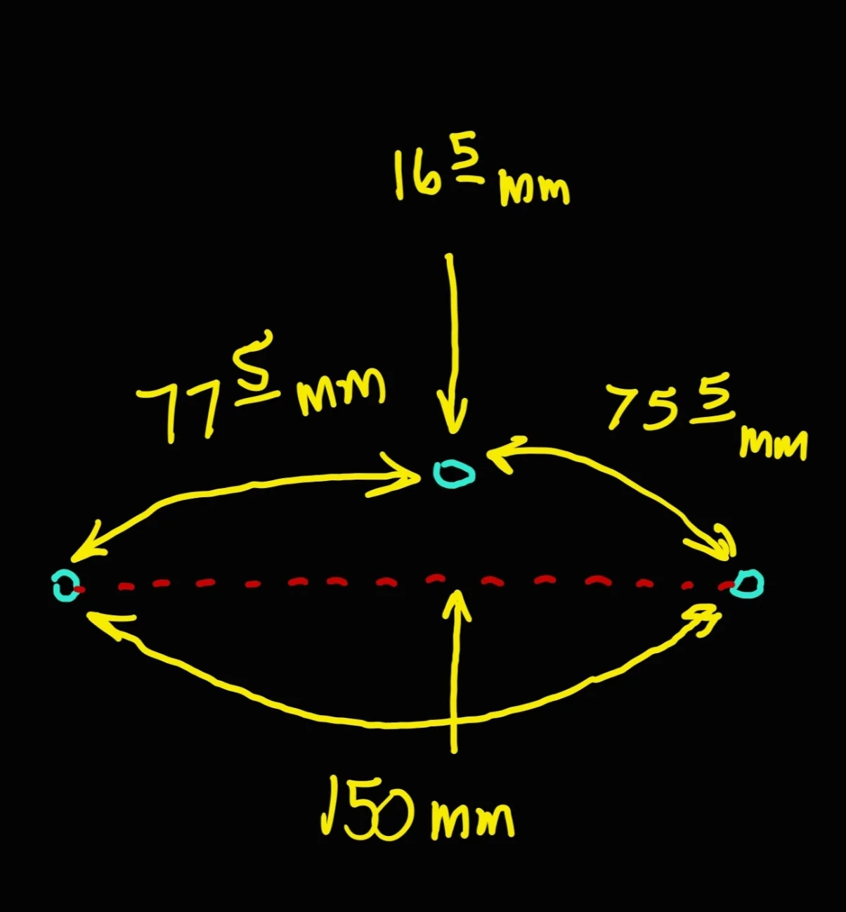

The challenge in getting correct spacing is I only have the emblem to measure, vs the fender. I believe my 74 piggy sported different emblems and the holes are not the same, but I'll double check
Anyone out there have access to those mounting holes (ie a fender with no attached emblem) that could verify distance using calipers? You can measure edge to edge then add a hole diameter. I'll post up my measurements tomorrow, but it'd be nice for someone to verify.
Thanks.

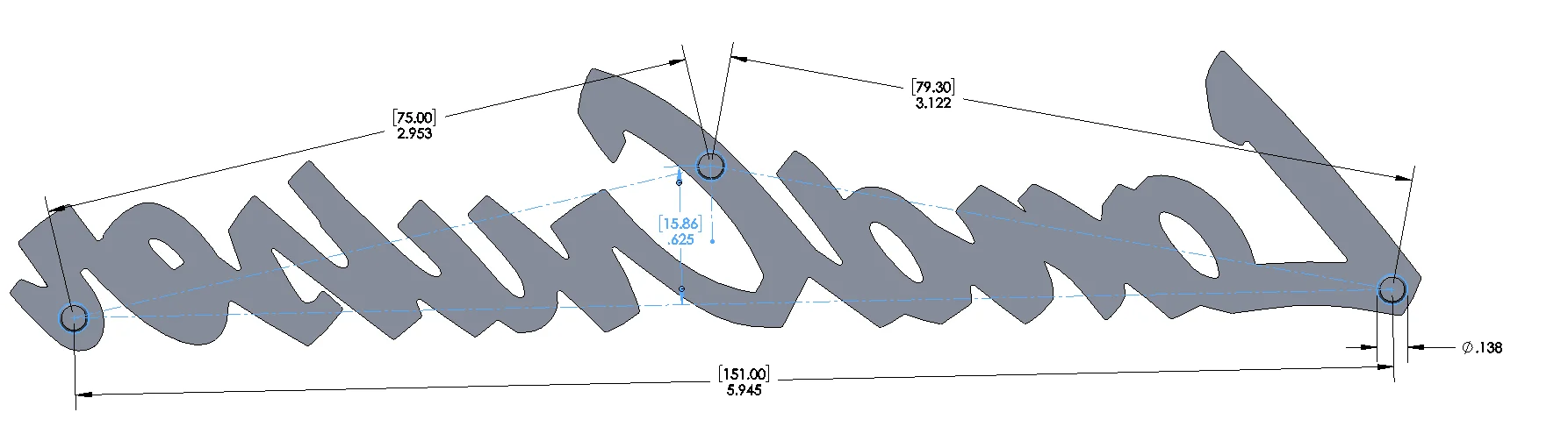

Hey Bob, were you able to pull some dimensions? Here is what I settled on by measuring the emblem - the dimensions are listed in both inches and [mm]:
Those are my measurements from the cast metal OEM emblem Ron let me borrow. Now... what I could use from you is to measure the actual spacing of the holes on the (steel) fender. Make sense?

I am impressed with the digital rendering of the emblem! How does one do the scan to digitize the part?
