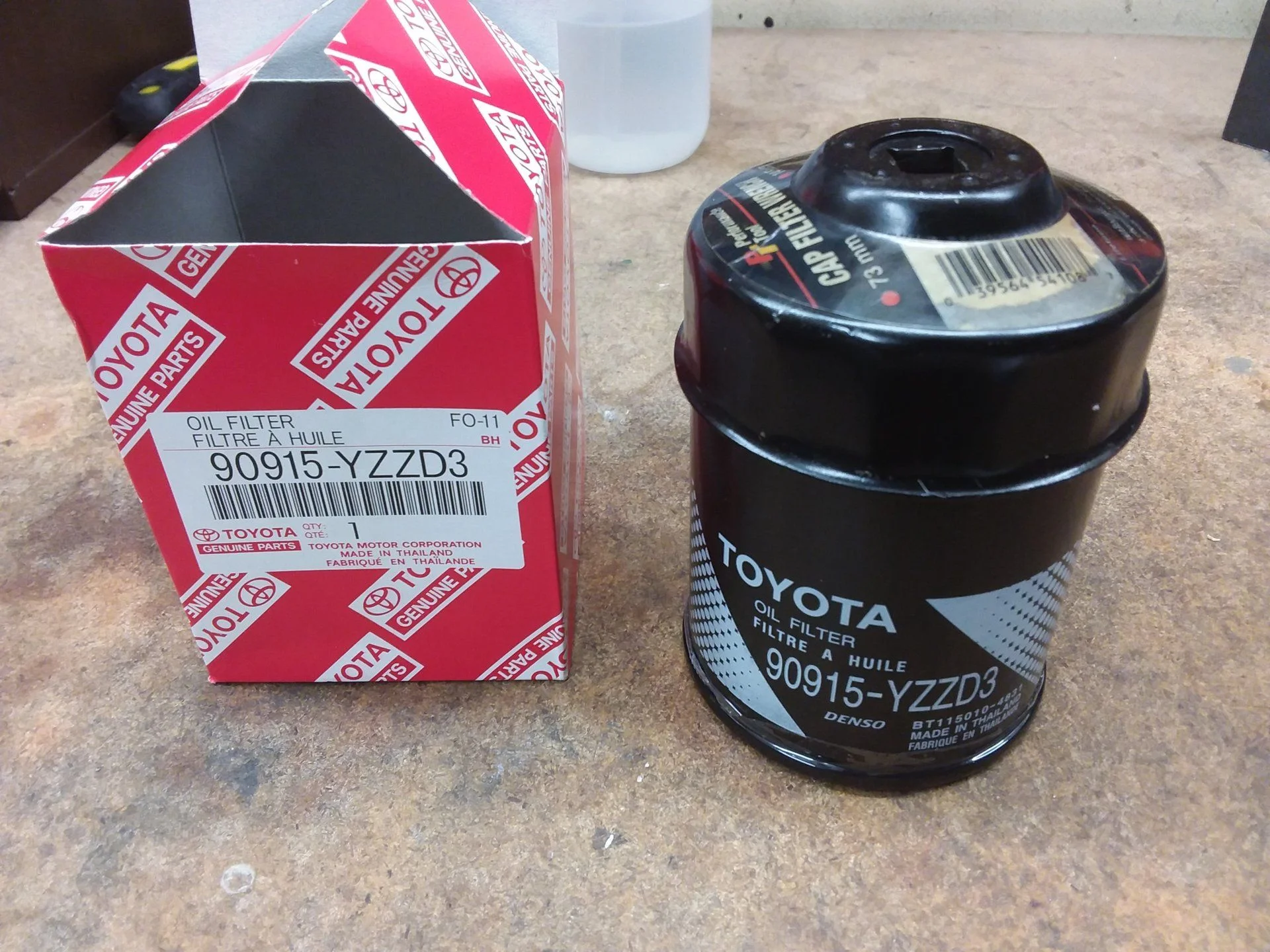

Tried 3 different auto parts stores an none have a cap wrench that will fit this filter. Can anyone make a suggestion?
Try your local Toyota dealer. I think they have these on the end caps in the parts department.
I use the YZZD3's too and should actually buy one.

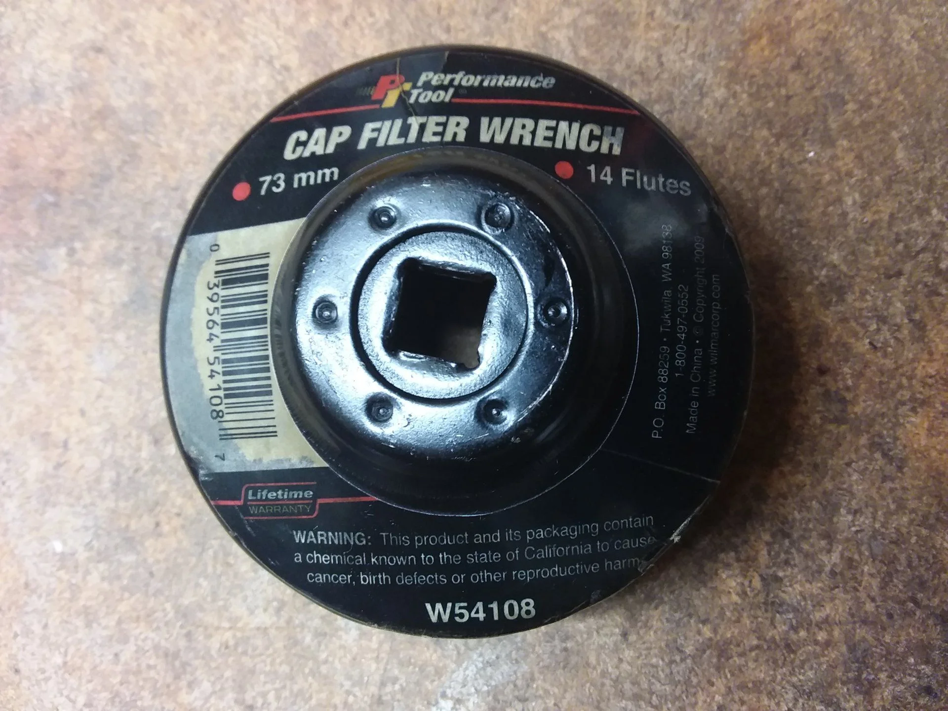

THe 73mm 14 flutes is what you need. Multiple available on Amazon if you search.

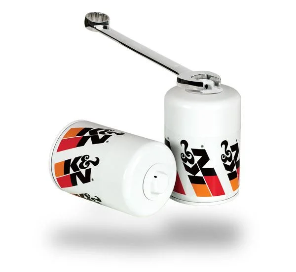

And for those who want to be able to pick up a filter, anyplace, any time:
Blasphemy....I know (non Toyota part), but they are good filters.

I found this, different part number but 74mm 14 flute...should I purchase?
w54078 PT Performance!
