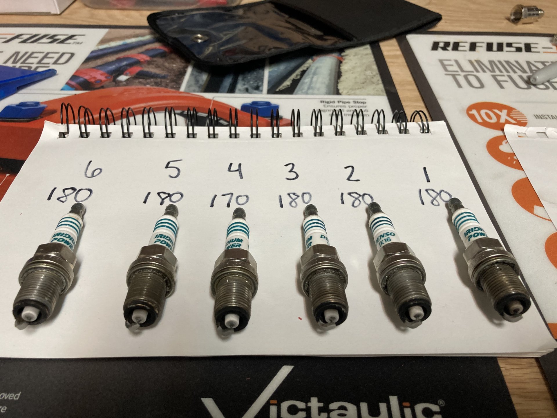

So, curious to see what y’all thing of these numbers. Engine was warmed up.
