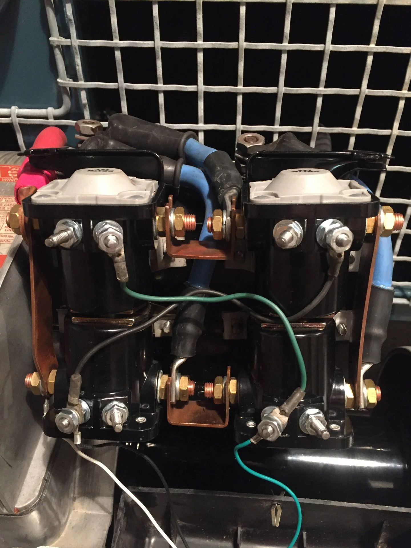

My winch was running one direction but not the other. So I bought a pack of 4 solenoids (BB1714) described as for early Warn model XD9000. Now a can’t get it to run at all. I have checked all the wiring and connections (they are the same as when it was working and every other internet pic I can find) and there is power and continuity everywhere there is supposed to be; good ground etc.
I replaced the solenoids with the same style that was on it and what came up when I searched for 8274 solenoids.
I note that the normal method of applying power/ground to the two lead posts does not produce a “click” (didn’t on my old ones either and I know at least 2 of them were good because it ran in one direction. So am Itesting them wrong?
I have a 3 wire controller socket (that worked with the previous set-up) but my controller has 5 pin. Is it possible that these solenoids require the five wire socket/wiring?
It it possible I bought the wrong solenoids? Here is a picture up it.

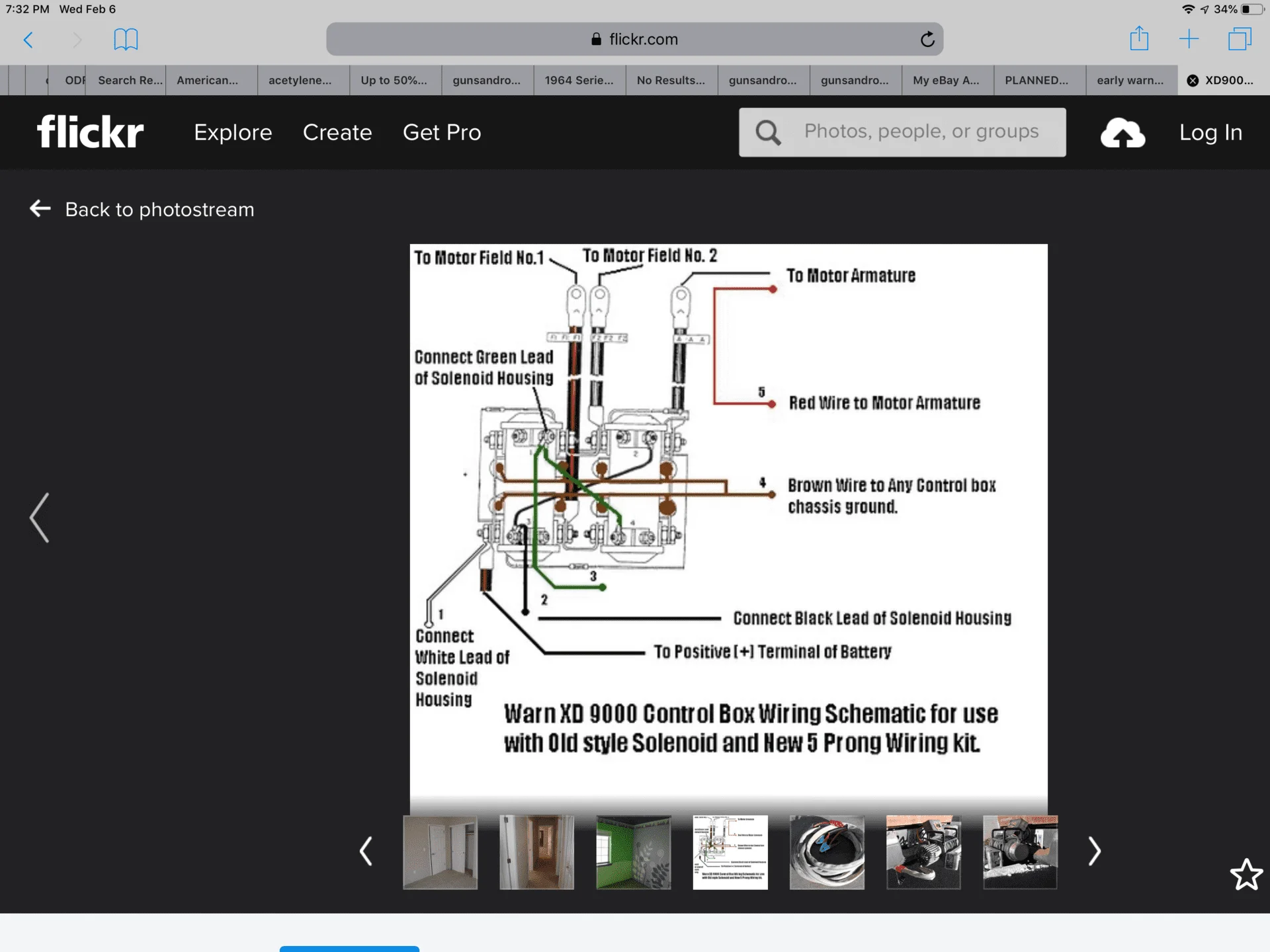

I know on mine you have to run power and ground to the pulling circuit of the solenoids. Thats not what your diagram shows.
Saw your pic. The wiring is the same. Small terminals are pulling, works just like a relay.

The wiring i showed is what i use on my three wire controler.

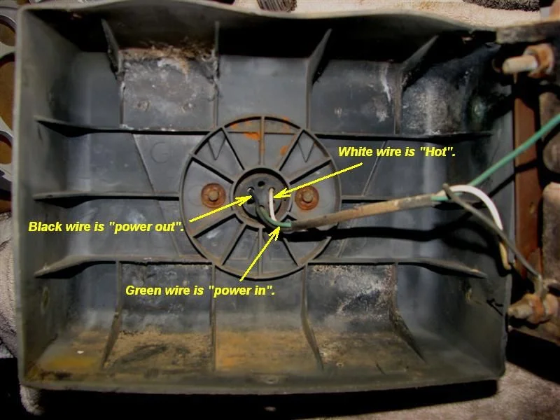

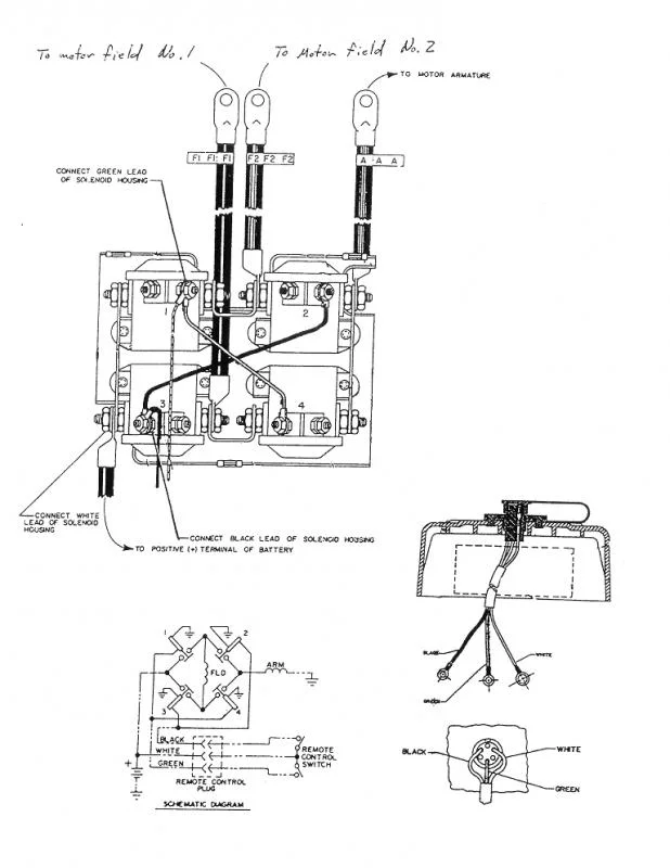

1. It appears that the green control housing wire should be on solenoid #1. Warn sent me the above diagram too. Looks like it may work the same in either position.

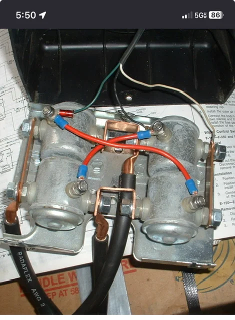

Winch was rebuilt and wired by Herm the overdrive guy. His wiring on his site shows solenoids with all single posts. This is how he wired mine.
Not sure it's right.

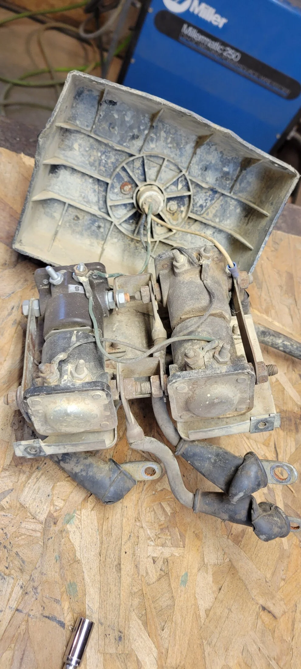

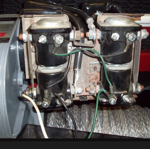

First two pics are mine, rest are examples.

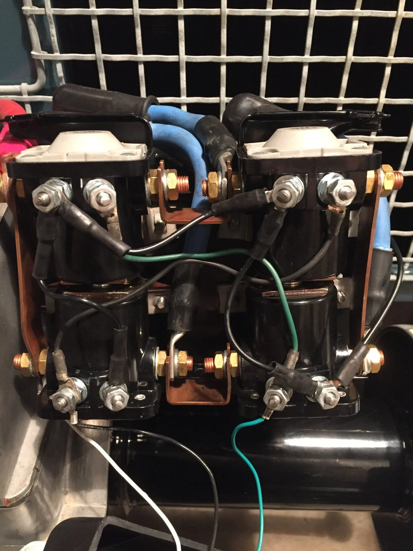

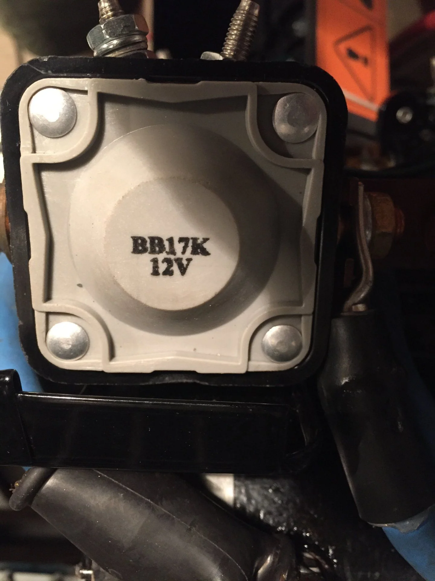

Here's a pic of my solenoids b4 I disassembled and rebuilt my 8274. I replaced all the solenoids and wired it the same way
with nos ones I had purchased yrs ago.
