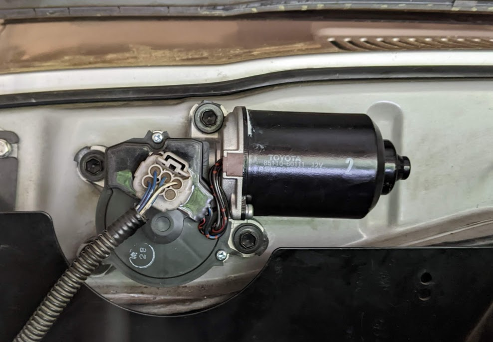

Yes, 60111 works and I am using it. Here it is installed on my 1996 LX450
