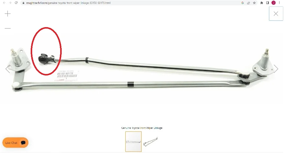

Getting ready to try swapping in a new 85150-60101 link set into my 94. The motor is fine. Looking at schematic it not clear to me how the link and bars attach to the motor.
Can anyone experienced tell me how this attaches to the motor so I ready when pull it off? Nut?
Thank you.
Thank you.
It snaps on.
My original one was very difficult to snap off, probably due to age and also because I didn't know how it attached. You'll need to pry it off the motor arm until it pops off.
