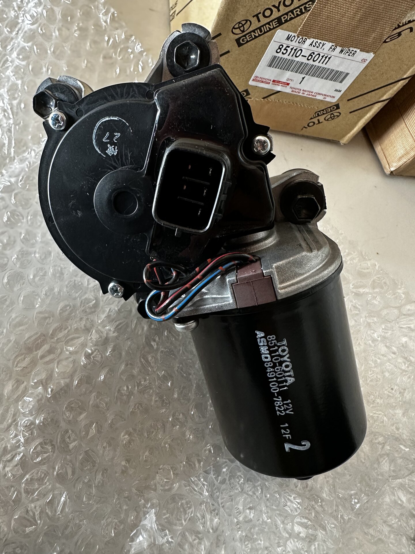

Motor: Toyota 85110-60111 (8511060111) MOTOR ASSY, WINDSHIELD WIPER - https://www.amayama.com/en/part/toyota/8511060111 $241.68 with some available from Japan, $353.34 with 5 available from UAE.
Linkage: Toyota 85150-60101 (8515060101) LINK ASSY, WINDSHIELD WIPER - https://www.amayama.com/en/part/toyota/8515060101 $136.59 with 10 available, $156.20 with 175 available, both UAE.
I'm not talking about the part numbers listed for the US market. I'm telling you that there's an option for the *general market* that's still available and @SNLC appears to have just confirmed that both work on US market Cruisers.

Toyota 85110-60111 (8511060111) MOTOR ASSY, WINDSHIELD WIPER - https://www.amayama.com/en/part/toyota/8511060111 looks like the correct part from the pictures.

I won't replace until I have reason to, but this is for @Kernal comparing the new wiper motor with an og unit from my '97 as it sits under hood today. It looks about right.
