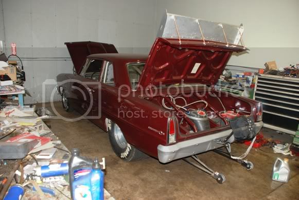

i took a few pics of his '67 NOVA while i was hanging out waiting for the stain to dry.. just thought i'd share.. :cool:
