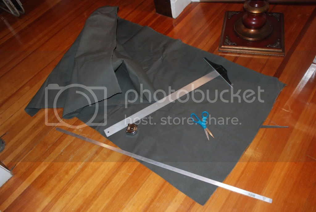

the materials are canvas.. 3/4" wide aluminum stock.. a
who can sew.. velcro..
i figured the length i wanted them to be.. about 42" long.. generally the length of the inner lip of the tub up to where it starts to curve.. had my lovely fiance sew in a channel for the aluminum channel stock to slide into..
then i inserted the flat bar and sewed it in there.. the next couple steps i forgot to photograph.. no big deal.. but i then fitted the channel and drilled holes thru it to line up with the holes for the hardtop.. fast forward to today.. it stopped raining so i can get it mounted and take a few pics..

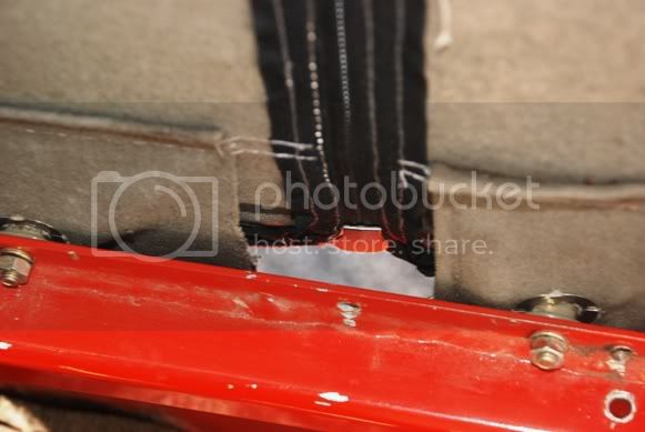

so this is what it looks like..

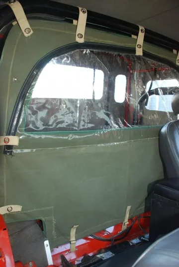

and here's what it looks like from inside..

i think this will help cut down on the breeze a lil'..
whadya think?!
