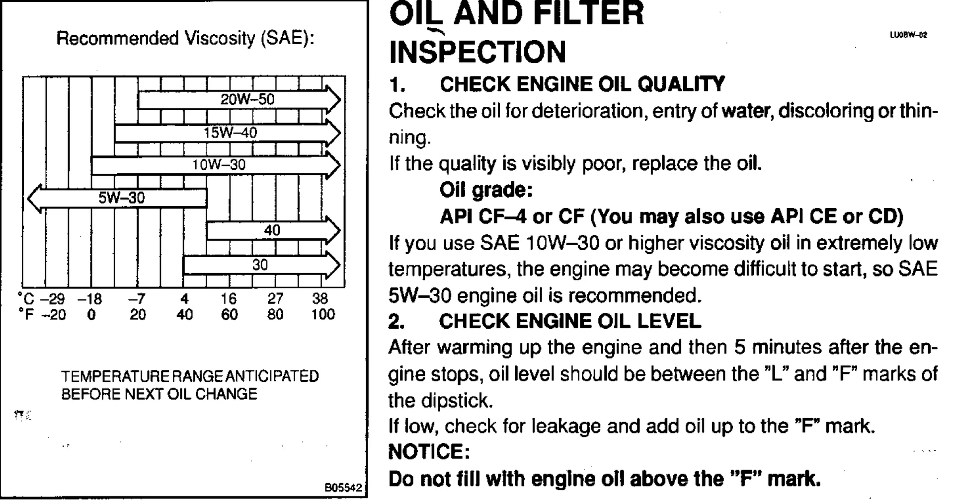

Thanks for the post, i am from Alberta too , what kind of Engine oil you using? do you switch oil type between summer and winter?View attachment 3508557
I do switch. I run Rotella 5w in winter and 15w in summer. Sometimes 10w in between, depending on the weather and my interval. I log a lot of miles.
