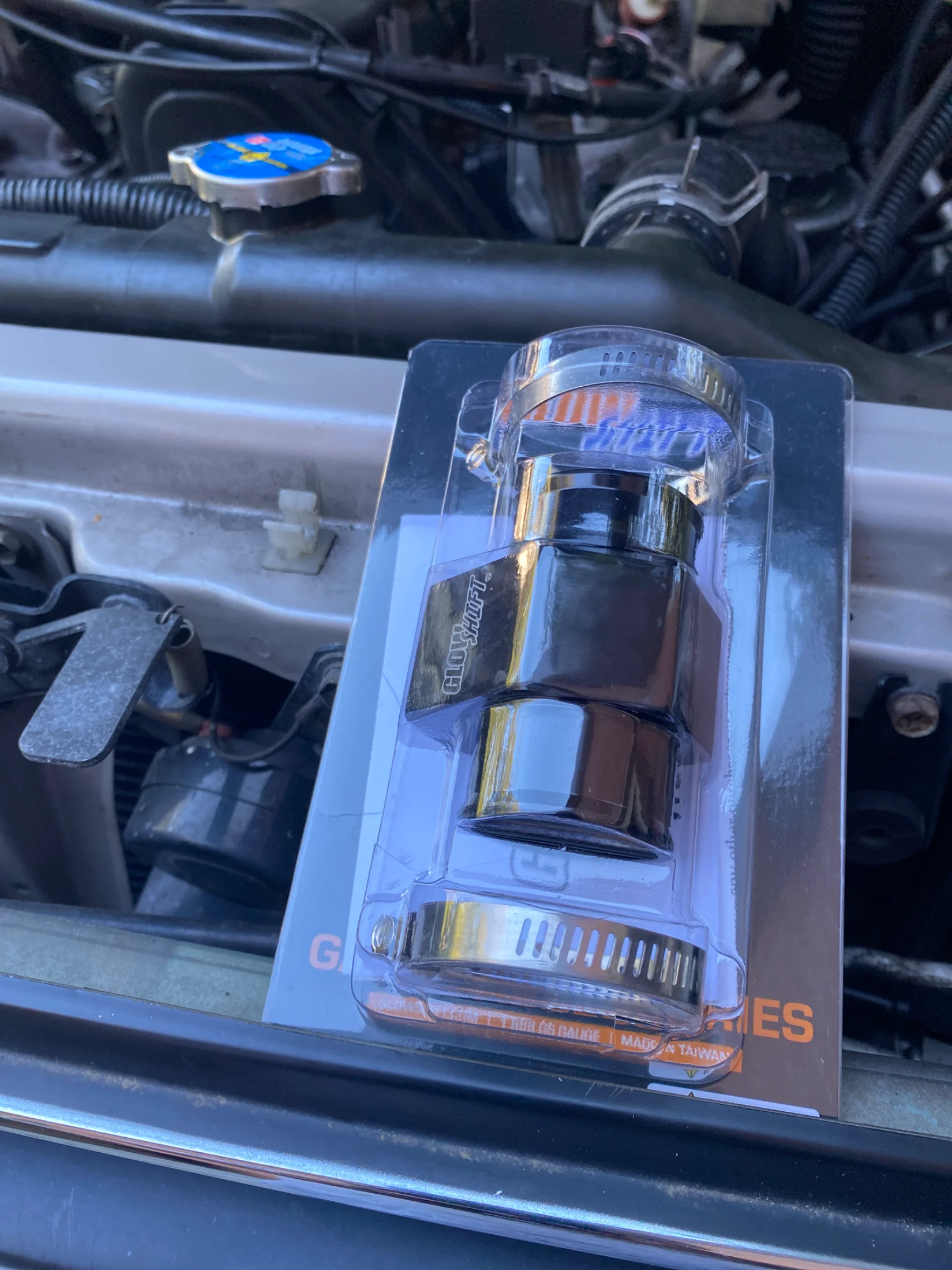

Should I put the temp sensor on the upper or lower radiator hose? Or does it matter?
If I'm remembering right, coolant flows out of the top hose to the radiator, bottom hose is return to the engine. That's where I'd put it, top hose.

Gotcha, I got the Toyota oem 76 deg C thermo. It has the little vent in it. I put that at the top. I put the temp sensor on the bottom hose mainly because that was where I was having issues (bottom hose never got hot). I filled everything back up but I still have the same problem. Top of radiator is hot, bottom is cold. My in dash temp gauge got to normal operating temperature but the new sensor moved 1 degree from 72 to 73.
Bottom radiator hose is after the coolant goes through the radiator and gets cooled down, it may not get warm just sitting there at idle. Is your heater blowing warm air? Heater hoses getting warm? If so, coolant flow is fine.
