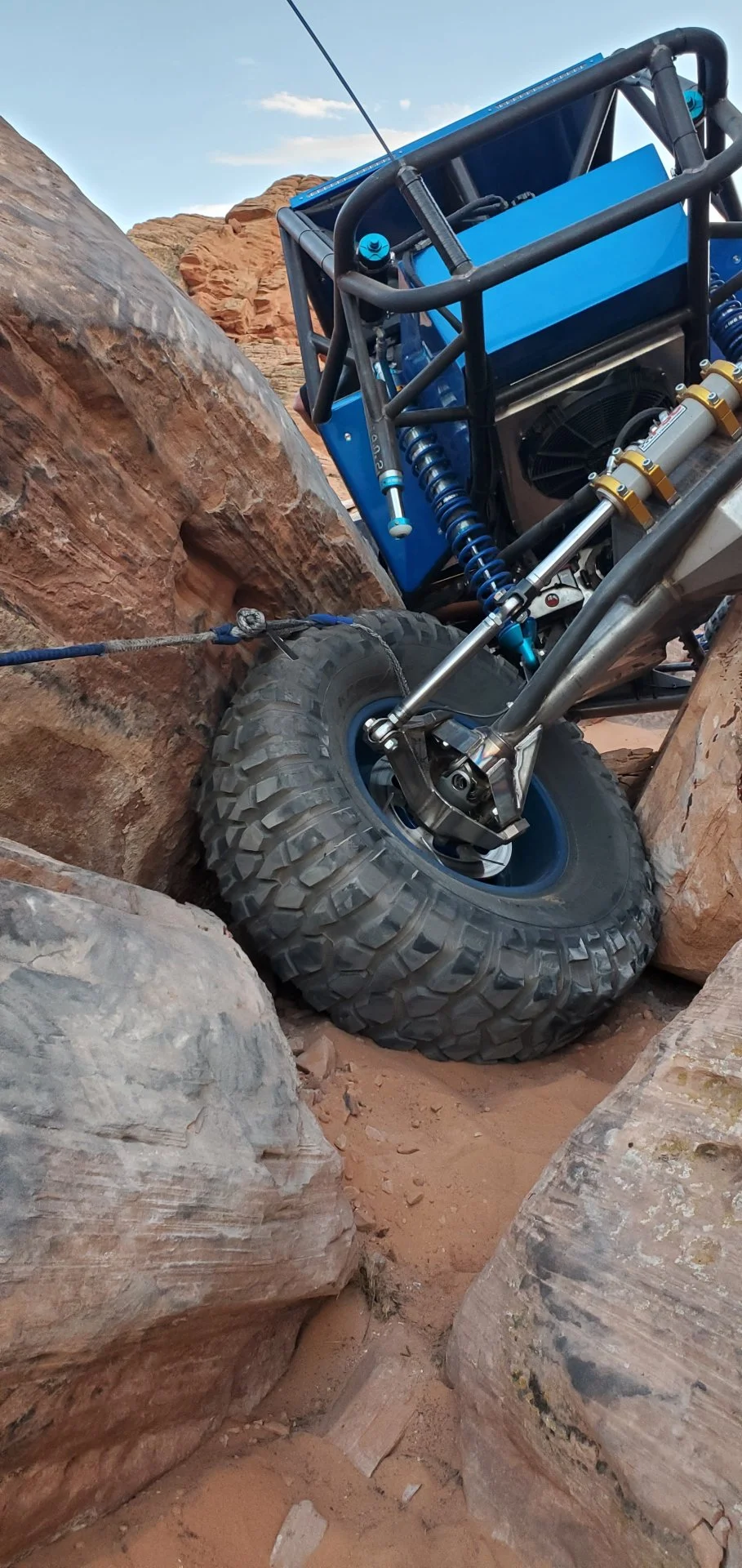

In this pic, I'm using a Raptor Sling from JM Rigging to roll this tire out from the wedge....busted u-joint. Randy actually wheels his new show car ;)
