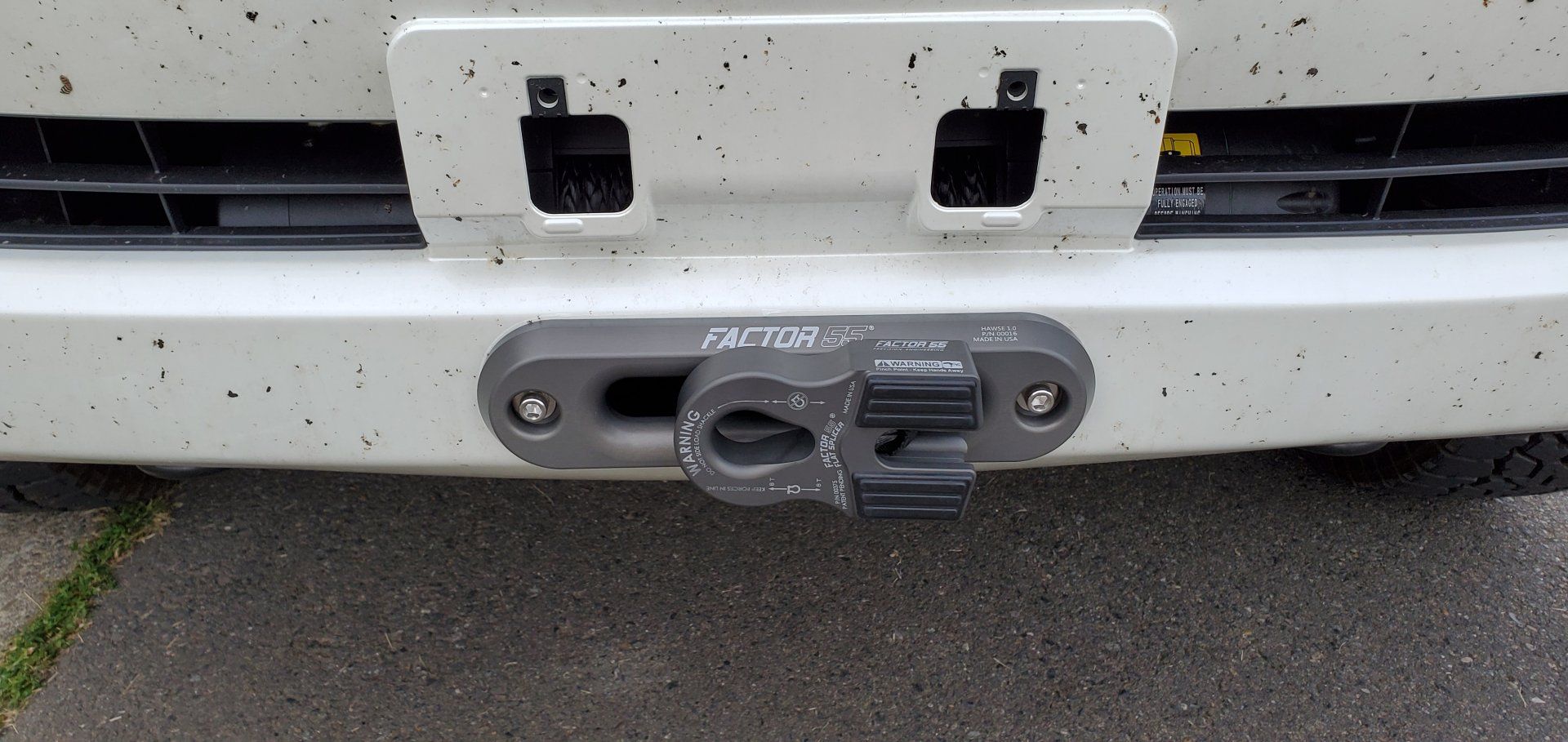

Any pictures of the finish product? Curious where the failead lines up with the stock bumper once its all installed. Cheers!

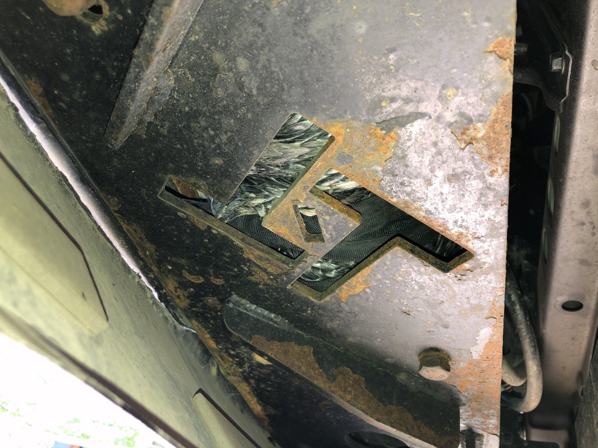

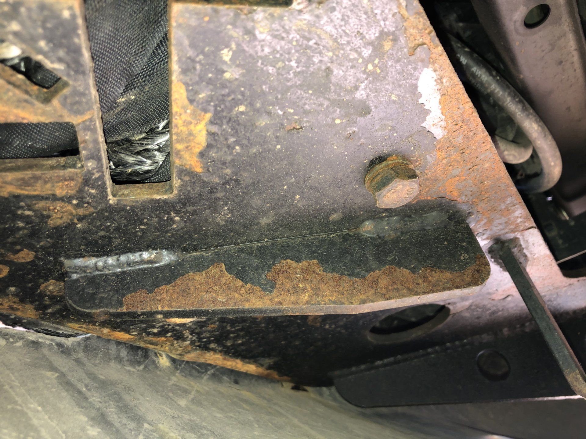

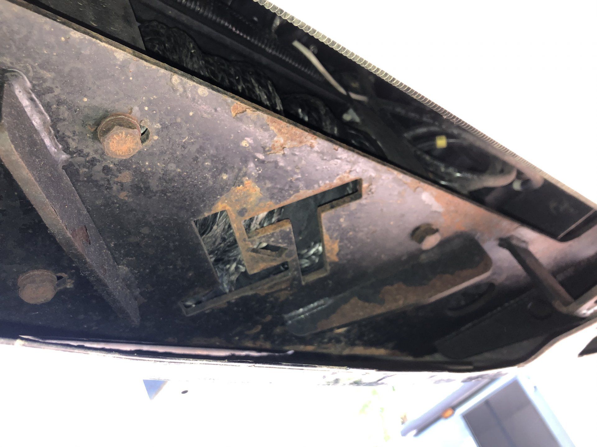

I’m now just over a year since I installed the Trail Tailor hidden winch mount, that I ordered powder coated, and I have to say I’m very disappointed in how it’s holding up.
This winter it will have to come out, and get done over.

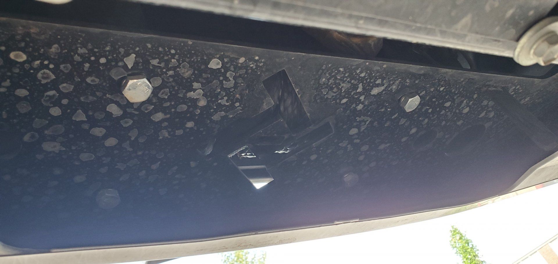

@Drsus this is Its current state of "finished" the fairlead is sandwiching the bumper cover with the winch mount. I still need to finish cut the bumper cover so that it isn't slightly warped, I also haven't yet gotten hardware to bolt the bumper covers lower tabs to the winch mount.
@JetSurfer interesting to see that yours has reinforcing ribs under where the winch mounts as mine does not.

Thank you!
I wanted to see where the fairlead lined up with bumper. seen some pictures of it with funky placement , this is super clean.

I believe Jason subs out the powder coating they didn't do a good job on yours that shouldn't have happened but his winch mount is spot on and well done.

Appreciate the kind words, for reference that's the 1" fairlead from factor 55.

That is totally unacceptable. Have you contacted Trail Tailor? You should have a new one drop shipped to your door for free if that's what it looks like after one year. That's total BS. Please update the board/thread regarding how TT handles this.
