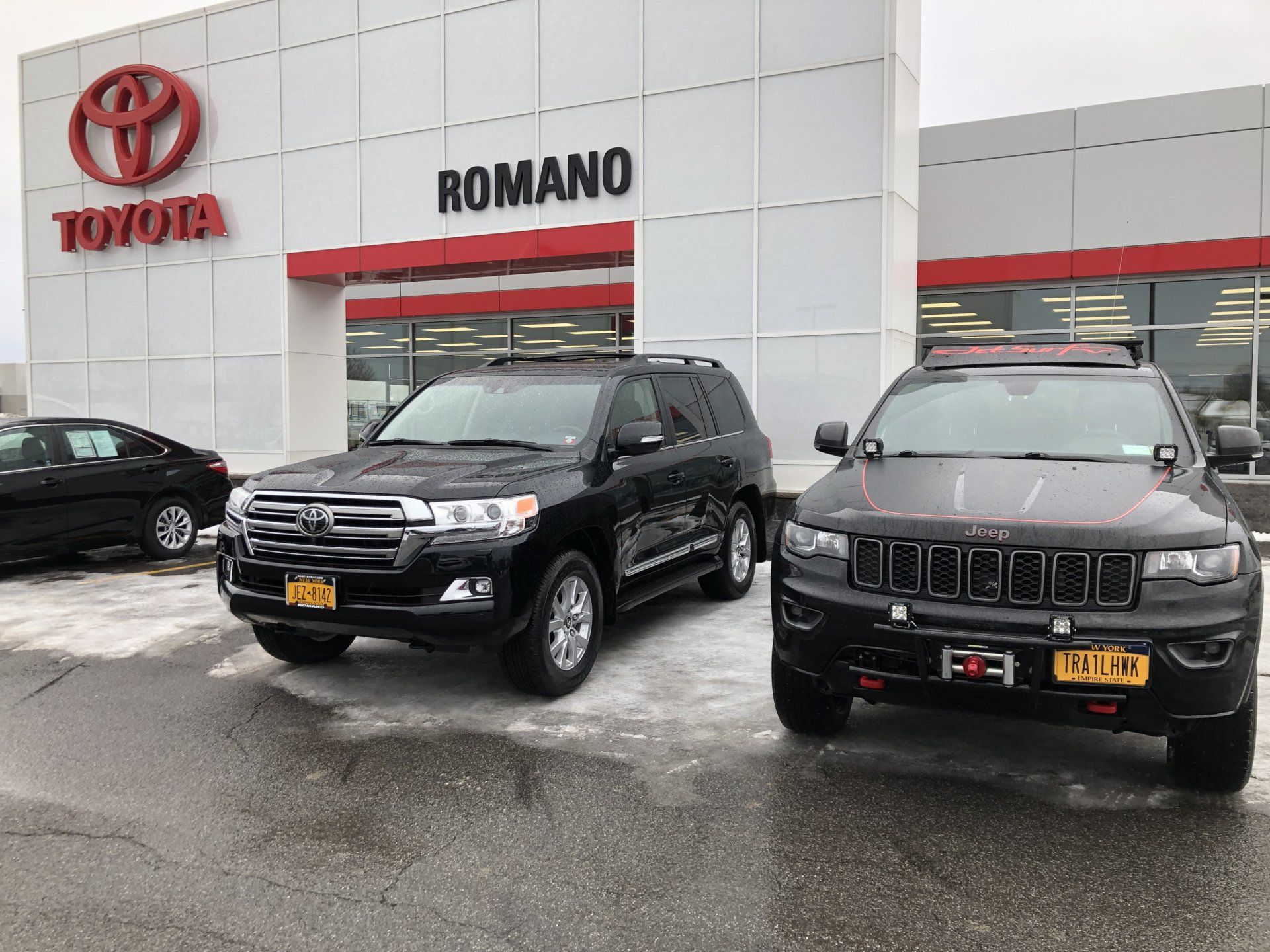

I know this thread is pretty old, but I’m new - just picked up my 2018 200 after years of Grand Cherokees-
I’d like to get a Warn Zeon 12,000 up front but it looks like the ARB bumpers stick out like a foot more than stock?! Is there any lower profile option out in the market?
I’d like a tried and true over a custom job. Last thing is need is being buried up to the sliders and having the winch tear off.
