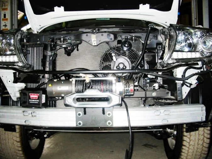

It's definitely possible as evidenced by the existence of a stock winch in foreign markets.
Mounting for most winches in a certain weight class are relatively typical. Like you said, just need bracket, winch, and cutting template with some trim for the stock bumper. There's kits out there for the 4runner for example. Perhaps our market is just too small?

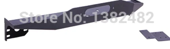

This product does exist elsewhere in the world. AFN in the UK also makes one - AFN Toyota Land Cruiser 200 Series (2013+) Hidden Winch Mount – West Coast Off Road Centre

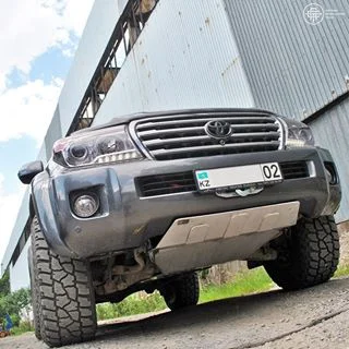

Just searching around, a winch under the stock bumper sure looks good:

Thanks very much. Less than $500 all in, might be worth a flier. It looks like it would at least be a jumping off point for a custom bracket.
