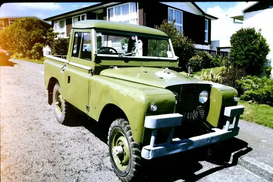

And BTW - All my hub seals are double-lipped (as they were ex-factory) despite the fact that my hubs are designed to contain only grease.
And my experience of oil lubricated wheel bearings on my 1965 series 2A landrover was extremely negative. (Oil getting onto my brake linings was a regular problem and trying to get back to "zero left or right brake-pull" after a river crossing took kilometres of driving with foot-on-the-brake due to the water carrying oil residue from the seal-lip-area onto the linings.
:beer:
PS. Here's the old girl ..... (My first diesel 4x4)
(Hey ... looks like I mislabelled the photo as 1985 instead of 1965 but it's just that I took the photo in 1985. LOL)
